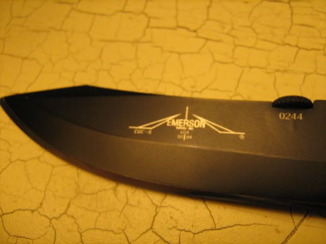

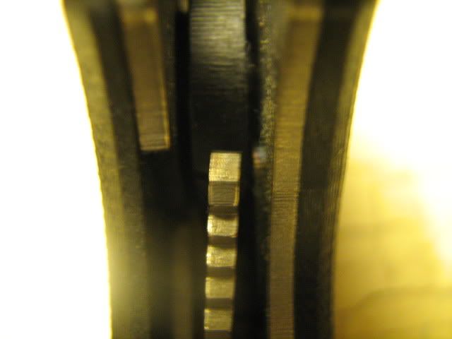

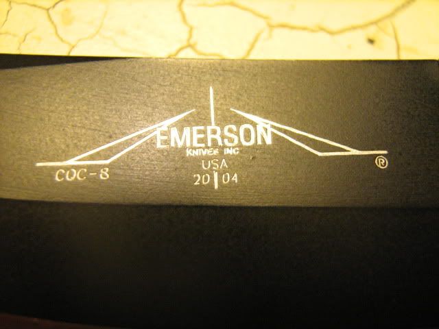

It would only be outrageous if it was not true but unfortunately it is.
My CQC-8 is a last production run of the waveless 8, #244.

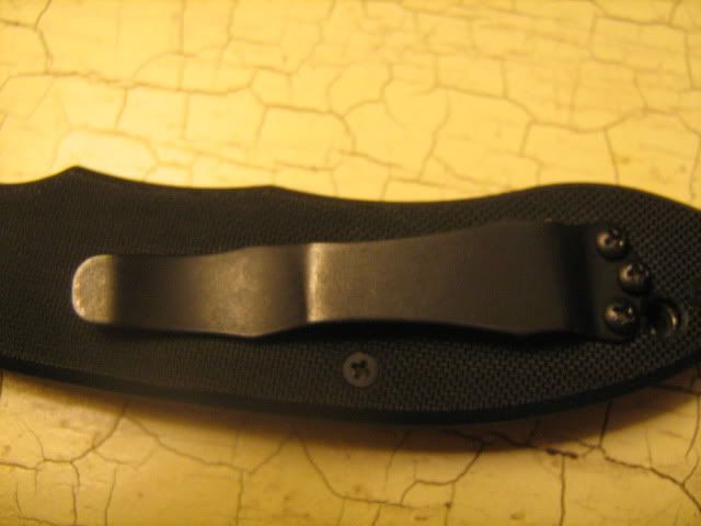

As you can see from the clip it has not been carried since its last service for the same problem.

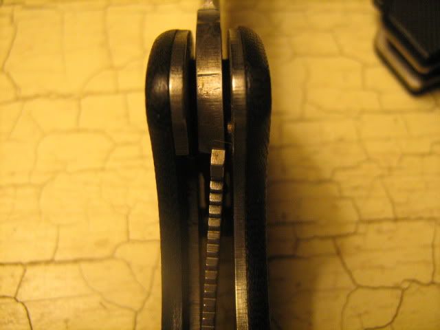

Lock up on the 8 at one time looked like yours.
This is the lock of my commander that after exactly 8 months wore out and now slips if any pressure is applied to the spine.
This is the SECOND time this same problem has happened to both knives and unless I am extremely unlucky I would call this a problem.
Is that ^^^^^^^^ the new Emerson Slipjoint I've been hearing about? :D
I can't believe that they didn't install a slightly larger stop pin to keep the liner from moving over so far without much use. That's a really poor example of their lock engineering.
Both knives had their locks starting in the same place as buffalohumps but as you can see that's no longer the case. I really do love emerson's and my 8 is my pride and joy, yeah they will take care of the problem if I send it in (and might I add that their service is top notch) but to me its ridiculous to send in a knife every year that claims to be #1 in hard use. I don't know if a larger stop pin would do anything as the Ti liner seems to wear like butter.

The reliability of liner locks, like any locking mechanism, is contingent on how the mating surfaces and contact points are scrutinized. This is crucial.
knifenut1013 said that the titanium lock 'wears like butter'.... I wonder if Emerson heat treats the end of the locking liner surface to reduce this wear? Titanium is relatively soft compared to heat-treated steel, but the pictures he posted weren't indicative of accelerated lock wear.... the contact points are out of sync. The lockup is sloppy, period. Something is loose somewhere, whether it's the pivot, the stop pin, or it just could be poor geometry on wear the lock meets the blade tang. Since the knife closes with little-to-moderate pressure on the spine, I'm thinking it's poor mating surface geometry, but it's always hard to tell if you don't have the knife in front of you to inspect.
You could have a .100 thick piece of titanium behind the blade and still have a crappy lockup.
It's not the thickness or perceived robustness of the lock, but in how it's designed.
Negative issues with Emerson liner locks have been scattered throughout the forums over the years. Something is amiss when "THE #1 HARD USE KNIVES IN THE WORLD" come from the factory [a repair none the less!] with the example posted above.
I'm pretty stunned to see those two locks. Especially seeing as how Emersons are designed to be opened with the wave, which is pretty hard on the tolerances. Given that you have a waveless 8, its even more puzzling.
When I called EKI, back in 05, and asked that same question, I was told by Mary Emerson that they did not.
