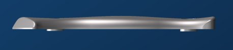

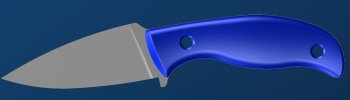

Been working on some grips and kydex for the Mule Team. I wanted something a little different than what's out there.
So I CMM'd a few blades and reverse engineered them. Thankfully SpyderCo has plenty of holes to use for different attachment methods.
In my case I like using 1/4 standoffs and 8-32 screws so that's what I'll do. The big holes are a little over 3/8" in diameter so the 1/4" hardware can be shifted to the center of the grip for a cleaner look. While the big hole locates the grips.
Right now I just have a 3D model and a 3D print both of which look pretty good. The 3D print also seems to work in the OEM kydex pretty well too.
If time permits I'll cut some tooling and G10 grips in couple days .... If that looks good probably take a crack at some kydex. If anyone has interest or feed back let me know. Apologies if this is not the best place to post this.
