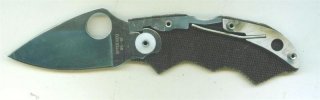

Jay I agree with you. The blade seems a bit rough rolling on that lockbar. Not sure why yet. I'll know more shortly. I went ahead and took a peek inside during my wait on the Ricochet.
I'll have it all apart and separate here in a few minutes and be able to polish that up some on both surfaces. Hopefully that will smooth it out for you.
By the way. Look at this little Navigator lock up. And people wonder why I love Spyderco. I don't mean to down play other company knives in this next statement and won't mention names but a guy doing what I do could easily make a lot of people uncomfortable I think if a knife I work on doesn't look too good and especially if it is that way a lot. Fortunately for Spyderco they stand up to close scrutiny and this little knife is no exception here Jay. No offense meant to competitors but this is more contact than I see on other bigger more famous trusted back lock folders without mentioning any names. This lock bites down in there nicely and is angled precisely correct. In other words they did all the right moves here. Note the slight gap underneath. A little pocket lint won't clog up this knife right away. Always a good thing there also.
Certainly not a bad lock up for such a small gents folder in my humble opinion and it locks up tight too with no play which is always a plus.

Well, Jay I was just toying with you on the orange G10. I do have the Green Canvas ones cut out and drilled. But we may have another problem. In trying to figure out the rough spot you were feeling I got out my big magnifyer and look what I found.
I think I found a fracture on your lock contact on the blade. I've written you an email to ask that you get back with me. You can catch this with your fingernail. I also note a rounded edge on one side of the contact that should be crisp. I can't say for sure but it looks like the kind of thing I see from Spine whacks. Any ideas?
It wasn't until I got the blade out that I noticed this under the scope. From the sides and looking inside I can't really see it but I don't know if its trustworthy or not.
Take a look.
STR
You know Jay. I wrote Sal, and I am currently catching hell from my wife because her take on this is unforgiving. She is probably correct though. She said if I would just wear my damn glasses like I'm supposed to that I would have caught this before voiding your warranty. So, with that said I take responsibility here and I'm ordering you a new Navigator from NewGraham right now. Actually I've already ordered it. It goes out tomorrow. When it gets here you'll have a new blade and I'll do something else with the old one and the left overs.

Well, for this class of knife its actually quite nice. These Navs will never be in the same class as the D4. It seats deeper than it may look in the picture. Imagine being able to take the knife and push down on the bottom to sit it right a bit more since it is slightly angled.
Also, after looking at it I noted the rounded spot on the contact is actually the side showing on the blade in that shot. It sits up better on the opposing side that still sits up crisp and sharp without a rounded off edge. When I get the new one I'll try to remember to post a pic of it.
Here is a big knife about the same class as a Buck 110 compared to a Spyderco Blue 93mm Rescue and look at it in comparison and its not a bad lock up but typical of what I see in a lot of other knives out there.

I am going to go ahead and take the blade out of this one Jay. After using my biggest glass to get a super view of this new one I do not think it is near as flawed as it appeared with the naked eye and my hand held scope. It seems in fact that on this one the mark although in the same spot is nothing but superficial unlike the other one that appears to be a fracture. So, with that said I apologize. Again my eyes fool me. It should be done here before Monday.
It is really weird to me because to my naked eye it looks like a big crack but under the scope you can actually see that this is not the case and that indeed the blade is solid so its a go afterall.
Sorry once again for the false alarm my friend.
STR
Here is a little better angle of the lock up that you will have in the new handles Jay.
This is going to be a rigid little folder I think and very very light weight too. 1.6 ounces in this shot before trimming, and cutting the barrels or adding screws and clip though so it remains to be seen what the final weight will be but its going to be under 2 ounces I can just tell you that now.
