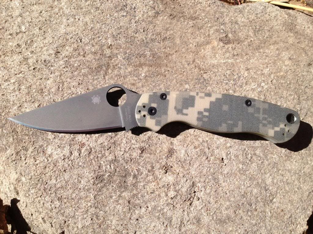

Having been a Benchmade fanboy for almost 15 years, I've recently been branching out and expanding my horizons. After being on the forums for a while, I couldn't deny the impressive following that Spyderco has. I've been rotating a Microtech Ultratech, a Benchmade 3550 and a BM 943.
I began narrowing down which model to get by starting with "looks". This is usually how I always begin my search for a knife, as I won't carry a knife that doesn't visually appeal to me (shallow right?). I wanted an attractive, tough, and unique knife with somewhat decent steel. I don't like lockbacks, and after using the Axis lock for so long, I tend to stay away from liner locks.
This left the Manix series and the Paramilitary 2 (with a few outliers). The lock on the Manix is a bit too much like the Axis, so, Paramilitary 2 it was! $175 later, it was on its way. I know these go for (much) less on occasion, but I am not a patient person.
After USPS delivered the knife two days late (typical), I unboxed what was to be my new EDC. I was immediately impressed with how light the knife is! Most of my Benchmades are aluminum, so this made sense. I was also impressed with how SHARP the knife came. A sharp as it is, there was still a small funky patch of edge proximal to the choil. I'll take care of this when I sharpen the knife.

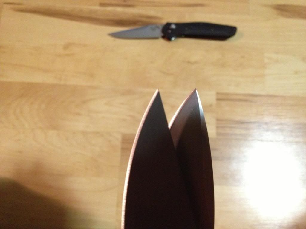

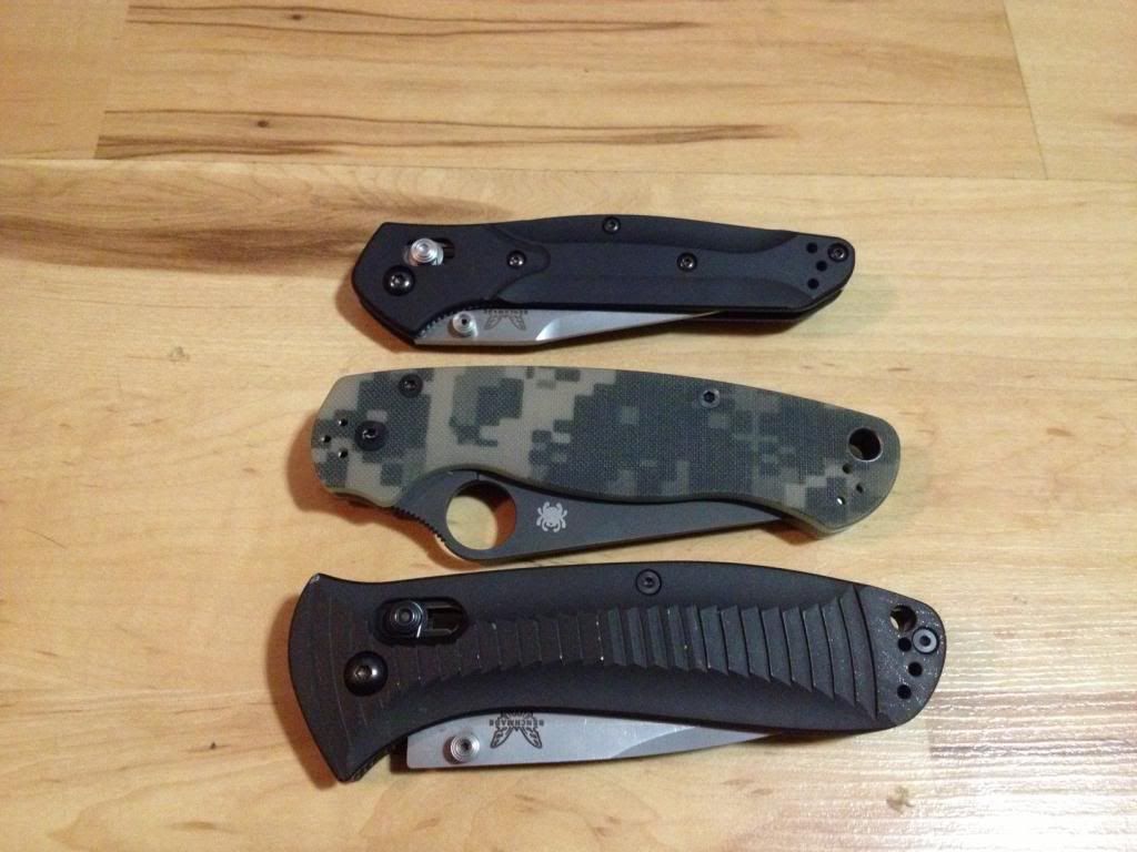

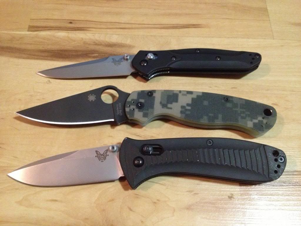

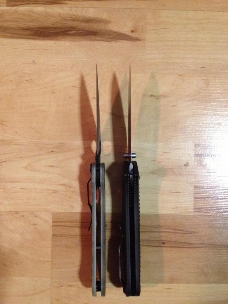

When I saw the specs for the PM2, I noticed it was close to my BM 520. In fact, the two are almost dimensionally identical.
Here is my 943, 520, and PM2 together for scale. It's hard to see, but the PM2 is only .03" longer in OAL than the 520. The blades see only a ~.03" difference in length.
Thickness goes to the 520, but it's also damn-near 2 ounces heavier.
I REALLY like the coating on the PM2. It is about as non-reflective as you can get, and mildly matches some of the digicam.

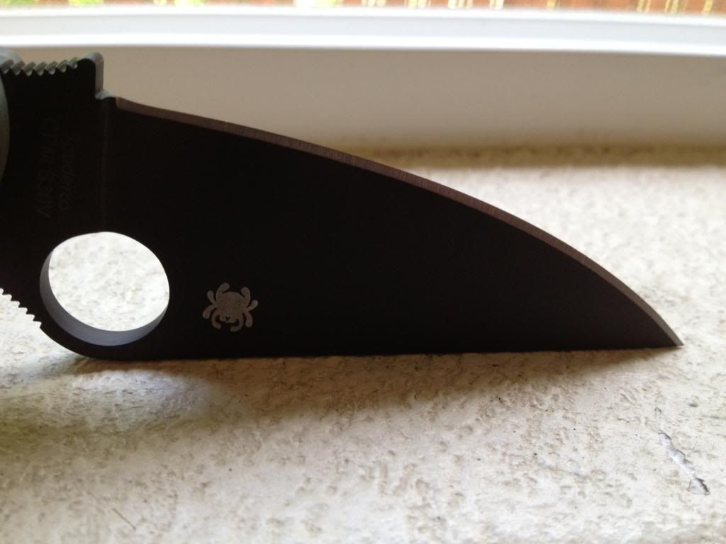

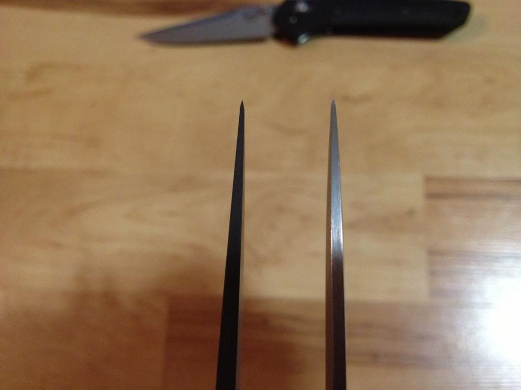

One thing I can see being a potential problem is how thin the tip is. It is one of the "pointiest" knives I've ever had, but I can't see myself stabbing it into wood for fear of breaking the tip.
Compared to the 520's tip:

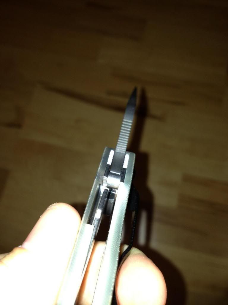

Guts of the compression lock:

The main reason I'm iffy on the knife is the lock. I know it's strong, but the location of the lock is extremely foreign to me. I still maintain that the Axis lock sets the standard for strength, smoothness, and ease of use. The compression lock can definitely be actuated with one hand, but its something I need to get used to. I've never unlocked a folder with my middle finger until now!
How it's done:

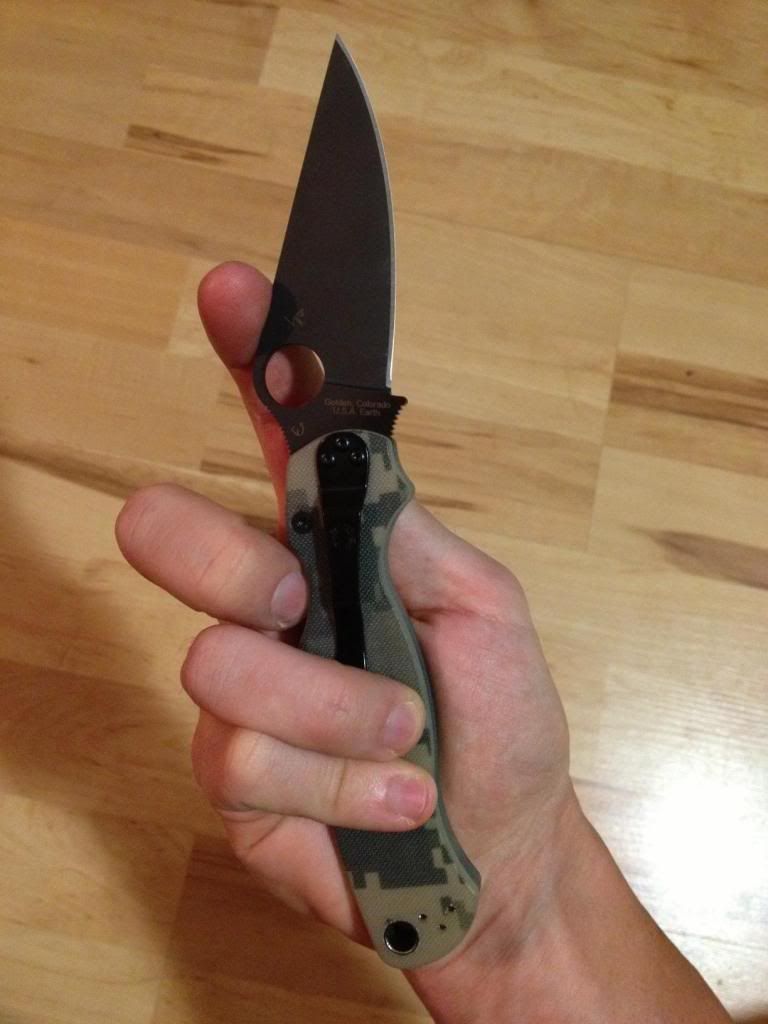

When I'm grasping the knife in a manner to where I can actually depress the lock bar, I really don't feel confident flicking the knife. Plus, the less-than-smooth pivot doesn't allow the blade to close fully under a "normal" flick.

Here's something mundane that I didn't realize: the blade offers an optical illusion. The spine of the blade is FLAT. The complete lack of a flat cutting edge makes the spine of the knife look slightly curved in pictures and somewhat in person.

2. Try using your index finger on the lock, and your thumb on/in the Spyderco hole. Kind of like opening it but backwards to close. Flicking it closed works for me on my PM2. Might just need to break in the detent/coating (until it wears a path).

After a full day of "use" the action has gotten MUCH smoother! I can flip it closed now without too much hassle. I tried the reverse opening, but I don't think my hands are large/strong enough to actuate the lock and still have a thumb that's dexterous enough to close the blade. I also made the decision to go tip-up with the clip. When I close the knife, its position in my hand is perfect for this modality. Deploying the knife from my pocket sees less fumbling this way too.

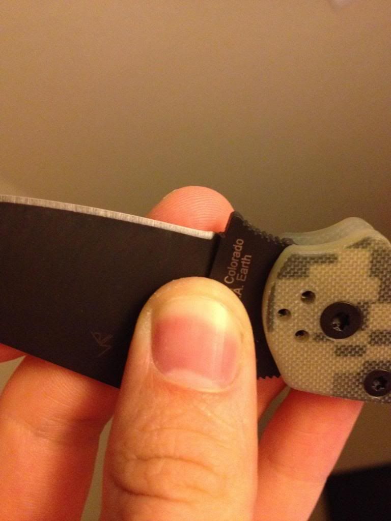

The funky grind looks almost like whatever they use to sharpen the bevel (belt?) bit in a bit too much for half an inch before reaching the choil. I assume it's because the blade has no flat spot, and the sharpener slightly misjudged where the belly of the blade was going to contact the choil. There is a slight upsweep right at the choil, and the edge leading up to it looks like its been stropped. Hard to explain, but easily seen in person :)
The picture shows the slight downward curvature, and subsequent curve up to the choil. I know there is a technical term for the area where the blade meets the choil... Anyone know it?

yeah, that is generally because the blade shape doesn't have a sharpening choil (i.e. a 1-3 mm lost of cutting edge). It's fairly easy to fix yourself, but not with a belt sander. Try first with sandpaper around a very thin metal skewer and gently work it down. then thin the edge after evening out the bevel vertically (or convex it ;)).
