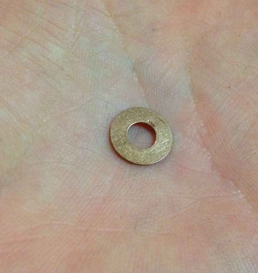

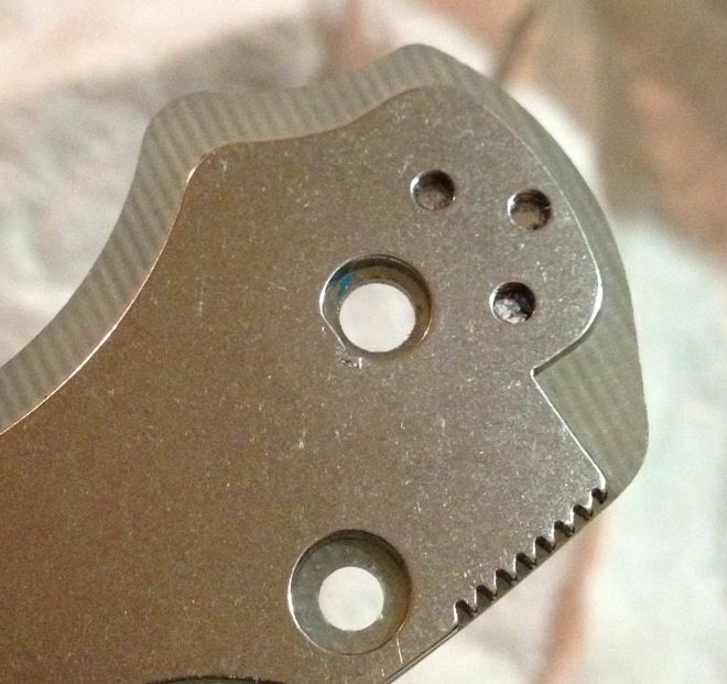

I tore the knife down to clean the pivot and better understand the construction of the knife. Once apart, I saw something I wouldn't expect... A burr on the liner where the bushing sits!
I looked at the bushing and the burr had marred it.
I excuse things like this on mass-produced items. It was easily fixable, but i would have rather not had to do it! I took my sharpening stones to the liner to smooth out the burr and made it flat. I smoothed out the bushing as well, and put the knife back together. Fun fact: Getting the pivot tension set is no treat. Why Spyderco chose to use two screws to set tension is beyond me. I'll ask the Spyderco forum if there are any tricks to getting it smooth, but not blade-play loose.
The Spyderco forum solved the mystery for me.
Turns out, the blade stop pin screws ALSO determine blade tightness. I Peter North'd Loctite all over the screws, set all 4 (!) correctly, and now the blade falls under its own weight. I feel like this could have been easier if Spyderco had just added .001" to the width of the stop pin and pivot barrel... But I'm not a knife manufacturer :D
I think the stop pin used to be longer. You used to be able to torque down the stop pin, then adjust your pivot. I'm not sure why they changed it.

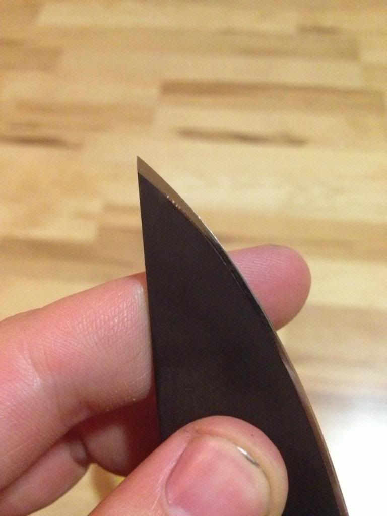

Update:
I've been using the hell out of this knife! It's not much of a chopper, but I have been using it quite hard. I was mowing with the tractor yesterday and the long hay gummed up the PTO, releasing the attachment and blowing a U-joint. I ended up having to cut through 12-20 inches of densely wrapped grass/hay to reach the parts. The knife ended up striking the cast iron parts a few times, chipping the edge slightly. 5 minutes hitting the microbevel and it was ready to rock again.
I recently decided to make a denim micarta handle for a Mule Team knife. I diced a pair of jeans into 3"x7" rectangles against an MDF cutting board. After the entire job was done, the edge showed chipping and rolling. More microbevel work and it's fresh again.
Denim did this
