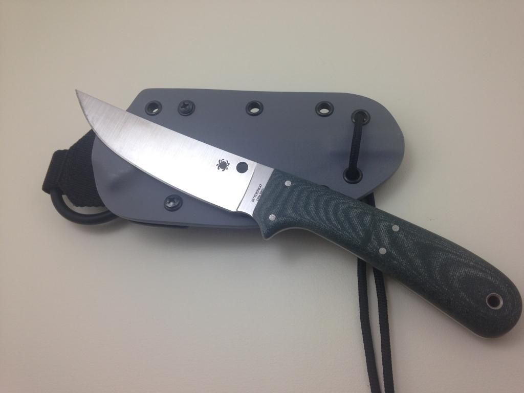

Ok, I've had a few weeks with the Phil Wilson Southfork now and I wanted to share some of my thoughts, observations and initial opinions about the knife. Normally I will post my initial thoughts on a folder within a few days of receiving it but I felt obliged to put the Southfork through more real world use before sharing any impressions. Folding knives, by nature, are more intriguing to me than fixed blades so it is easier for me to have a favorable (or not) impression within the first day or two. This impression is based on a lot of things other than how the knife actually performs as a cutting instrument. With a fixed blade, I don't get that same level of fascination with the mechanics of the knife so I need to feel like it is doing something extraordinary in actual use in order to pique my interest. So here we are and after three weeks of use I would say that my interest is sufficiently piqued.

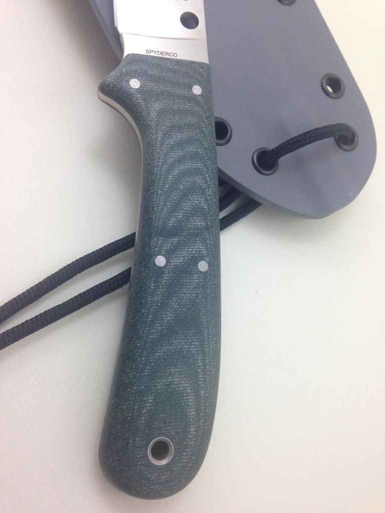

HANDLE AND ERGONOMICS:
A++ About as good as it gets IMHO. Handle is perfect size for my hand. Works great in multiple grips. The edge is always exactly where you want it to be when gripping the knife naturally. Choil is great and I wouldn't mind if it was a tad deeper to more safely "seat" the index finger in a forward grip. If there were anything I would change it would be the finish on the handle...it can be a bit slick when covered in blood. I will probably rough sand mine a bit to give it some extra grip but this is something that might bear consideration on a knife that's designed as an all around fish&game cleaning knife.

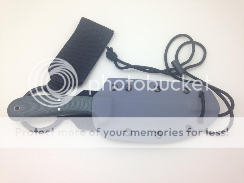

SHEATH:
Great sheath. Good fit and retention. As others have suggested, some sort of thumb ramp would be helpful for one handed removal since the retention is pretty strong. The sheath should also have drain holes IMO. I went ahead and drilled a few of my own. G-clip is strong and very adjustable.

Overall, I am extremely pleased with this knife. It is obvious that a lot of thought went into the design and that it was a purpose driven design. It still doesn't have the same "fondlability" (like my made up word? ;)) as a high end folder but like many spydercos it's beauty lies in its functionality. The more I use this knife, the more I like it. It has also taught me to leave my coarse edges alone. On my folders I'm always tempted to "over-refine" my edges but the coarse edge just works so damn well on this knife and steel that it's easy to leave it alone. I would highly recommend this knife to anyone looking for an all around fish and game cleaning knife or a good medium sized kitchen knife in a great steel.

Couple of thoughts, my original sheath was terrible out of the gate. Retention was fine as far as the knife accidentally coming out unexpectedly but the knife rattled like crazy, I could grip the handle and pivot it side to side about a 1/2". Easily remedied, I made a new one, my kydex, Mashed Cat dangler setup.
Also my take on the handle was very similar to yours, I media blasted mine a while back after giving the knife plenty of use as it came originally to figure the pros and cons for my uses. Handle grip was acceptable to me stock, especially with the guard the way it is, I also just felt grip could be improved upon slightly.
