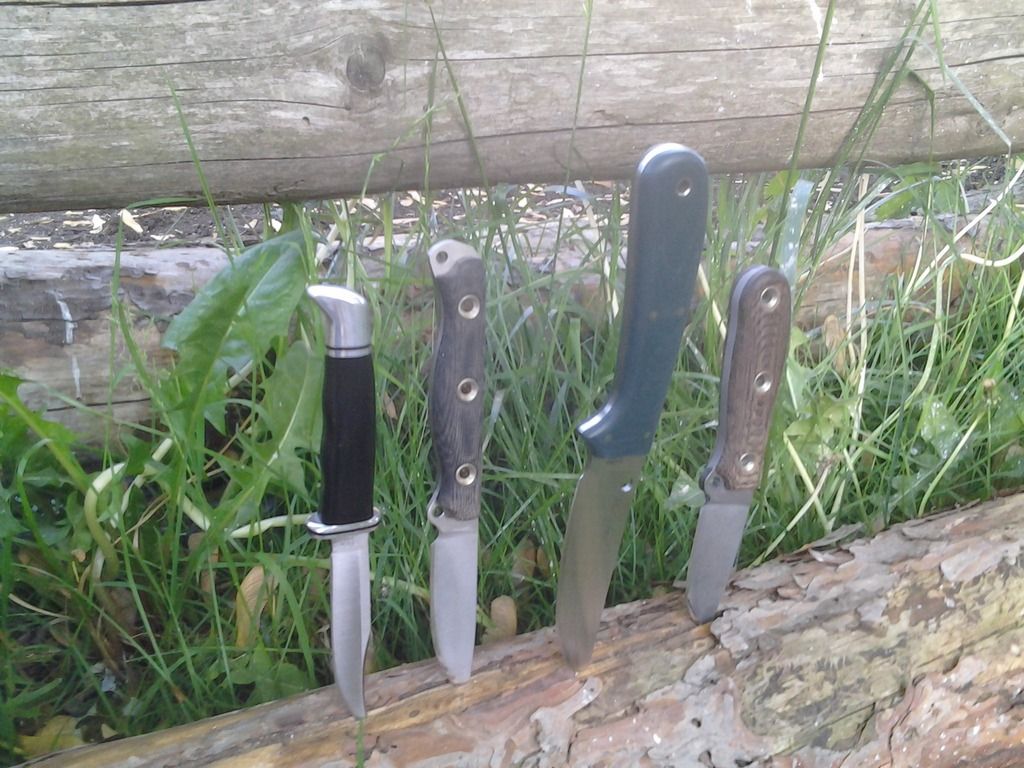

Mine arrived today hopefully pics up tonight. So far so good have questions for you all. But will address them in the pics. The edge is toothy but from what I have read is what I want on this knife. It cuts very aggressively, as said. So far only veggies but more cutting is in it's immediate future.
Congrats lobo. Between the fish cleaning table and kitchen duty, the SF remains one of my most used (and loved) knives. Hope you get lots of use and enjoyment out of it.
Still no pics sorry.... but I touched the blade up today on my smiths diamond hone fine grit... pleasantly surprised how easy it was to clean up the factory edge maybe 30 passes aside and I was babing it to as its still new.
first photo op...
few friends...
