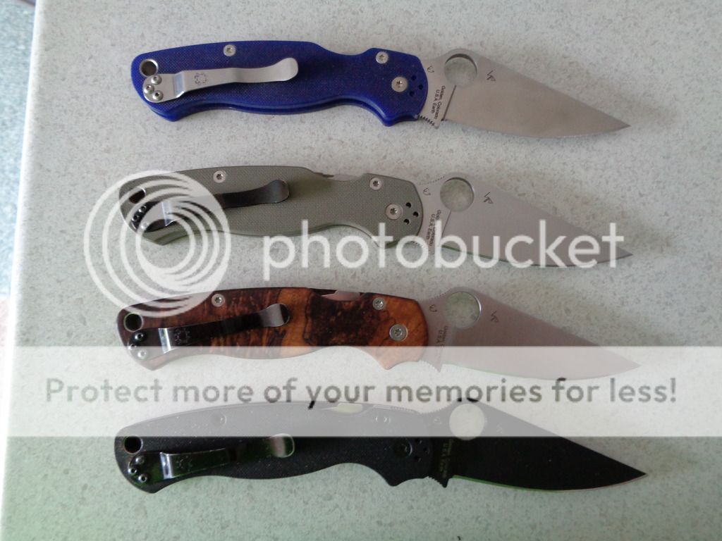

Mine arrived, maybe first in the antipodes?
I'm happy with it and it's gonna be in the right front pocket for the next few weeks.
Blade: S110V, the reason I bought it. My first S110V blade, I have 3 other folders in S90V and I'm expecting more or less the same kind of edge retention but am curious to find out how similar sharpening difficulty is.

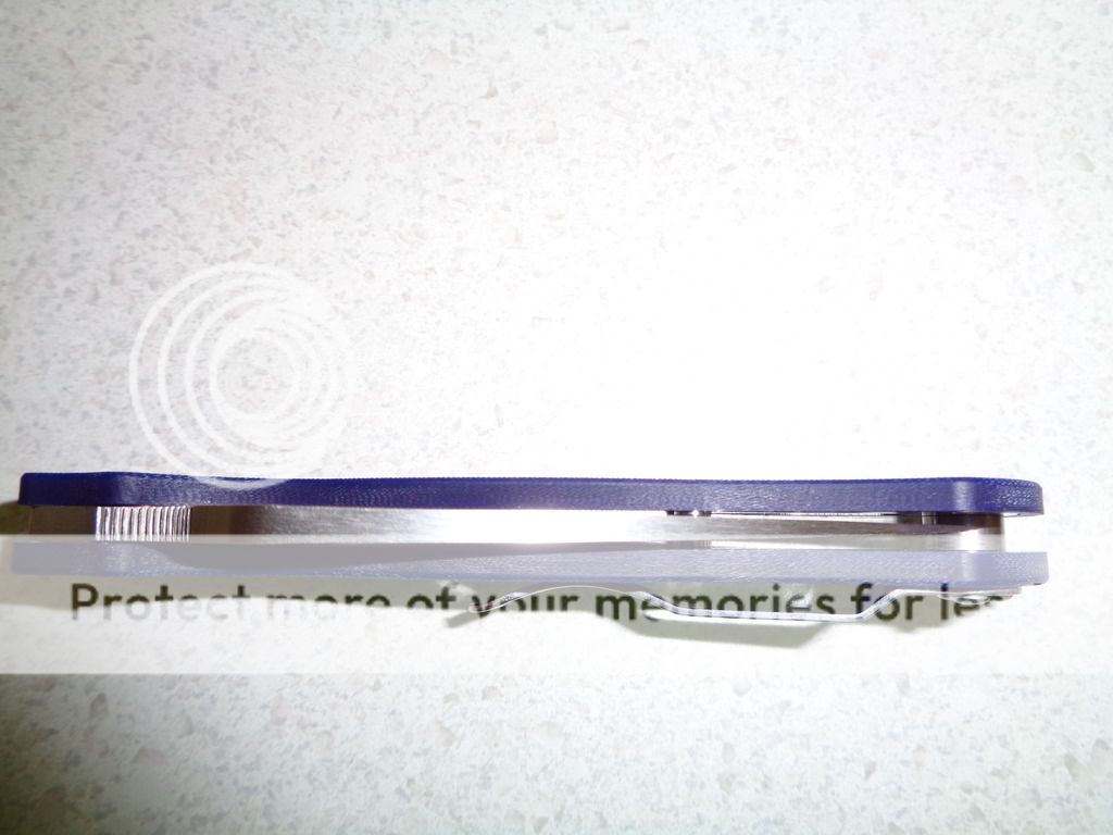

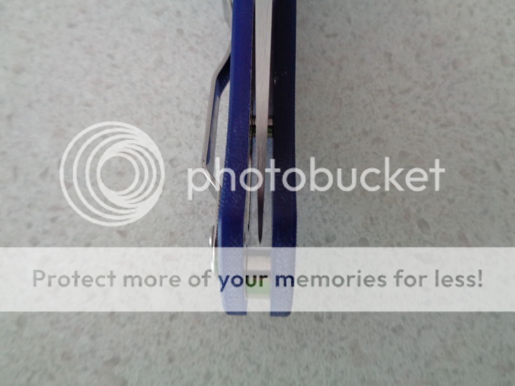

Lock up is solid, really good, absolutely no blade play at all. The blade does not swing freely, its smooth enough though a little stiff to open/close. I will use it for a while before adjusting the pivot. By comparison my Elmax Para2 was nigh on perfect out of the box, solid lock up and the blade just drops and swings freely when the lock is pressed.
The grind on this S110V Para 2 is even and it's very sharp. Hard to see in the (poor) pics but the blade centering is just very slightly off. No biggy.
Scales: Color is subjective of course. This royal blue, I'm not loving it, not hating it, but it lacks the industrial or utilitarian or subtly artful look to it that i prefer in a knife handle. I'd have preferred a really dark Navy Blue myself. G10 grippiness is good like my other Para 2's. The edges of the G10 are not quite as nice and smooth as my Elmax version, but only slightly so.
It will get a black clip soon. Wouldn't mind finding black screws for the scales and pivot too.
This one appears as navy, unless seen in daylight or bright light. I heat colored the hardware.

Love those PM2s, I also have the Elmax version and I love it.
That looks nice. May I ask how you heat colored the hardware? Just by waving a flame over it? I may have a go at that.
It was easy & simple. I didn't use a torch, (although I suppose that would work as well). The heat source was an electric stovetop, the heating element turns cherry red. I placed the parts on top, fired it up and watched the color turn. Removed them with a needle nose pliers when they looked good, and then quenched.

Thanks for explaining how you did that. Did you quench with water or oil?
I much prefer black screws on black scales too, black or dark hardware generally on most folders.
But I agree, what you've done looks a better match to the royal blue than straight black hardware would.
The wood scales I got from Cuscadi in Germany a couple of years ago for my S35VN Para2. I dealt by email with a guy called Luke who's English was excellent. He sent me pics of wood to pick from, I chose and described to him what I wanted, and he delivered beautifully made scales just like I asked for.
I was careful fitting them, very aware that I was handling a wafer of wood. I put the lanyard tube in the freezer for a while before assembling to make the ends slip into the wood easier. Once assembled it doesn't feel delicate at all.
In hand it feels lovely (I'm partial to the look and feel of wood), though of course it doesn't grip the pocket like the G10. Still it feels secure enough. It gets carried and used, albeit with some care. My 'going out' Para2.
And yeah I think your right, the heat colored hardware would look awesome on it.
