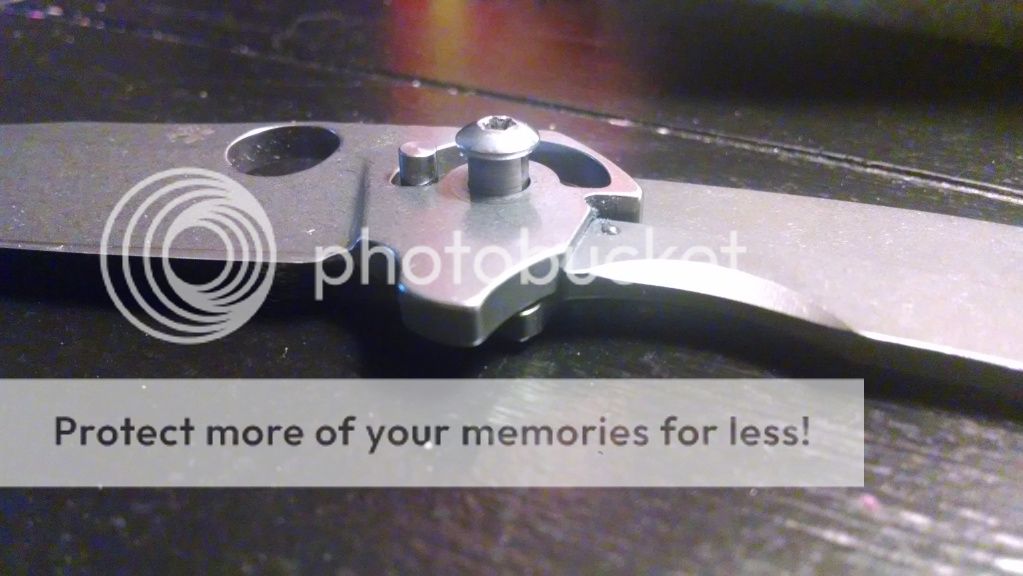

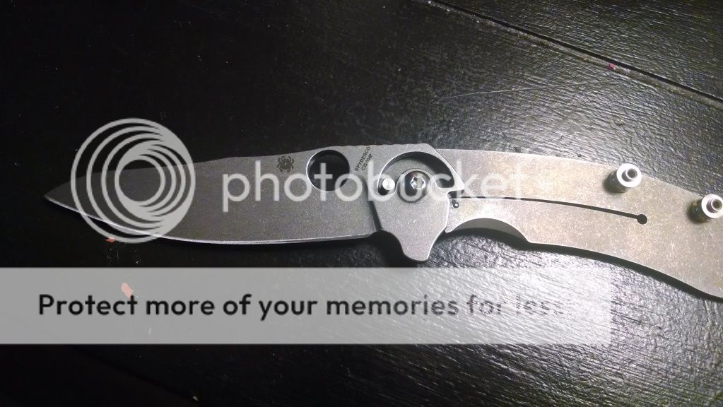

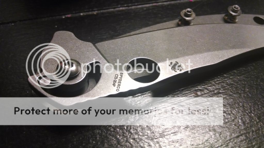

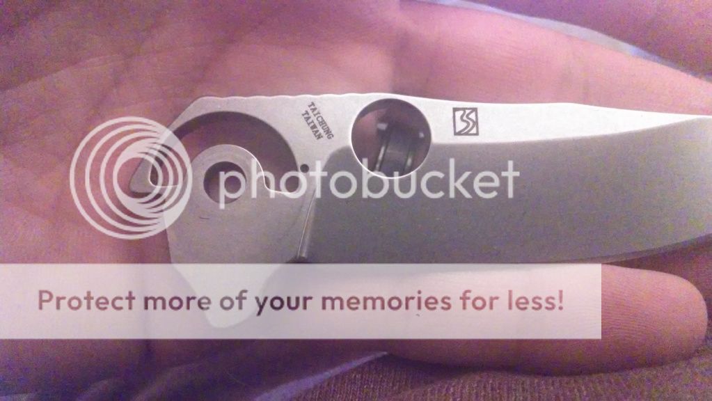

Here are some photos I just took of mine. The initial pics of the broken blade did look alarmingly odd but after taking it apart it makes a little more sense. The stop pin is only in contact with the weakest point when the blade is closed. (pic 4) Exactly why the OP's broke I'm unsure of...

The snapped blades I have seen show dull gray and rough at both sides of the fracture, just like the OP's Southard. I had no idea how much metal is gone near the pivot on those to accommodate the internal stop pin. It looks weak, major stress risers at the ends of that arced slot.
Nice pics fetzer.
