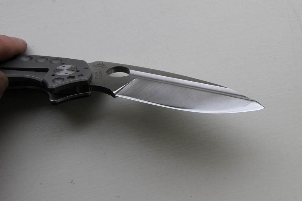

Although the factory edge was satisfactory in use, when I came to sharpen it, I found the blade was so thick behind the edge near the tip that the 40deg stones on the Sharpmaker weren't even hitting the edge. I have fixed blades in CPM-3V and I knew that a folder didn't need that thickness in my hands. Accordingly, I carefully thinned the blade and reprofiled the edge. Initially a pure convex edge, later a 40deg microbevel:

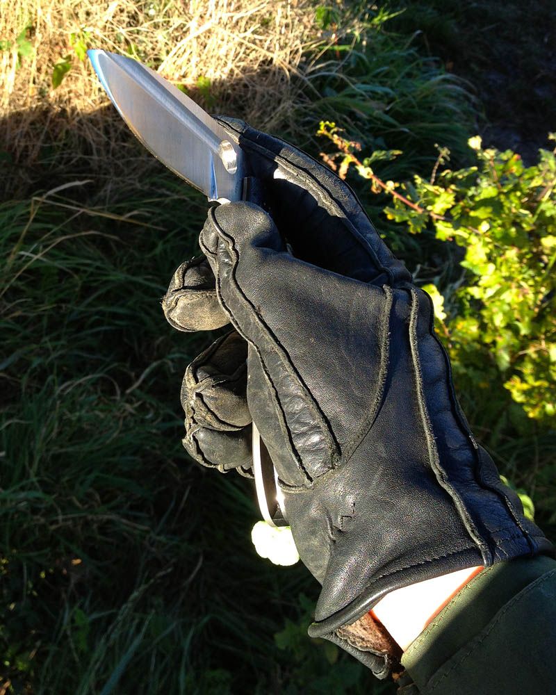

Much has been said about the stiffness of the lock and the sharpness of the spydie hole. Personally, neither of these bothered me. I found the knife was OK to deploy and close, both with and without gloves:

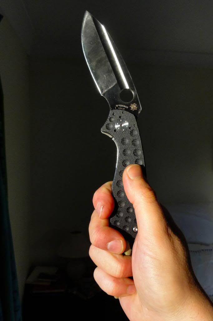

Ergonomics:

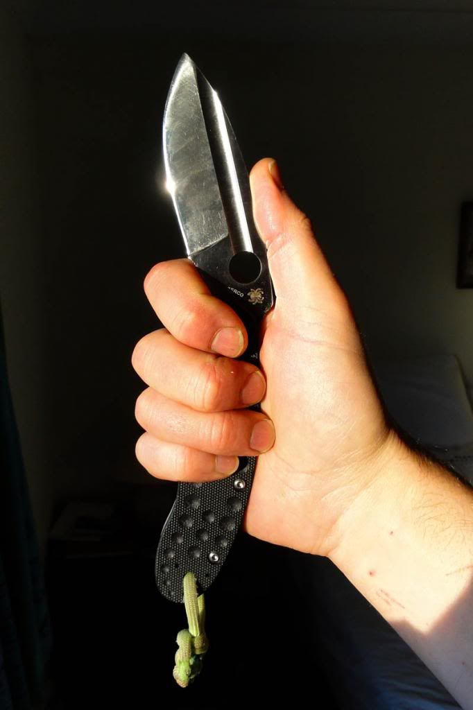

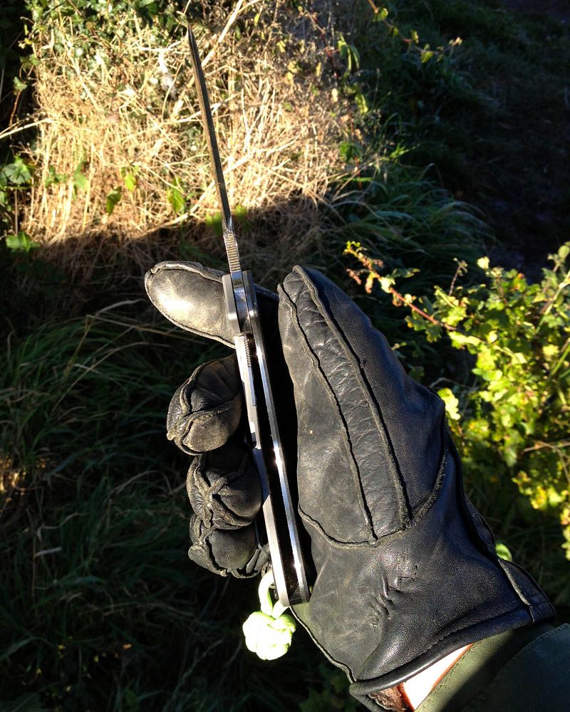

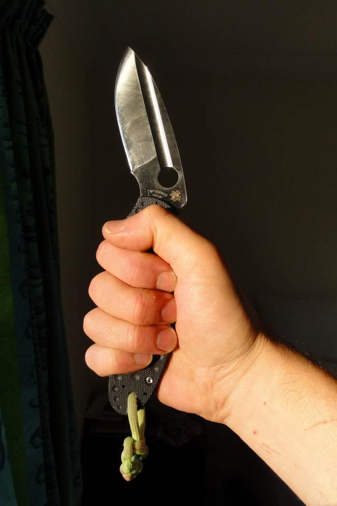

Some users have found the offset between the choil and thumb-ramp uncomfortable. I find the knife lends itself to three primary grips (so long as a suitable lanyard knot is used...)
Forward grip: the choil works best with a thumb on the spine of the blade, rather than the thumb ramp:
Power grip: the thumb ramp is actually better positioned for this grip, if you want some extra feel or control in a power grip:

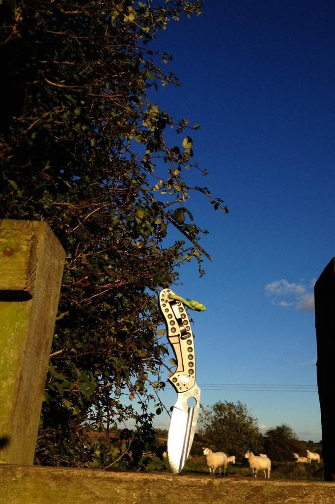

Reach grip: I have a chunky lanyard knot which facilitates this grip, which I use with caution for lopping soft/green vegetation (brambles etc.) at full stretch:

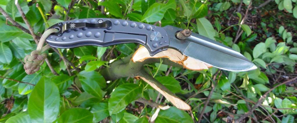

So, during the summer and autumn months, the knife has been used primarily on foliage related tasks:
Clearing overgrown styles:

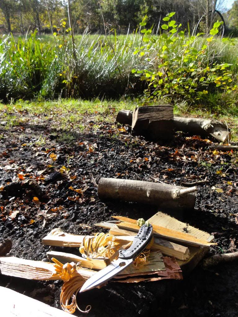

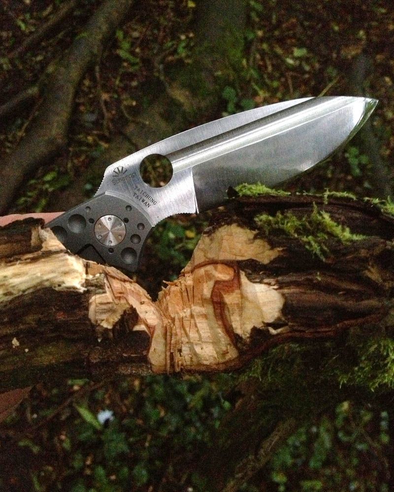

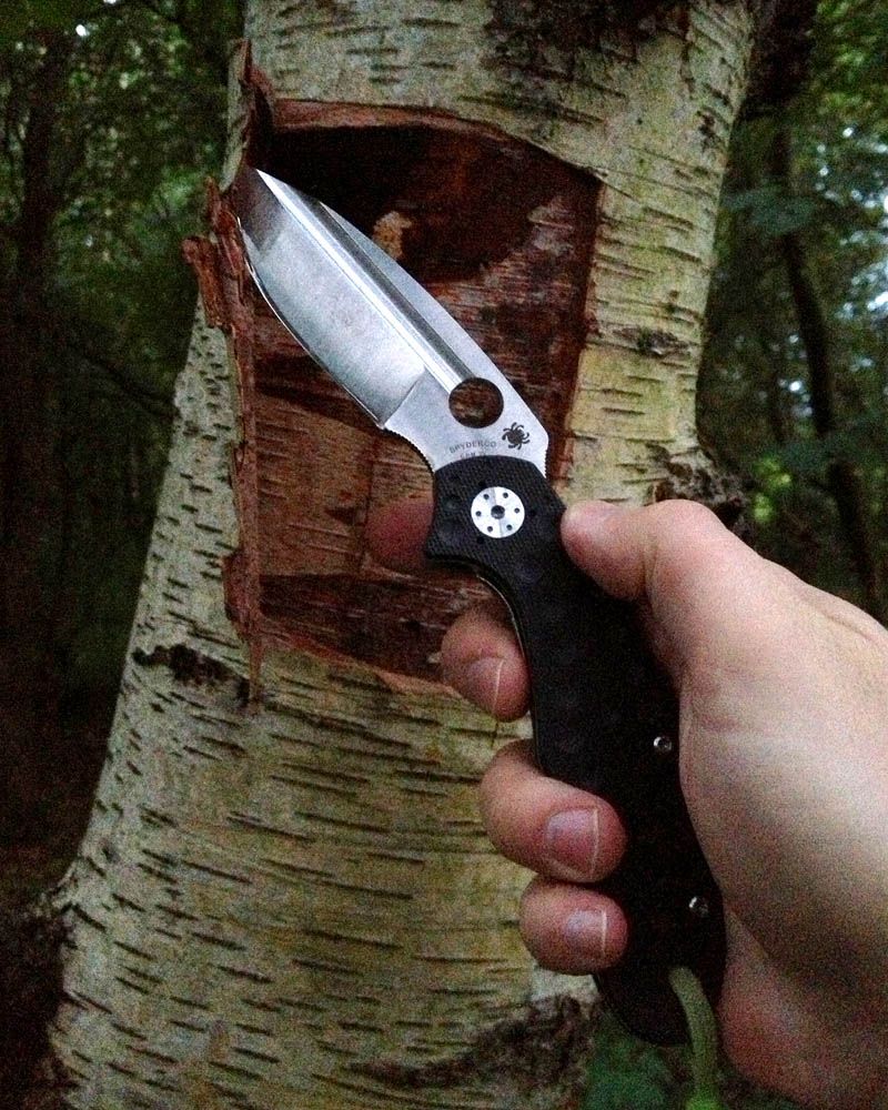

The odd bushcrafty task:
This is at the thickest end of the spectrum of media cut:
More typical substrate:

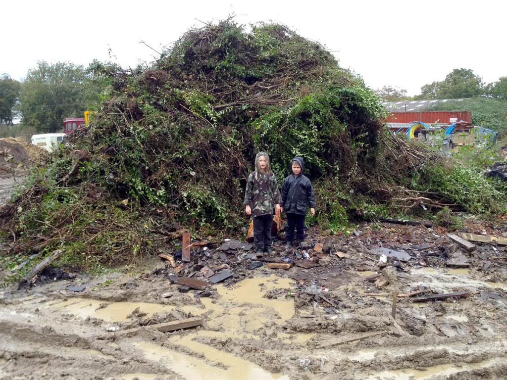

One tough test was 2 days solid hacking, clearing the garden and land of a house that was somewhat neglected; This is the spoil!
Young and old were pressed into service:

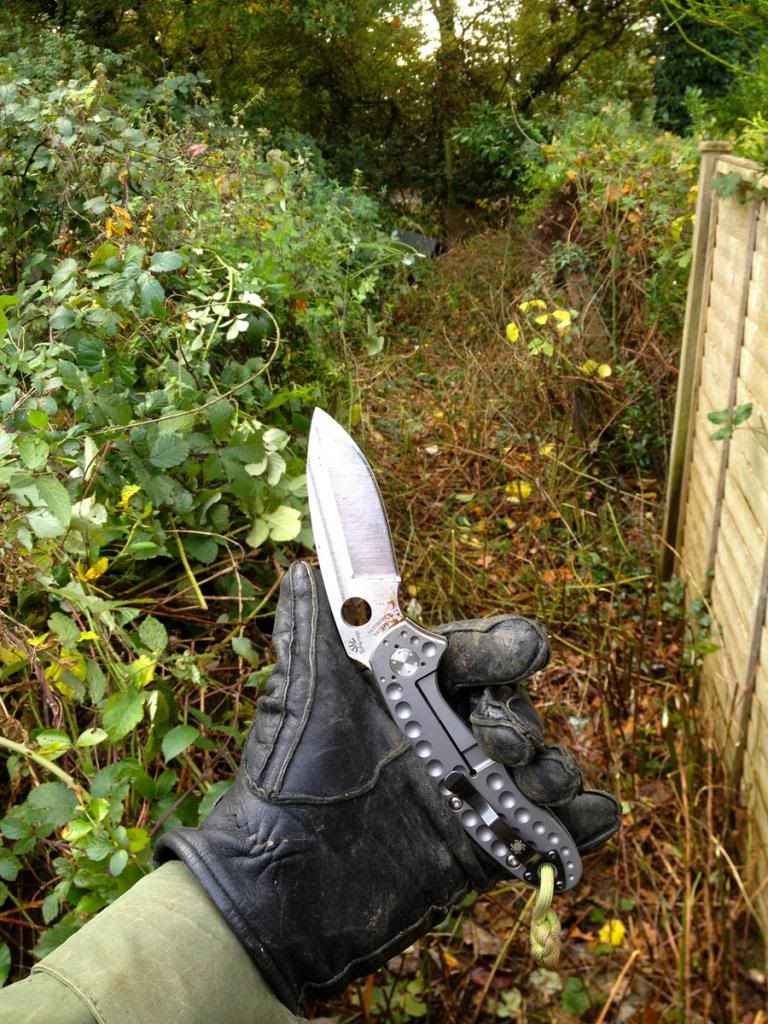

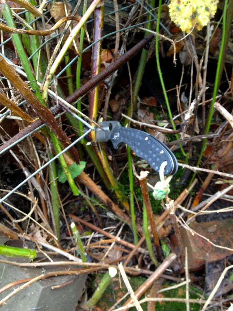

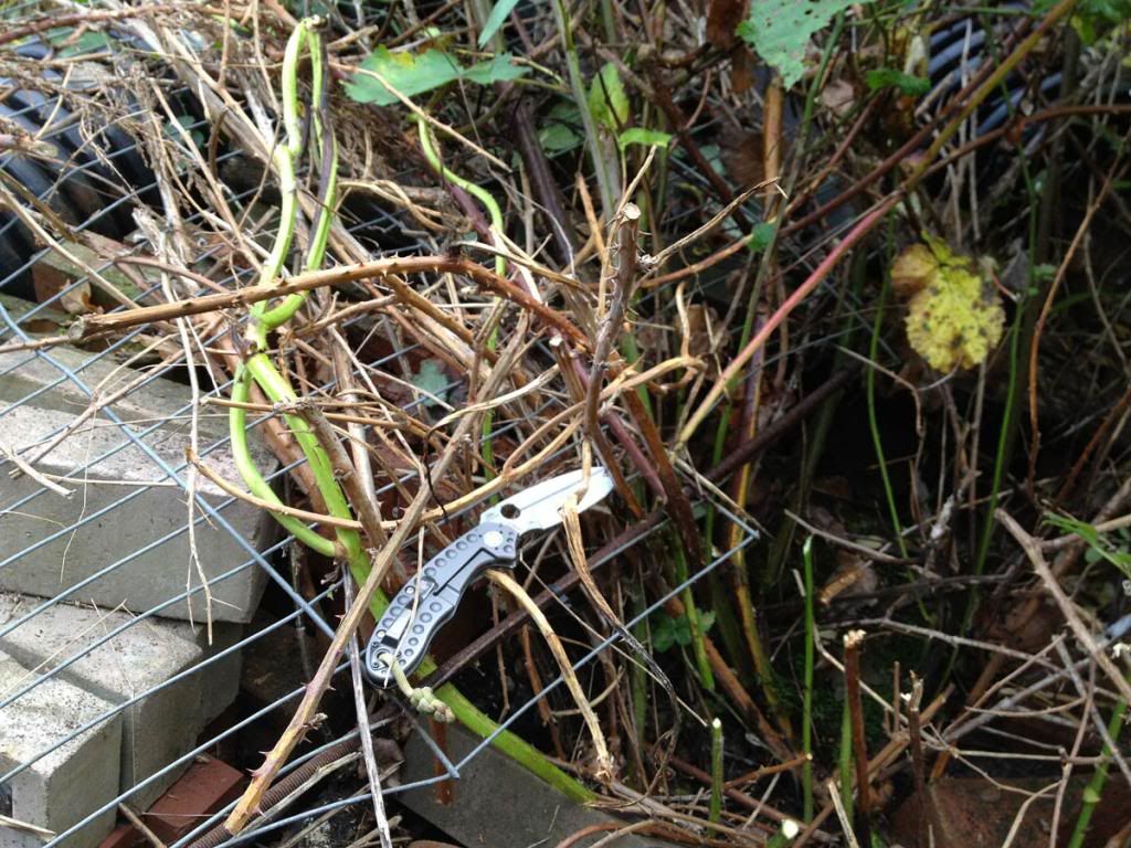

The stiffest test was hacking through an enormous patch of brambles that had grown up from bricks and through discarded metal grilles:
Cut a path to get into the brambles:
Then set to work at the base of the stems, trying to avoid the bricks and metal grilles:

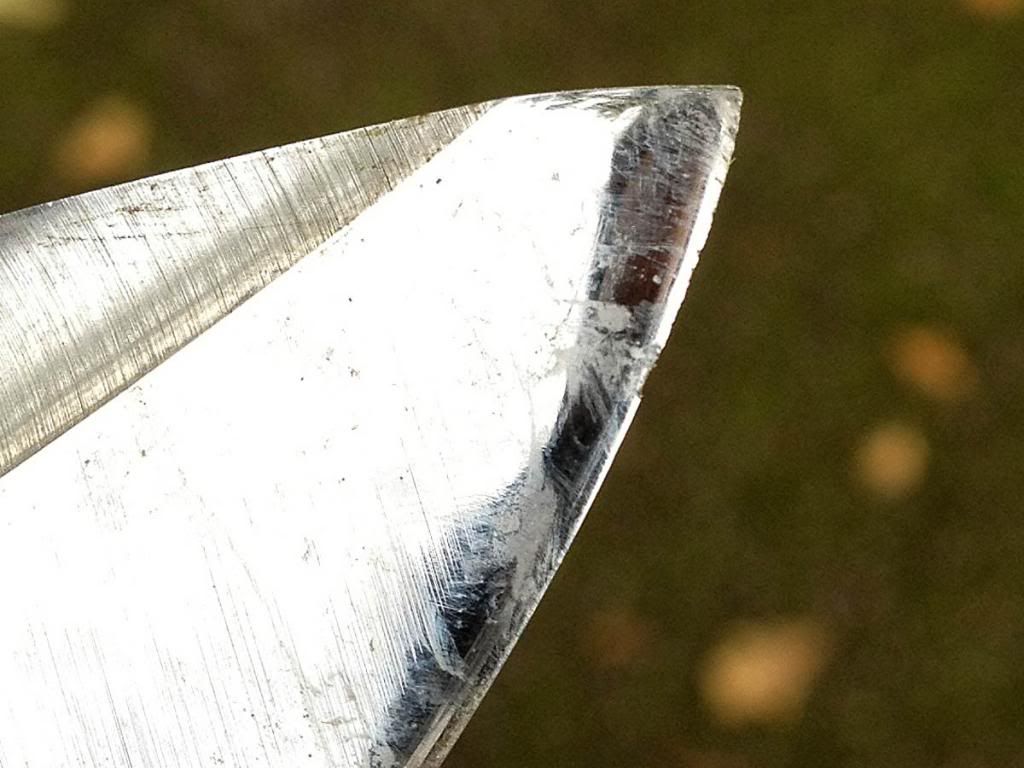

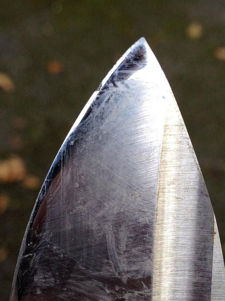

Inevitably, the edge clipped some metal and brick. This was the only visible damage:

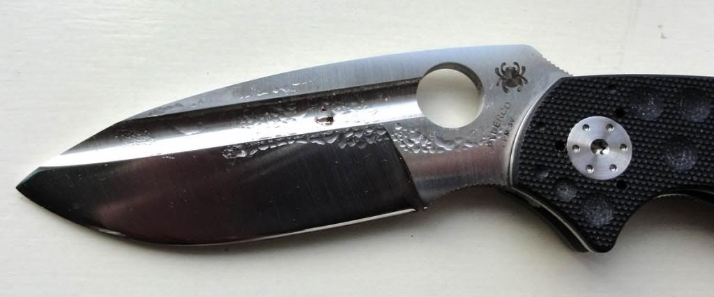

These tasks also generate plenty of body heat, this pic demonstrates condensed sweat on the blade. No corrosion issues with minimal care so far:

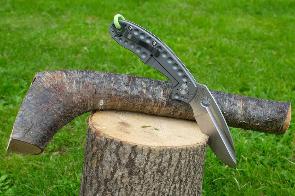

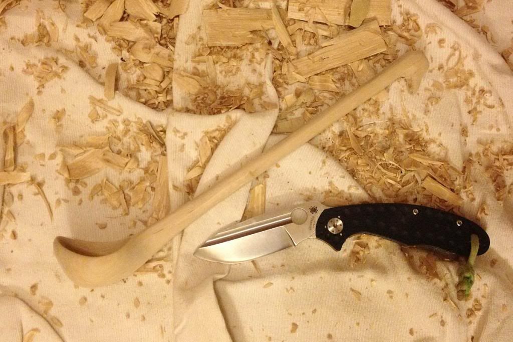

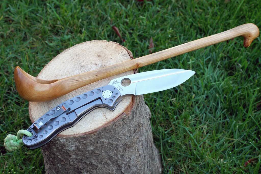

Although the knife is by no means a carver, I did use it for most of the roughing out and shaping of a ladle. This is a good test for hot-spots. Folders typically don't do well in this area (which is why I would normally use an axe, saw and fixed-blade). The Tuff did not disgrace itself, being comparable to most folders with squarish edges.

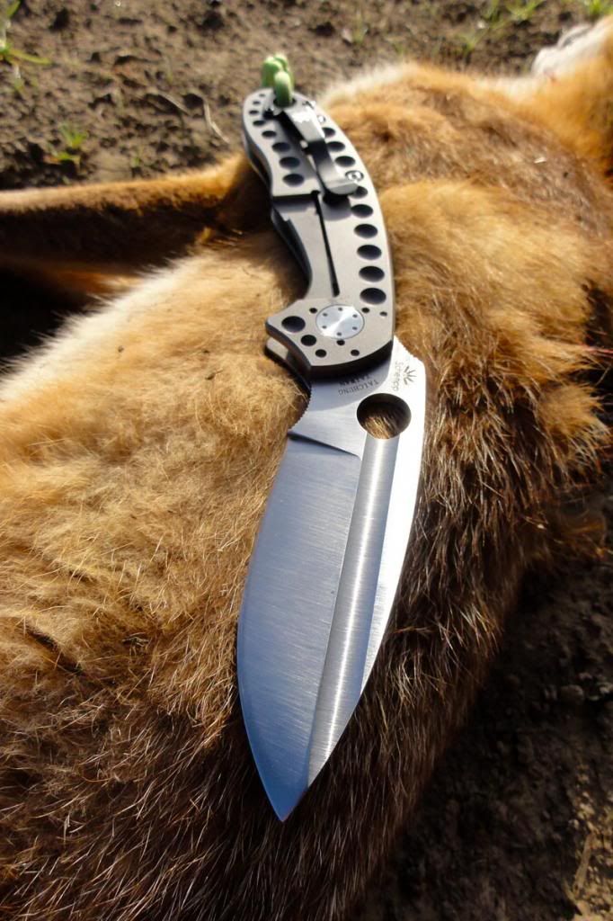

Foxes (A friend wanted the tails):
http://i68.photobucket.com/albums/i10/xavierdoc/Spyderco Tuff/DSC03837_zpsa9bbd3a5.jpg

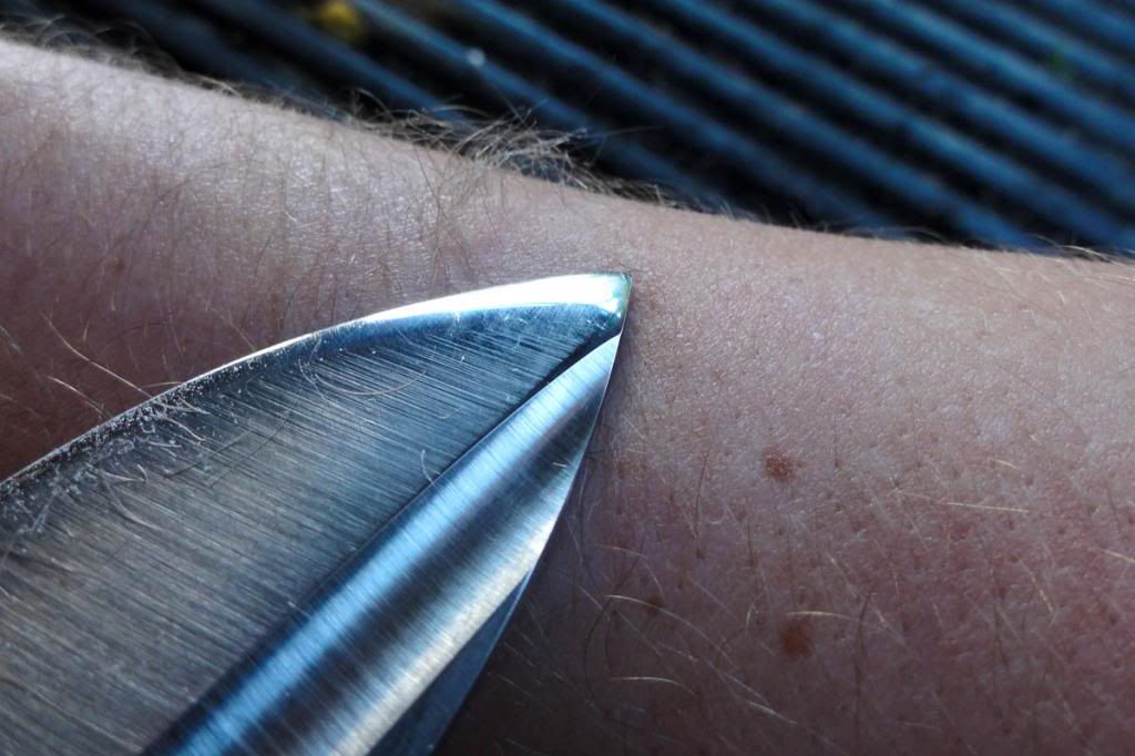

Before processing this deer, the blade was shaving sharp:
http://i68.photobucket.com/albums/i10/xavierdoc/Spyderco Tuff/DSC03876_zpsd044ba4f.jpg

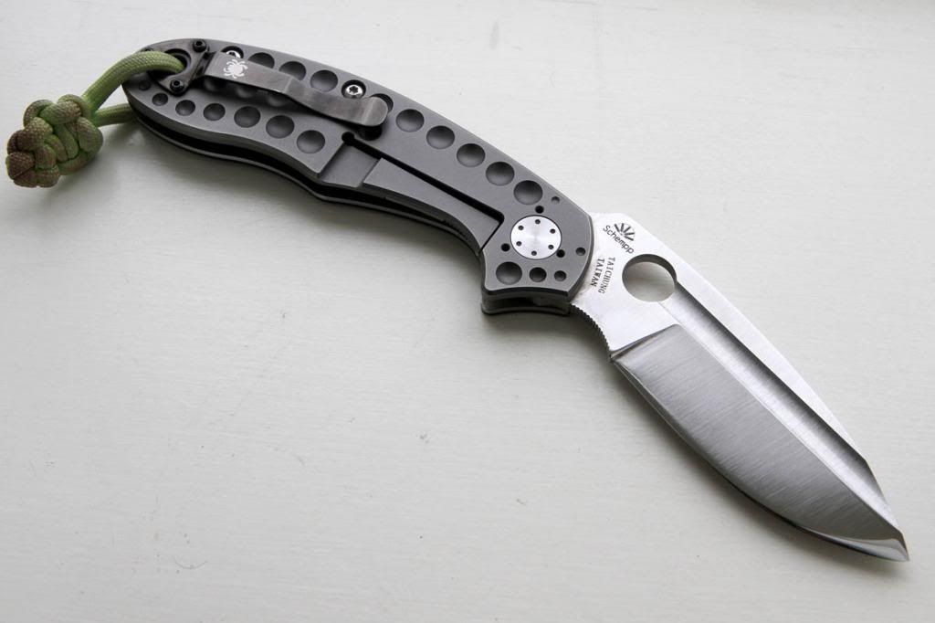

The fit and finish of this Taichung-made knife is superb. The lock hasn't shifted at all, there is no suggestion of blade play. The blade is perfectly-centered.
Appearance is an individual matter. I don't care what it looks like so long as it gets the job done. This knife gets the job done. Grip is fine. I'm not sure about the dimples.
It is heavy; I do not mind weighty knives but others may find this too much for pocket carry. I find it completely unnoticeable clipped in a pocket.

So what's the point in that groove along the knife, the "fuller" as [I think] you called it?
The "fuller" has the following effects:
1. Cosmetic
2. Reduces weight without compromising torsional rigidity (swords?- someone help me out!)
3. Theoretically can act as a blood groove
4. Increases production cost and complexity
5. Gives an additional grip option for opening the knife
6. Gives an additional grip option for opening deer (see above in hunting pics)
Very good review sir!
Please tell though, what are those
Mini sheep beside the knife om the fence? :p
They ship with the Tuff: it eats one per day!
