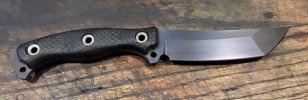

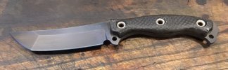

Has anyone else stripped a newer SR101 blade?
I stripped my BG EPD and literally applied the final Oxpho-Blue finish within 30 minutes of pulling it from the stripper. All it needed was a couple of once-over's with scotch-brite pads and it was done. Very little decarb, no gremlins or even milling marks to speak of.
I'd like to see more newer ones stripped to see if this is the new normal or if I have an anomaly. I'm planning to strip another one when I have time.
