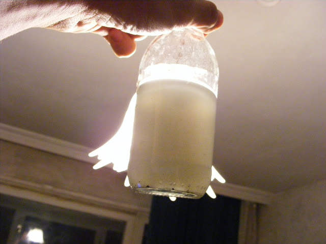

Hello, people. Any of you tryed to stabilize wood with polystirene (stirofoam), thinned in acetone? I am making my first try now. I dont have a vaccum pump now, but I will get some old fridge compressor to make myself wood stabilizing chamber.

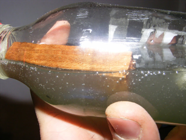

Of course I will share the results and make pics. :) Now I am looking at little peace of wood that I soaked in stirofoam solution and I can see bubbles going out from the ends, so I will leave it unthil they stop coming out and the wood hit the bottom of the bottle. (I am pushing it under the surface with copper wire)
I wil try to find plexyglass monomer or I will try to make a solution with ether or acetone from pieces of plexiglass. What is B72???
