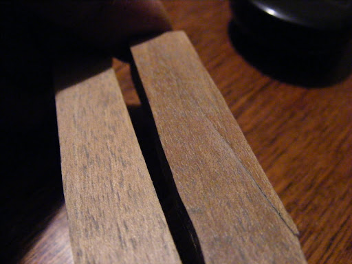

Ok, Guys, bubbles stoped coming out yesterday. I split the wood pieces, and stirofoam compound was inside all the lenght. Small pieces... They are more heavy, little bit more harder, and water takes in very difficult. Still stink of aceton. I will leave them on my balcony if the smell will go away. It is somehow stabilized or atleast surface impregnated. I will check it on grinder in the weekend.

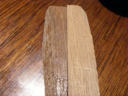

So this are the two parts of one wooden piece. The darker is treated with Polystirene solution, other isn't. Treated piece is little bit harder, and wood is not takin in water as fast as untreated one. I will put both in water to see how it will do.
Wood is doing good in water, but I have to make a knife with scales handle to see if it moves on the edges.

How much Styrofoam did you add to how much acetone? The pics look good.:thumbup: Did the "resin" penetrate all the way through/into the wood?

Tt penetrates all the way, Mitch. As you see on the photos i crack the piece and inside there is darker colour, uniform all the lenght.
Well, I fill half of the bottle with aceton and start to stuff stirofoam pieces unthil it became like liquid soap consistence. I dont have precise dozage. :)
Good thing of all stuff is that aceton keeps the polysirene in liquid state all the time, and it penetrates as long as there is dissolvent in the liquid. I will make more solution and I will place inside a big piece of wallnut wood - enough for handle slabs.

Ok, people. I made some experiments with a wooden block, impregnated with polystirene solution. It is 32.2mm thick. I split it in two pieces in lengt to keep two pieces with the 32.2mm thickness, and I throw one piece in a bucket of water for 6 hours. After I take it out it was 32.8mm thick. It is 0,6mm movement in water.
Than I split the soaked half in two and I got surprized. Water reached only on 1mm from the surface of the wood. It is deep impregnated.:thumbup:
I grind off a little bit of dry piece. It is harder than regular material and it polish very good, on 400 grit belt it is like glass, and there are no hollow fibers and chips.
