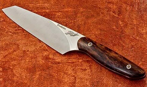

Haha don't worry, S30v doesn't suck. My wife's Haslinger kitchen knife in S30v cuts like a laser. Once a month I hone it for 20 seconds on the belt sander with a leather belt/green compound and she's gtg.:thumbup:
