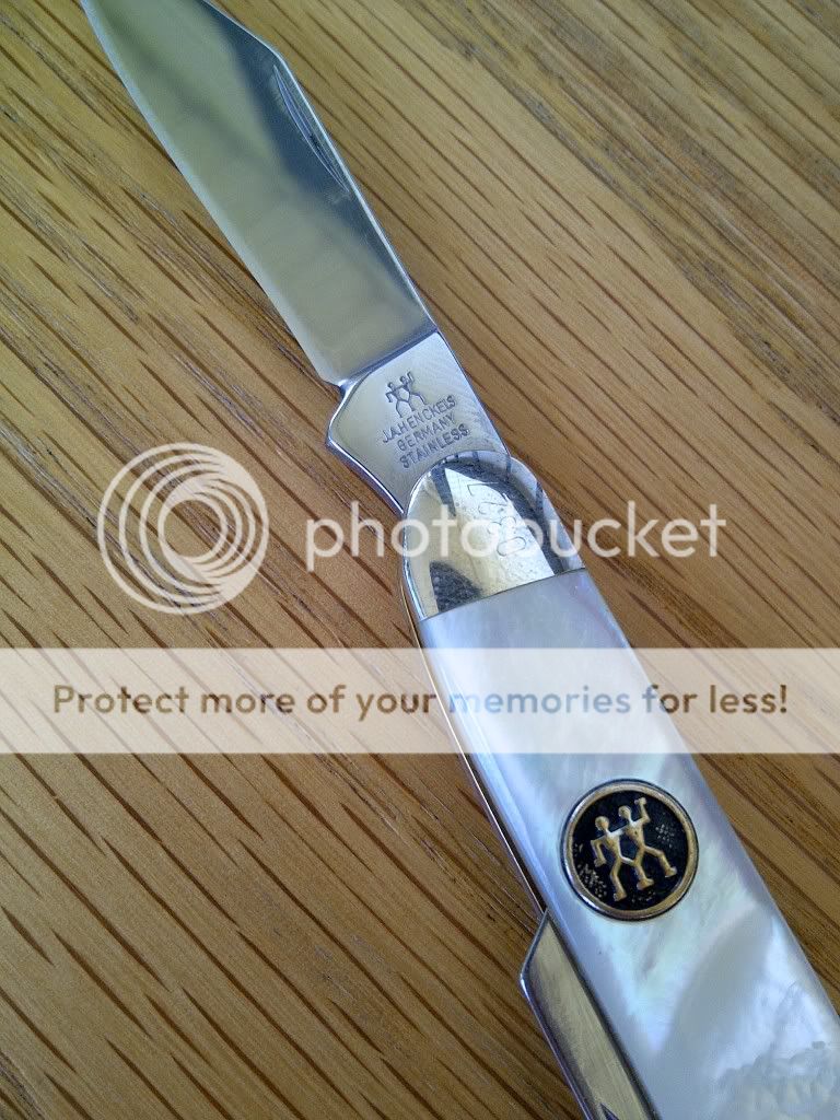

My Henckels whittler (which I adore) is 420hc
Here is a video of it:
[video=youtube;AlhwbgKQ3jg]http://www.youtube.com/watch?v=AlhwbgKQ3jg&feature=plcp[/video]
Here is the best closeup I could get with my phone just now:
I have also commented before how much whittling of hard woods I have done with this knife with very little edge dulling and NO edge deformation. I forgot this one I did thin out on my grinder, but since have kept it up by hand. Its convex.
