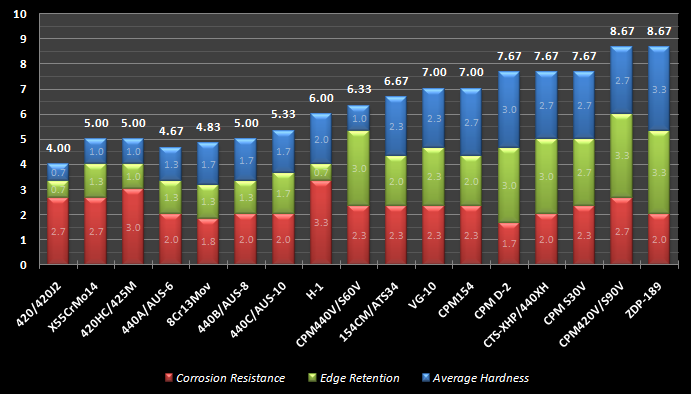

Stainless Steel Chart Comparison for EDC Knives v2.4
*more steels and measures will be added to the chart in future, as well as toughness, wear resistance and sharpness attributes.
x-axis = price
y-axis = rating

Each attribute is ranked from best to worst, and given a numerical value/rating between 1-10 based on its rank in the chart, rank is determined by a combination of the general consensus (and also Rockwell and CATRA tests) from resources cited in my references. The rating is then divided by the number of attributes measured, as more attributes are added to the chart in future, the individual attribute ratings will change accordingly. All attribute ratings are then aggregated into a total rating for that steel. The maximum sum of all attribute values will always equal to 10. While this post is a crude and oversimplification of the steels mentioned, it should provide an idea of how the specific steels perform when compared to others.

....Maybe on a different part of the chart you can break the steels down to activity i.e. hunting/skinning(ats-34,cpm154);filleting/fishing(vg-10,440a,s30v);field use military(1060 - 1095);bushcraft(01,5160);rafting/ watersports(s30v,440a,h1) these are just some of the steels I would consider but maybe not the best but at least it would be a start.
Heh?!? What does that mean? How is 5160 a "bushcraft" steel? 1095 isn't a "bushcraft" steel?![]()
I appreciate the effort, KW. Interesting discussion, although I'd like to see more constructive comments on how the comparison might be improved. Subscribed...
If you switch your chart to mill recommended working hardness range, published corrosion resistance, abrasive/adhesive wear resistance, carbide volume and average size, and impact toughness all at given hardness and heat treat protocol, then the complaining ought to stop.
That number is too low to form any vanadium carbides and is used for grain refinement at that level. Wear resistance would not be affected by .15% V.It also has a 0.15% Vanadium which gives it a slightly better edge retention.
Not even close in either attribute.Almost A-2 class toughness and almost S90V wear resistance, hardened to 58-61 Rc.
One thing 440C does well is in corrosion resistance. This would be incorrect.Its not as tough as the other 440s and 420HC steels, and not as corrosive resistant.
A common misconception and revisionist. We didn't even use the term then. The first "super steel" was 154cm, then ATS 34 after a batch of "dirty" ( inclusions and some bubbles which caused voids when ground out) 154cm gave Hitachi an opportunity to get their foot in the door. Aus 10 has a better grain structure, lower chrome, and vanadium so it takes finer edges, chips less, but has lower corrosion resistance.440C was considered a Super-Steel for a long time by some before the emergence of higher end stainless steels
Well, you did state " IMO" , so you aren't stating facts. If you were it would be incorrect.IMO, VG-10 has the sharpest edge of any stainless steel.
Nope.154CM is harder, and tougher than any of the previously mentioned steels,

Thank you, knifenut1013. You beat me to it. For those masters of steel in this forum, this chart is not common knowledge - its nonsense "junk science." For those who know nothing about steels, it only adds to the misinformation out there.
