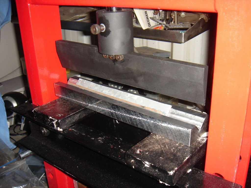

Thought I'd post a pic of the stamp press I just finished up last night.
Kevin, thank you for the inspiration!
I made it wide enough to accept knives from the front and the side, depending on where I want my mark to go. It works like a charm with my new Evers Stamp. It pops in and out in just a few seconds. I milled a slot in the lower cross member to accept the stamp, and installed a clip to keep it from falling out. Two 1/4-20 bolts hold the stamp square and plum while stamping. The jack is a 6 ton, and does the trick with little effort.
I made about 15 successful stamps with it on a bar of O-1. All clear and crisp. I got the material to make it for free (out of the scap bin at work), and only paid for the jack. I think it cost around $20.00 at one of those discount tool stores. I ground the top (pad) of the jack smooth and flat so it wouldn't mar the bottom of the knife while stamping.
Thanks for looking.

I received some questions via email about how exactly this press works. Here goes:
The stamp is held inside the first (bottom) cross member in a milled pocket. The top of the stamp makes contact with the inside top wall of the first cross member, thus offering support for the stamp so it can't move up anymore. This first cross member is reinforced by the second, directly above it. Evers stamps come with a hole in them. I use a cotter pin, fitted through guide tabs welded to the frame of the press, and through the stamp, to keep it from dropping out of the pocket.
The blade is placed (and held by hand) flat on the pad of the jack, then raised into the stamp. The stamp is held plum and square to the jack's pad with the two 1/4-20 bolts (one on either side of the press). Very little effort is required after the stamp makes contact with the blade. Just a pump and a half or so of the jack handle and the job is done. The whole process takes maybe 15 seconds to perform from start to completion.
To switch stamps, you just loosen the alignment bolts a little, pull the cotter pin, and the stamp drops right out. Pop the new one in, level and square it to the jack pad, then snug up the alignment bolts again.
Here's a close-up of that area. Hope this helps.
Scott

IN the past that was always an issue for me, one needed the steel soft enough to take the stamp (the reason for my 20 tons is that my "KC" is bouble outlined and requires a lot of force to go into the steel). Doing it hot always resulted in misery for me. Getting it when it was annealed, before HT, was good but if any clean up had to be done after the HT the stamp would get washed out. When I finally got my system down so that I could completely finish before the HT I had it licked. I still ahd all the problems with double and crooked stamping. Some times I would get a little too shallow and have to hit it again, the fine double lines on my "KC" was horrible to try to line up again, I would stand there for 20 minutes minutely wiggling the stamp around to determine if I was back in the original grooves before striking, and almost every time I was wrong:(. I Had toyed with the thought of pressing them in for some time, thinking it would also be much better for wear on the stamps, but never got the ambition to make the damned press. For years I had been using an old treadle hammer to do the stamping, but since that is all I still used it for it was just taking up valuable floor space, so I decided the best way to motivate myslef was to get rid of it, and send it away to a friends shop in WI. I suffered for a little while but it worked, I finally got my lazy butt around and made that press in one afternoon for around $50. When shopping for a jack I saw an arbor press and considered that route, but I was still messing with the hammer and there would ahve been much more alteration and expsense.
I am very happy I just bought the jack. For something like my "MS" too much of that 20 tons will actually set it too deep. For my initials I designed the thing so the stamp passes throught fromt he bottom and can still be struck from the top, but there are no problems with this as with over 15 tons on it there can be no double striking- it ain't going anywhere! Jsu take your time and align thing perfectly and then go ahead and squeeze it in. Also this unit is very small and sets on one little corner of the bench without takin up any space that a floor press would.
