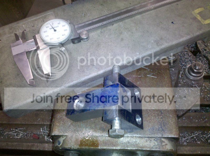

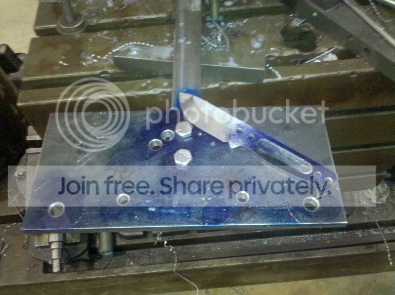

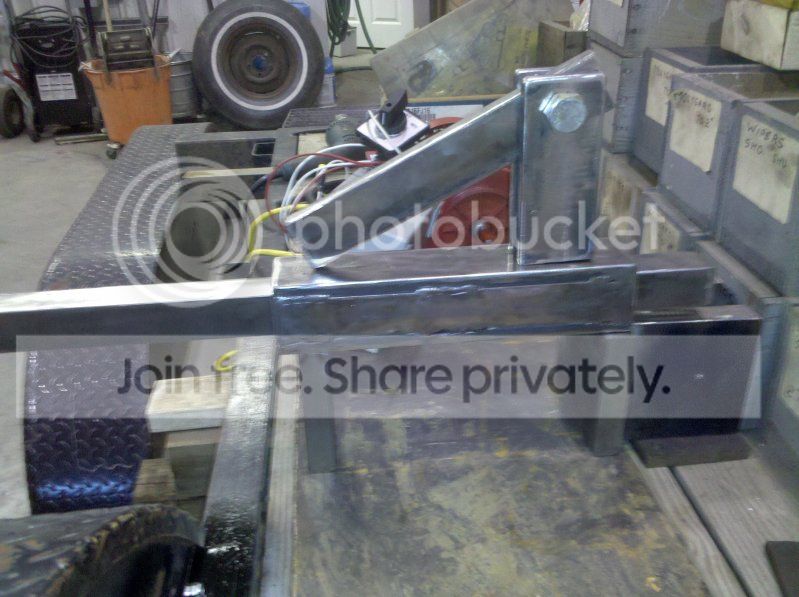

It seems difficult to get a good grinder here in Canada so I thought I would try my hand at building one. I am doing kind of the kmg style, it seems most people are happy with that style of grinder. Made a bit of progress so far. I will post some more pics as I go along.
This unit will be a bit heavy, the bearing plates are 1 inch, the arm for tracking/tensioning wheel is 3/4.
I will be making the idler and tensioning wheels as well, hope it turns out ok!
I am going to mount the pivot to the top of the arm, a plate with a slot milled in, then the plate the wheel goes on will hang from the slot. This will allow me some alignment whereas if I have the plate pivoting from the vertical side of the arm i do not think there would be any room for alignment. I am sure there area a dozen ways of doing it, just trying to figure out what would work best for me. I have actually never seen a 2x72 grinder in person, just on the net. I am using a compression spring for the tension. I read somewhere of problems getting enough tension with a tension spring. I am sure I will be doing quite a bit of learning on this project, and that is why I decided to do it!
Any suggestions would be welcomed for sure!
I noticed that you centered the tensioning arm over the tool arm. How are you planning to mount the idler wheel so it lines up with the other wheels?
I'm assuming you're planning on direct drive. Are you sure you'll have clearance for that motor?
I welded the tensioner arm as a unit,and drilled and reamed the 3/4" pivot hole after welding the two plates to keep everything lined up perfect, reaming the plates then welding them is hard to keep everything lined up. I havent welded the pivot frame to the square base yet. The tracking mechanism is made out of 3/4" plate, which hasnt been bolted down to it yet, and I will weld the pivot frame when I finish making the tracking wheel and assemble it. It will be a shaft drive, I still have to drill out the rear flange bearing housing for the drive shaft to go through, again it will be drilled as a unit as it is welded first.

Trypper, the frame that the tensioning arm has not been welded to the frame yet, I just set it on there to take the pic as to the pieces I have made thus far. Duffy, I will post pics of my tracking setup, still a couple pieces to machine for it! Seionage, glad you like the pics, and I will for sure take more as I go along. Brian Ayres, I figure if it is heavy enough one would need a picker truck to steal it out of my garage. Dixie blades, I have looked at the beaumont site, wonderful looking grinders and accesories there!

I have seen his prices, very reasonable indeed but unfortunately he does not ship to Canada. One nice thing about bolting the unit together is nothing gets pulled out of whack that welding does, once I get everything dialed in as close as I can get I can set the unit up on my mill and clean everything up perfect. The flat platen assembly I have a few concerns with.

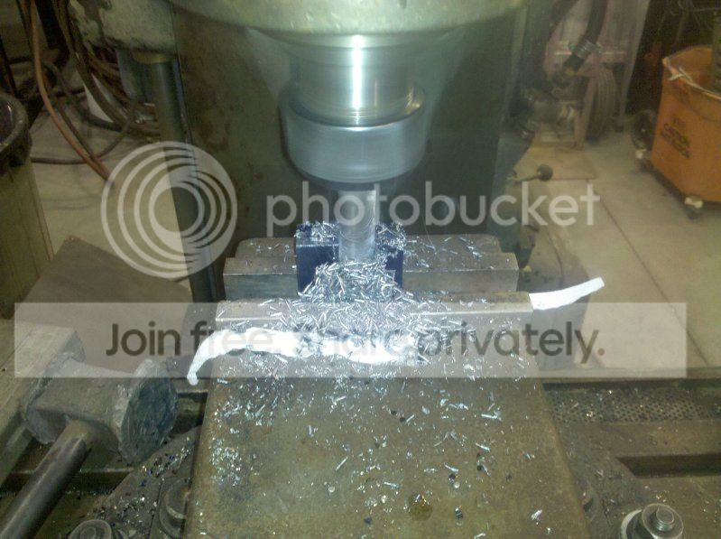

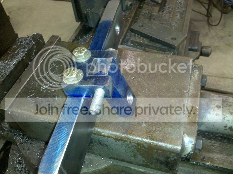

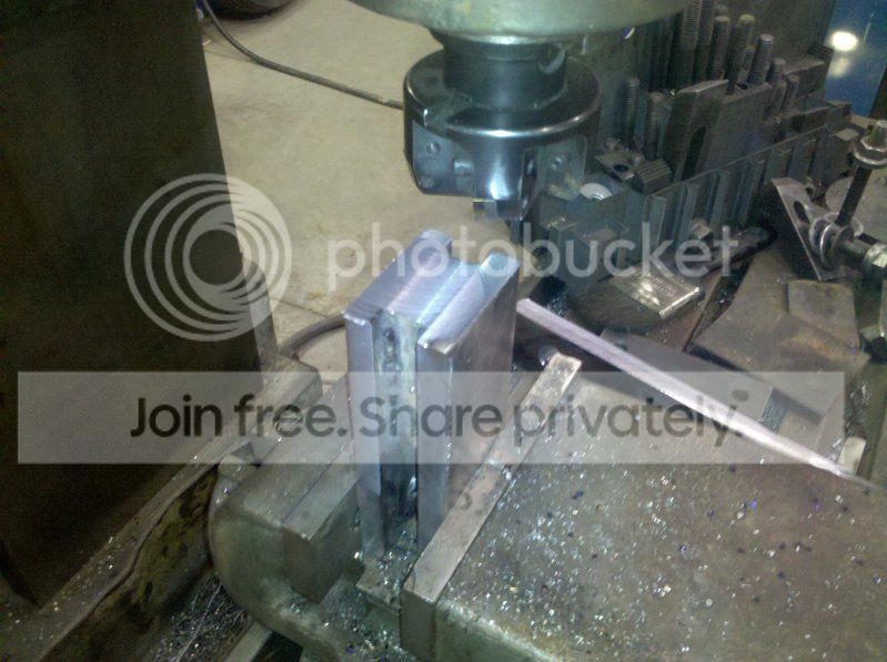

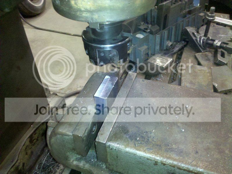

I got a bit done today. I drilled out the bearing plates for the flange bearings, still have to mill some surfaces on it. I milled some pieces for my tracking assembly, tensioning arm, tensioning arm mount. I find the hot and cold rolled steel is not very square along the edges, so this will get a nice surface to work off of.
I also picked up a gas cylinder I am going to try for the tensioning.
Milling a piece for the tracking assembly
Milling the top of the tensioning arm
trueing up the tensioning arm bracket

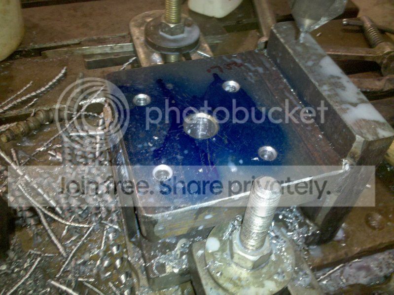

Reamed and drilled the flange bearing plates as a unit, keeps both sides perfectly lined up

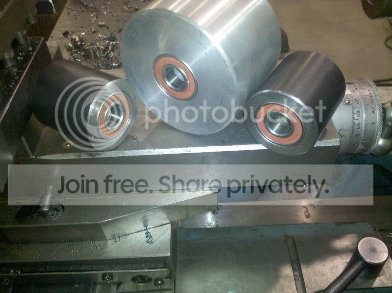

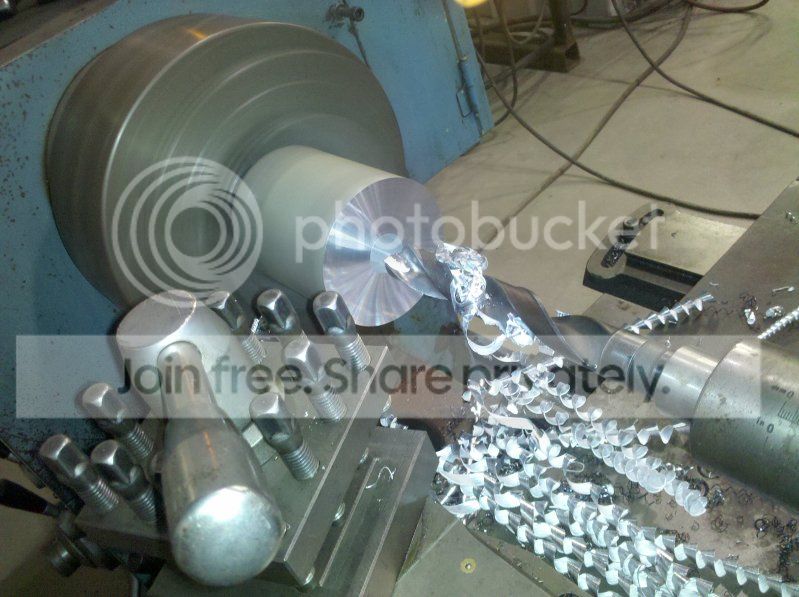

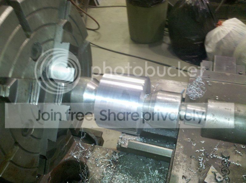

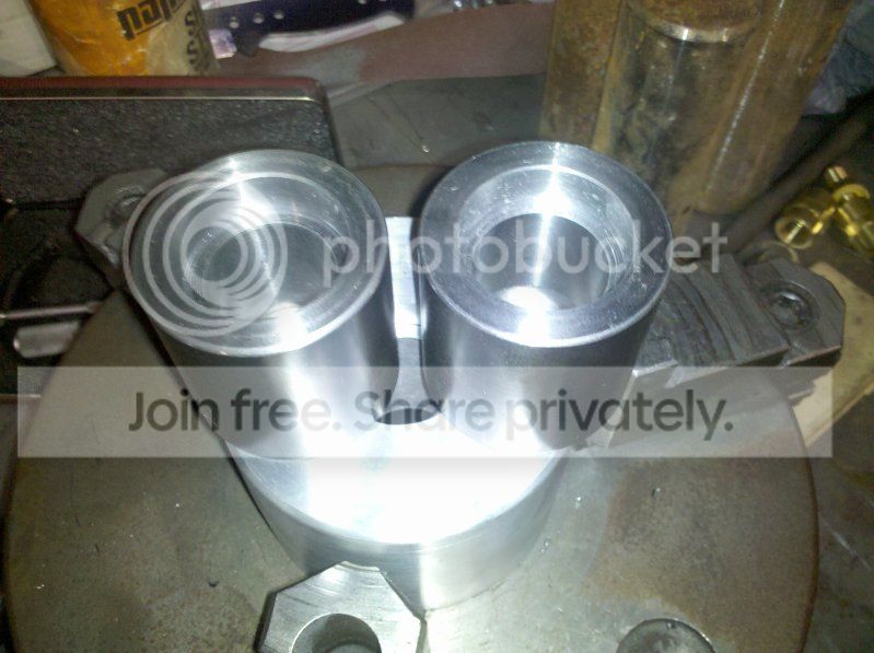

Made some more progress today, made two idler wheels and the tracking wheel. I used nitro rod for the idlers, very hard stuff!!

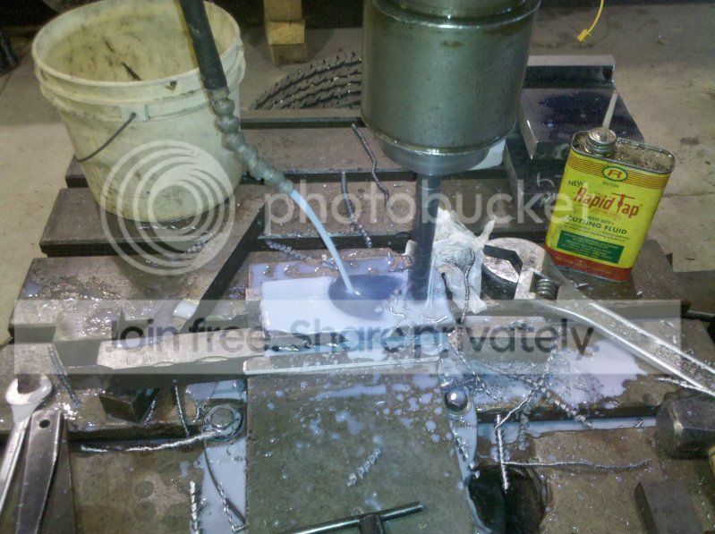

I did a couple more things, first pic is tapping 1/2 inch holes in the 1.5 inch tool arm, for fun I put my big tap handle and a big tap just behind the half inch tap. Work up a sweat working with that thing!!

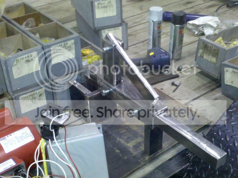

Here is the plate for the idlers and the platen.
