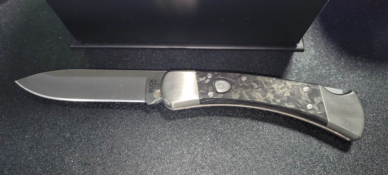

Oh my gosh, new knife day came early!!! Just arrived, holy crap this thing is gorgeous! The pics online don't do the marbled carbon fiber justice at all, this is a work of ART! THANK YOU BUCK!! Woo-hoo gotta go show everybody, be back later.😍
We look forward to your picture.
Mine just showed up. Really nice. Buck did a good job on this one.
The marbled fiber carbon feels and looks great. The blade is perfectly centered and the grind is spot on.
Came in today. I really like it the action is perfect, fit and finish seem very good. I like that they put a piece of leather or cloth behind the snap rivet on the sheath so it does not scratch the knife. I have not noticed that before on other Buck sheaths. It came VERY sharp right out of the box. The marbled carbon is awesome. It is solid and catches the light nicely in different ways. Definitely a sheath only knife as it seems quite easy to activate the button if it was floating around in my pocket.

Update: After an evening of fidgeting with the Automatic I have had several times where it would not fire, particularly after I put it in a pancake sheath. I put it back into the stock sheath. But I think there may be a biur somewhere. ?? Iy=T feels really gritty when I operate by hand. I doubt I can address it so maybe Ill just work it alot and hope to smooth out the burr.
Great pics! I'll try to take some of mine tomorrow...this is my first Buck auto ever and i'm really enjoying it, the opening is nice and smooth with just the right amount of positive "click" when it locks, nice bonus that it clicks the lock on closing fully.
