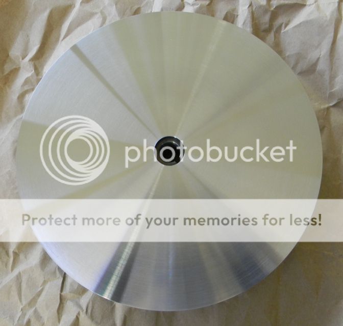

This was supposed to be a Saturday sale, but I'm about to head out of town for the weekend and I won't be able to post it tomorrow so I'm posting it early.
These are 9" grinding disks made of hardened alloy steel (4130 HRC 44), turned in a way to minimize runout and then balanced. They were made by request in response for a need for industrial quality grinding disks made for professional use.
These are time consuming to make. I have 3 flat and 3 taper with the 5/8" bore ready and 1 flat and one taper with the 3/4" bore today. If they sell out, please come back to this sub forum next Saturday and I'll have more ready for sale then.
The 3/4" bore disks are not broached, they're a plain bore to mount on a Thompson shaft. I will broach them on request before shipping, no problem, but it will be a reduced depth key so as not to cut too deep in the wall of the stub. You'll need grind your key to fit.
I'm about half way through a batch of 100 disks. When the batch is finished there will be no more of these.
The last thing I do is spin it up on an unmounted motor and let it coast down. The motor is unrestrained so any vibration or other troubles would have an opportunity to show up here. Video if you're curious:
[video=youtube_share;-b_h7NaZxKg]http://youtu.be/-b_h7NaZxKg[/video]
The manufacturing of these disks was documented on this WIP thread:
http://www.bladeforums.com/forums/showthread.php/1088181
These disks are 8.875" in diameter and mount to a 5/8" shaft. Setscrews are included as is some keystock. The key stock may require some slight fitting etc (you're a knife maker right?)
It is important you tighten the two setscrews properly. This disk weighs over 7 pounds, you want it to stay on the shaft. The setscrews are high quality Holo Krome brand fasteners of domestic origin, the sockets will not easily strip. You should use a hex insert in a screw driver rather than a dinky wire Allen Key, and if in doubt use a drop of blue loctite. The thread is 10-32 if you want to change to different screw type.
In this sale I have three flat 5/8" bore disks and three 5/8" bore disks with a 1 degree taper on the face, and I have one each with 3/4" bores. If you order a 3/4" and want it broached you need to let me know. They are $160 each and shipping is $10 in the USA via USPS priority mail. Be aware that if you're more of a casual user, Beaumont Metal Works has an aluminum disk for half this price.

Thoughts about "runout":
The manufacturing approach I'm using virtually eliminates runout in the disk because the OD, working face and the internal diameter of the bore are all single point turned in the same setup on a CNC turning center. Unlike drilling and reaming, which can create an off center hole, single point boring creates an accurate hole without risk of bias or walking. Cutting the face at the same time sets the working surface perfectly perpendicular to that bore and cutting the OD at the same time also sets that feature perfectly concentric to that bore. Observable runout on the actual disk is almost physically impossible. That said, you could have the most perfect disk in the world, but if it isn't mounted to your spindle properly or if your spindle itself has runout it is still going to wobble. Electric motors are not ultra high precision spindles, they're simply designed to turn pulleys etc without a lot of fuss. Some even have bushings instead of bearings. If you get a disk and it wobbles I can almost certainly guaranty the problem isn't the disk, but I will still gladly refund your money if you will return the disk in prefect condition.
