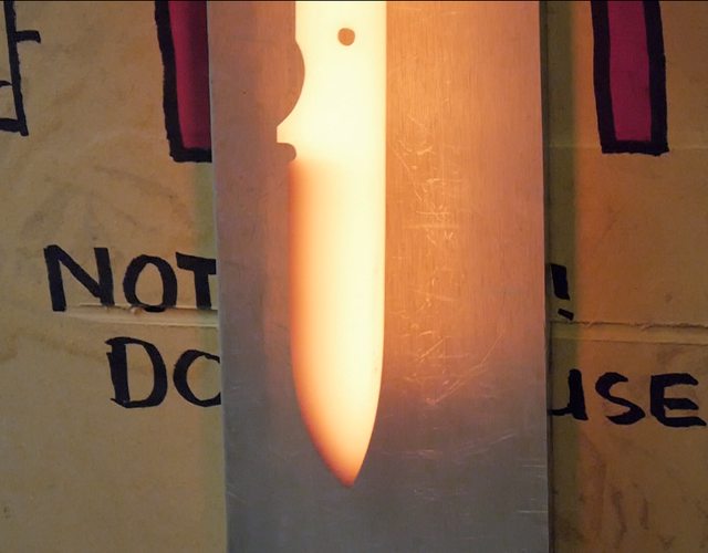

CPM3V
Preheat to 1500ºF, Equalize
Ramp to 2050ºF, hold for 20 minutes
Quench in air to below 125ºF
Temper at 1000ºF, 3 times, 2 hours each
Aim hardness 61HRC

The O1 that received the 'homebrew' heat-treat was basically heated in a propane fired forge until dull cherry red, then quenched in oil. It was then tempered twice at 400ºF, two hours each time.
CPM-3V moments after leaving the kiln

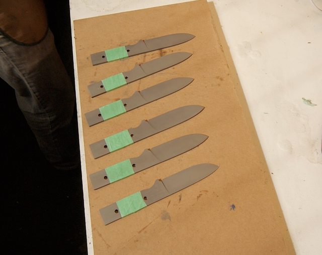

After all the blades were finished the next step was to ensure that the edge thickness of each blank was as identical as possible. The edge thickness I was aiming for was 0.013". All the blanks ended up being a maximum of 0.0005" away from this thickness. This was achieved by grinding each blade a little thin, then using a diamond hone along the edge of the blank until the edge was the correct thickness.
** Be aware that my test blades are a little sloppy around the plunges and such. I only just got a grinder and these are the first knives I've made using a grinder rather than filing by hand.
After the test blades were all completed I wrapped the handle area of each blank in tape so that the identifying engraving was hidden. This way I can ensure that I can test each blade without having a preconceived notion of how it should perform, as I literally don't know which blade is which!
The lineup of test blades after their identifying engraving has been taped over.
The knives were then shuffled, and engraved with a number in the ricasso area, this is the identification number for each blank. This allows me to track the performance of each blank across the tests without having to know which blank is made from which steel.

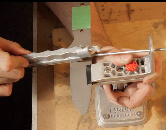

Sharpening time test:
The first thing I wanted to check for was ease of sharpening. I basically did this by taking each blank, which is identically shaped, and has identical edge thickness, and sharpening it up using the exact same technique and timing how long it takes. Not exactly super scientific, but it gives me a bit of a feel for each steel.
I used a Lansky diamond deluxe sharpening system for the test. Each blade was sharpened to 600 grit, then stropped. Stropping time was not included in the test results.

Sharpening the test blades with a Lansky sharpener
In my eyes steel #2 was the winner in this test. The edge was noticeably sharper than the other even without stropping. The difference in sharpening time between the steels wasn't really enough to put me off any of them. As I was sharpening for the first time I was removing quite a lot of steel, and it was all still relatively quick.
If one of them had taken 15 minutes or something then I would have known that steel would have been significantly harder for my customers to sharpen.

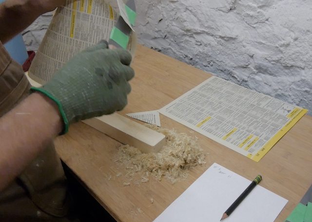

Fine edge retention test:
This test was intended to see how long each type of steel would retain it's finest cutting edge under relatively normal usage conditions. To test this I sharpened and stropped each knife until I couldn't tell them apart for initial sharpness, then cut sisal rope with each one until it would no longer cleanly slice phonebook paper.
Because this test involved a relatively subjective measurement process I repeated the test numerous times to get a larger sample. Each time I covered the identification number of each blade so that I wouldn't be able to associate a certain blank with an expected level of performance. Every run was done 'blind' in that I didn't know which knife I was using at any given time.
The test was done using only a 1" section of each blade. This was achieved by taping up the blade so that only a 1" section was exposed, then making sure to stay within that section.
Testing the edge after making a series of cuts
For each knife I would make 20 cuts, then test the edge. If it still cut the paper cleanly I would make another 20 cuts and so on...

IMPORTANT EDIT: This data is somewhat noisy, so be wary of drawing exact conclusions from it. Probably the best interpretation is: all these blades held an edge acceptably, except for #6
Blade #3 is obviously the winner here by a significant margin. Blade #6 failed this test miserably!
I made 2660 cuts in total, and had quite bad blisters on my hands by the time I was finished!
To be clear: by the time a blade was 'failing' this test and was starting to snag the phonebook paper, it was still easily capable of shaving hair. This test was testing the retention of the very finest edge!
