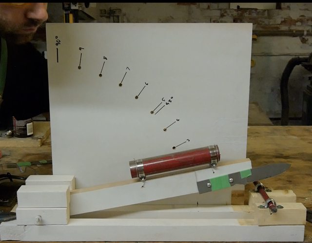

To test this 'impact toughness' I built a guillotine-style rig that lets me bang a knife into an impact target in a repeatable way:
Knife testing ala Mythbusters
To begin with I was using a block of walnut as the impact target, but unfortunately this didn't have any negative effect on any of the steels under test. To try to get some results I upgraded to a 1/2" bar of aluminum as the impact target, still no dice.
I upgraded again to a bar of 1018 cold-rolled steel in the hope of doing some damage. It did do some minor damage to the edges, but it was insignificant and fairly uniform across all the blades, nothing to be learned there.

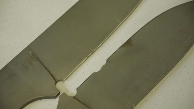

In desperation I decided to get significantly more abusive, and proportionally less scientific. I put each blade in a vise, edge upward, and smashed it as hard as I could one-handed with a crowbar. Finally some interesting results!
The difference between the steel that handled this the best, and the one that handled it the worst was quite marked:
On the left the blade that handled the crowbar the best, on the right the worst.
Blade & Failure Mode
Best
2 rolling
1 chipping
3 chipping & rolling
5 rolling
6 chipping & rolling
4 chipping
Worst
Blade #2 is starting to look like a real contender! I feel it's important that it failed by rolling instead of chipping. I think it indicated the steel has plenty of ductility left over for even worse abuse.

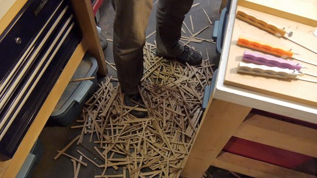

Tonight I continued testing the blades, first up was a coarse edge retention test.
Coarse edge retention:
Retaining a cutting edge under difficult and extended conditions is a different skill to retaining the finest edge possible. Things like straight razors are optimized for holding a very fine edge for as long as possible, but they probably wouldn't do too well on cardboard...
Given that cardboard is such a common material, and potentially a very trying one for knife blades I decided it should be included in my testing.
Each blade was used to cut 1,190 linear inches of corrugated cardboard. The edges of each blade were then inspected under strong light, as well as used for cutting phonebook paper. The knives were graded against each other until an overall order was reached:

A very large pile of cardboard cutoffs on my shop floor

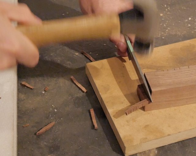

Batoning:
In order to test shock resistance and edge retention I did some 'batoning'. Only my batoning was across the grain, and I used a 16oz hammer to drive the blade...
Each blade was hammered 3 times through a 1.5x1.5" block of walnut across the grain, each blade was then hammered through a 1x2" block of hard maple across the grain.
None of the test blades were noticeably damaged by this test, most if not all of them were just as sharp after the test as they were before. No issues there.
The spine of each blade showed some minor mushrooming after all the hammer blows, but I don't think that's a terribly useful or realistic test, so I didn't note which ones were the best/worst.

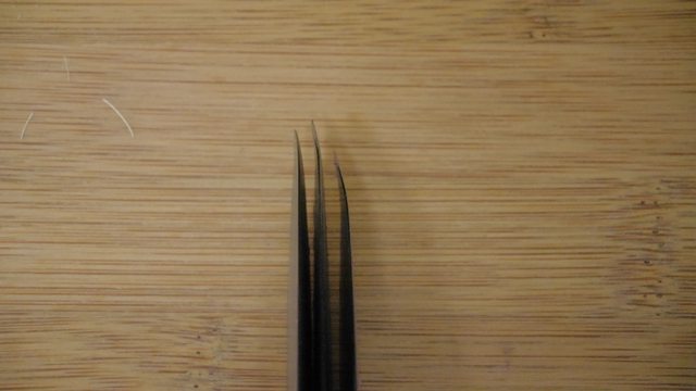

Tip strength testing:
This is something I see complained about often, broken tips, so I try to make sure I work it into my testing. A bent tip is better then a broken one in my mind (provided they require the same force to produce)...

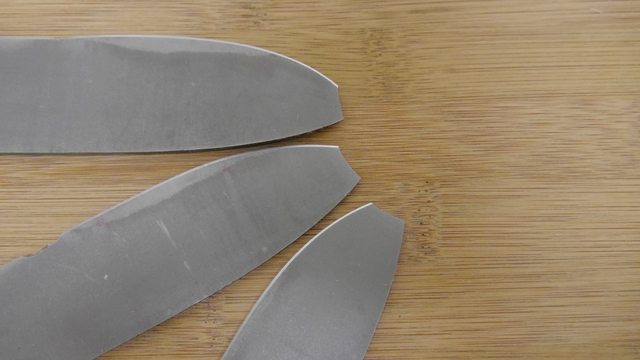

I hammered the tip of each blade into a block of maple using three light hammer blows, the tips sunk in about 3/8" each. I then levered the tips out sideways to see what happened. The results:
Code:
[FONT=Courier New]
Tip strength test:
#1    Very slight bend
#2    Slight bend
#3    Broken
#4    Broken
#5    Moderate bend
#6    Broken
[/FONT]

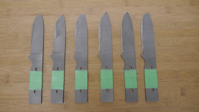

The blades as they are right now
Left to right: blades #1, #2, #5
Three broken tips
