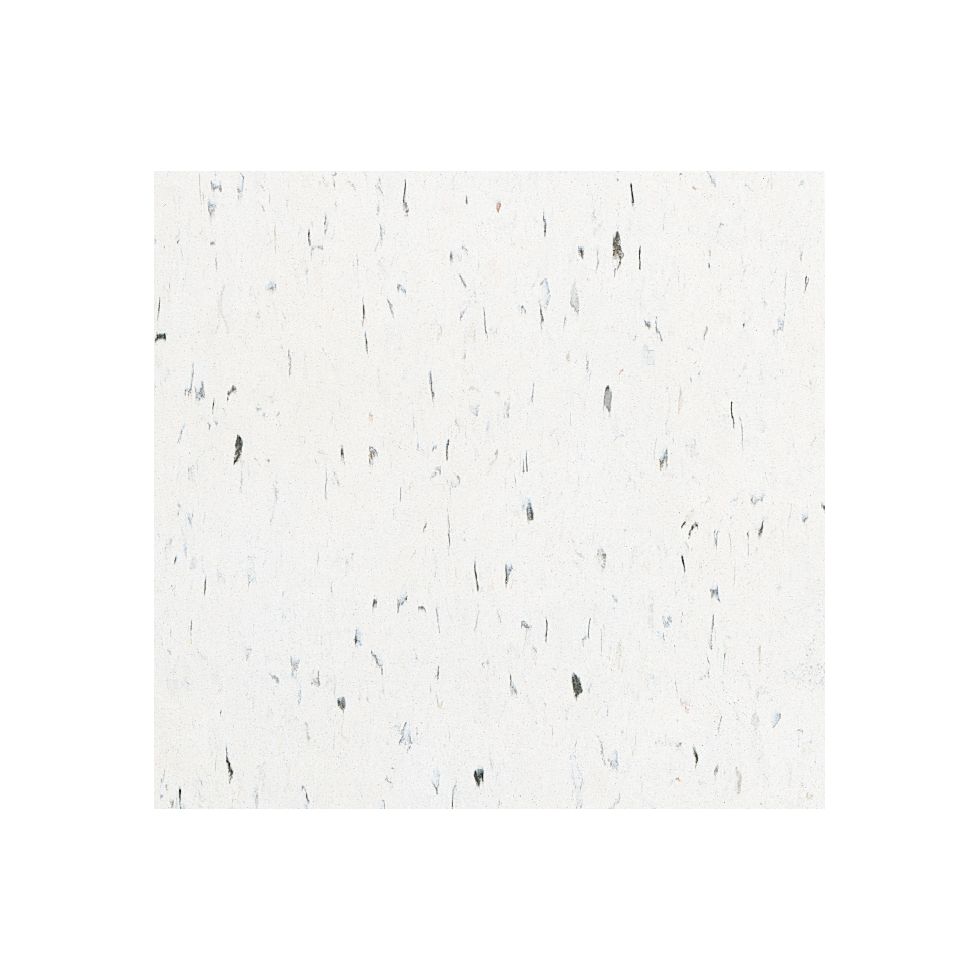

I did some edge retention tests on around 15-20 types of steel, the test only took absolute sharpness not working edge results.
I cut into and dragged the edge over a very hard polymer surface, until the blade would no longer cleanly cut through tissue paper (Not printer paper)
I found that certain steels stopped cutting the tissue after only 1-2 cuts into the polymer. Other steels lasted longer, steels liks S30V / S35VN all did around 4-5 cuts. K390 did around 8. CTS-XHP from spyderco did around 17. Some M2 tool steel HT to 65 HRC did the highest at around 18-19 cuts before it lost it's bsolute edge and no longer cleanly sliced through tissue paper.

what kind of polymer surface was this? let me know, I'm willing to test this on my zdp when I get the chance

I did it on a type of kitchen floor tile, a PVC Vinyl compound one. You can pick them up cheap online companies even offer free samples. I held it on a table edge and applied around 30-40 lbs of pressure while drawing the edge over the tile.
Vinyl composition tile (VCT)? It's 12" square and usually 1/8" thick (at least in the US)?

They are just a Vinyl composite, they come in many different grades, I have no clue which exact grade they are. But it's just similar to Micarta or a resin based fiber type structure. It's pretty similar in feel to cutting into micarta when making batches.
