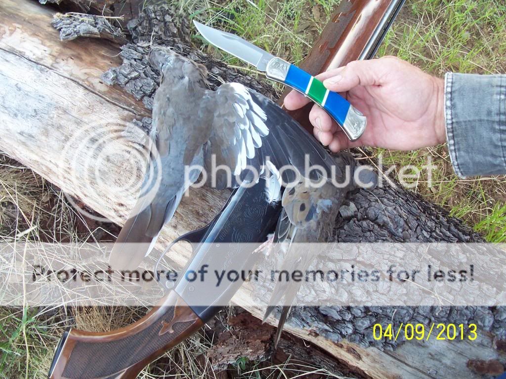

haze, Your behind in your reading. The 110 with D2 steel came out in 2013. Here's you a picture of it with some doves. DM
