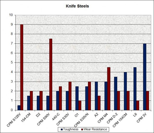

Or Elmax. CPM-D2 is pretty good stuff but it never really turned out to be all it was cracked up to be IMO. It's basically just clean D2 (takes a much better finish and finer edge) without much if any other useful improvements.
Actually I think u wrong there. According to the chart I have cpm D2 has 40% better toughness
Yeah... all the charts say that but that just hasn't been my experience... although it's difficult to even estimate closely without fairly sophisticated equipment. Regardless, for the same price, machineability, wear-resistance and corrosion-resistance as well as being able to get a nice finish on it, CPM-3V is much tougher than either form of D2. It's also more readily available. So when I want tool steel I just use 3V.
