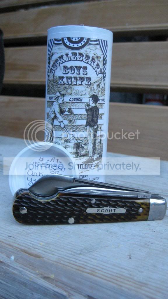

PS: One armed jack slipjoints are a slippy that is made to be one hand opened. I know many friction folders that one hand open, not many slipjoints.

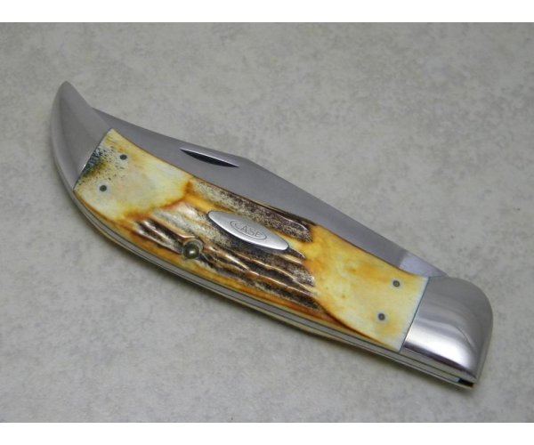

What kind of slip joints open with one hand?
One hand opening of a slip joint is possible when the main blade is "pinchable". There are three design features that make a blade pinchable.
Knives with a pronounced clip and well placed nail nick are pinchable. The old style single blade folding hunters including the Case Clasp Knife or Schrade "Mustang" are examples.
Second, knives with small frames compared to the blade height are pinchable. The sodbuster pattern and some Laguiole style knives have this feature.
Lastly, knives with easy open cut out, so-called EO patterns, can usually be pinched.
Most traditional lock-backs can also be opened using the pinch approach.
There may be some disagreement on what is meant by "easy". I consider standard transmissions to be "easy" but they do require some knowledge and practice. Traditionals slip joints as above are easy to open one handed in the same way. You need to know how and you need to practice enough to get it.
