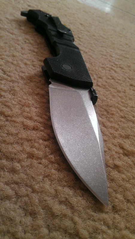

hahaha when I first started researching how to stone wash I didn't quite understand what the dryer part was for, I thought it was some process at the end that finalized the finish...needless to say I did it by hand, but I'm excited to use the dryer now that I realize it's just an automatic shaker ;)
ak1 by Vollertron10, on Flickr
LOL!!!! The dryer is way easier!!! That blade looks absolutely fabulous!:thumbup:
