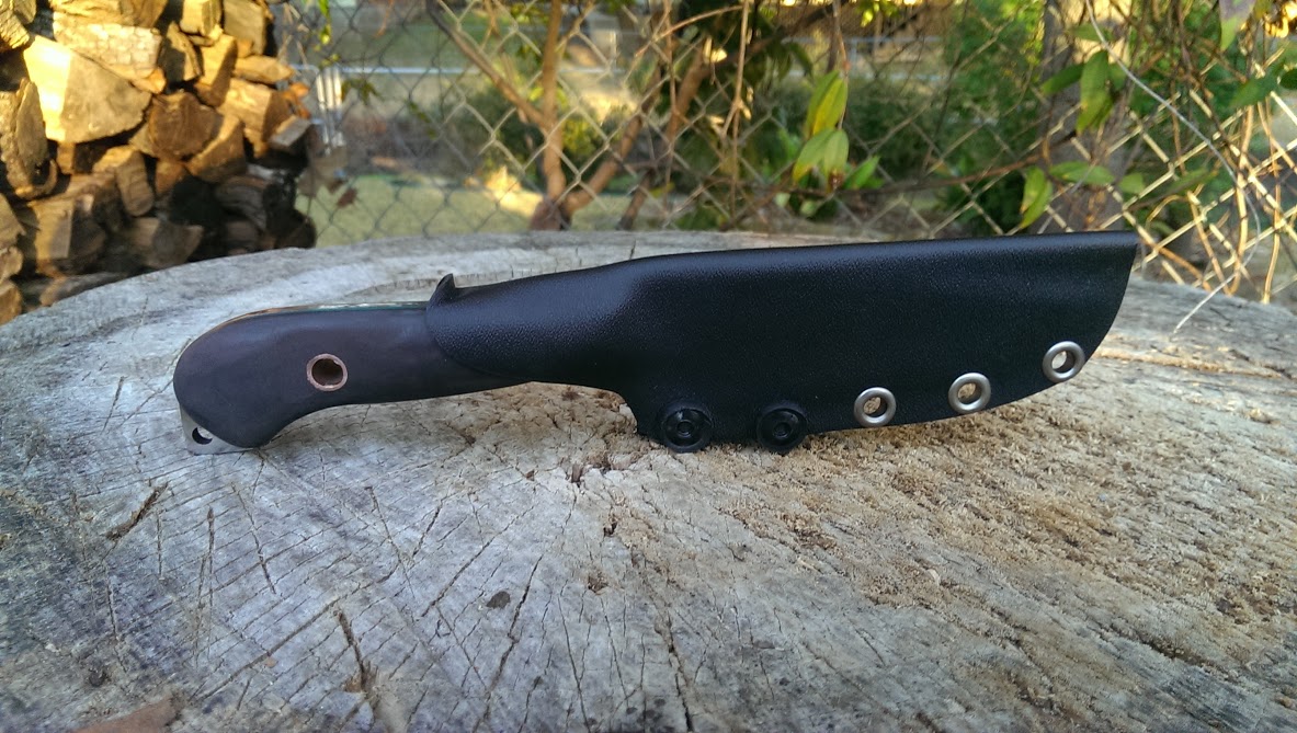

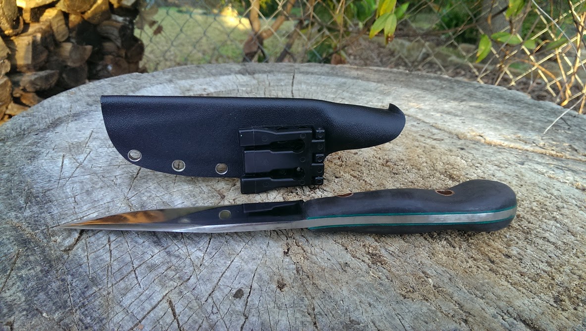

Well we got together right away and before I knew it I had a bar of CPM154, a few handle scales, some spacers and pins and, with Jim's tools, everything I needed to make some knives! Some credit is definitely due to Stan Buzek as he came through in a pinch and gave me detailed instructions for how to heat treat cpm154 over the phone one night. I hope I don't sound too vain by saying I am pretty proud of these. That being said, most of the credit is due to Jim and Mr. Buzek and Blade Forums for all the help. The HT could probably use some slight adjustment but we achieved a final hardness of hrc 59.

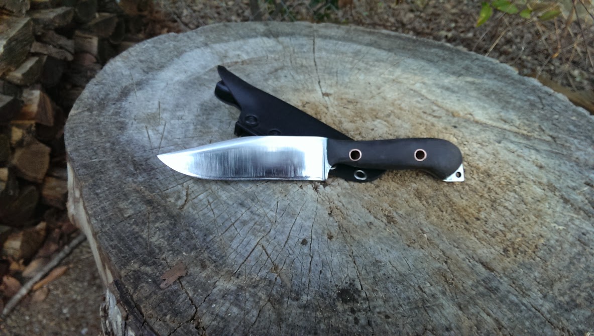

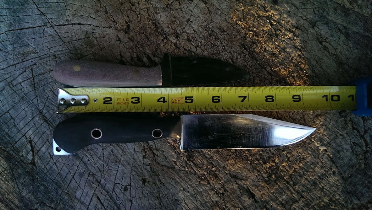

This one started out as a design for myself. I thought I wanted a blade like this, but after doing the next two, it lost a lot of it's appeal to me. The grinding was left way too coarse before HT, thus the prominent grind marks. The handles are neoprene scales that were given to me and I'm not crazy about the way that they worked- I actually shaped most of this handle one night whittling at it with an xacto knife. All the sanding methods I used, except for on Jim's ginder with a fine grit belt make the stuff look funny. It also drives me crazy how the grind for the pointer finger got so close to the first pin. If I can find someone with the tool, I may try to flare the copper tubes I used as pins.

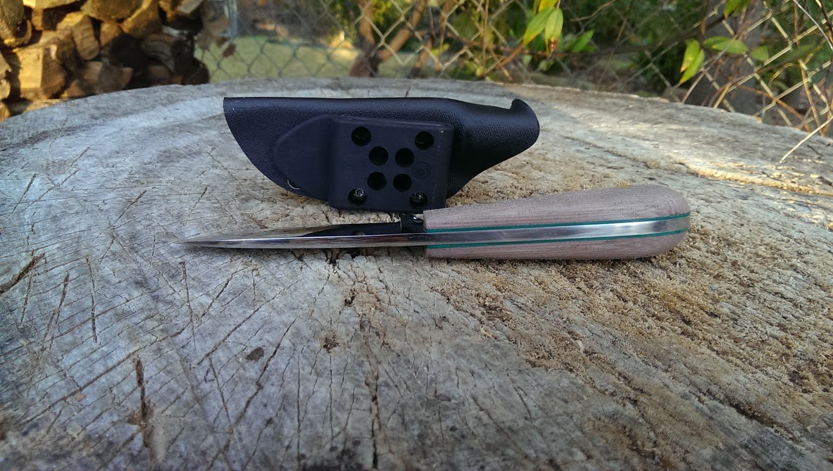

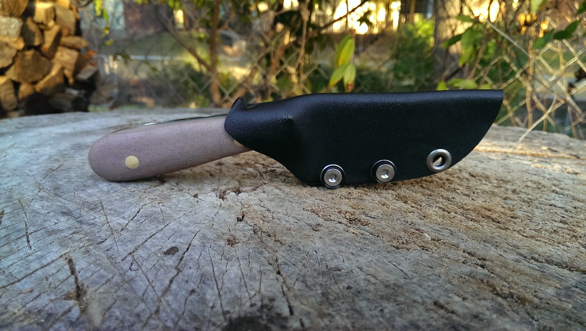

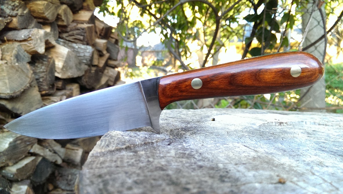

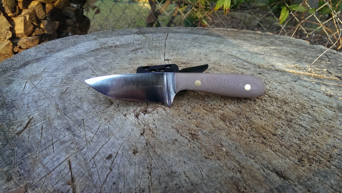

This next one has TerroTuf scales and I gave it to my cousin's husband at their wedding this last weekend. He's an Army EOD stationed at Fort Hood. I told him the only string attached was that he had to show it off to all his buddies. I figure I'll get some referrals out of the deal.

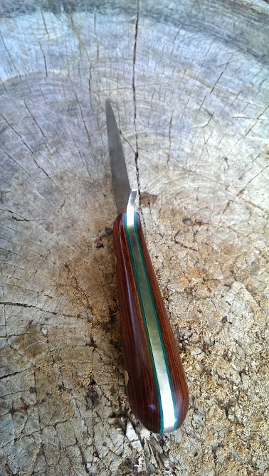

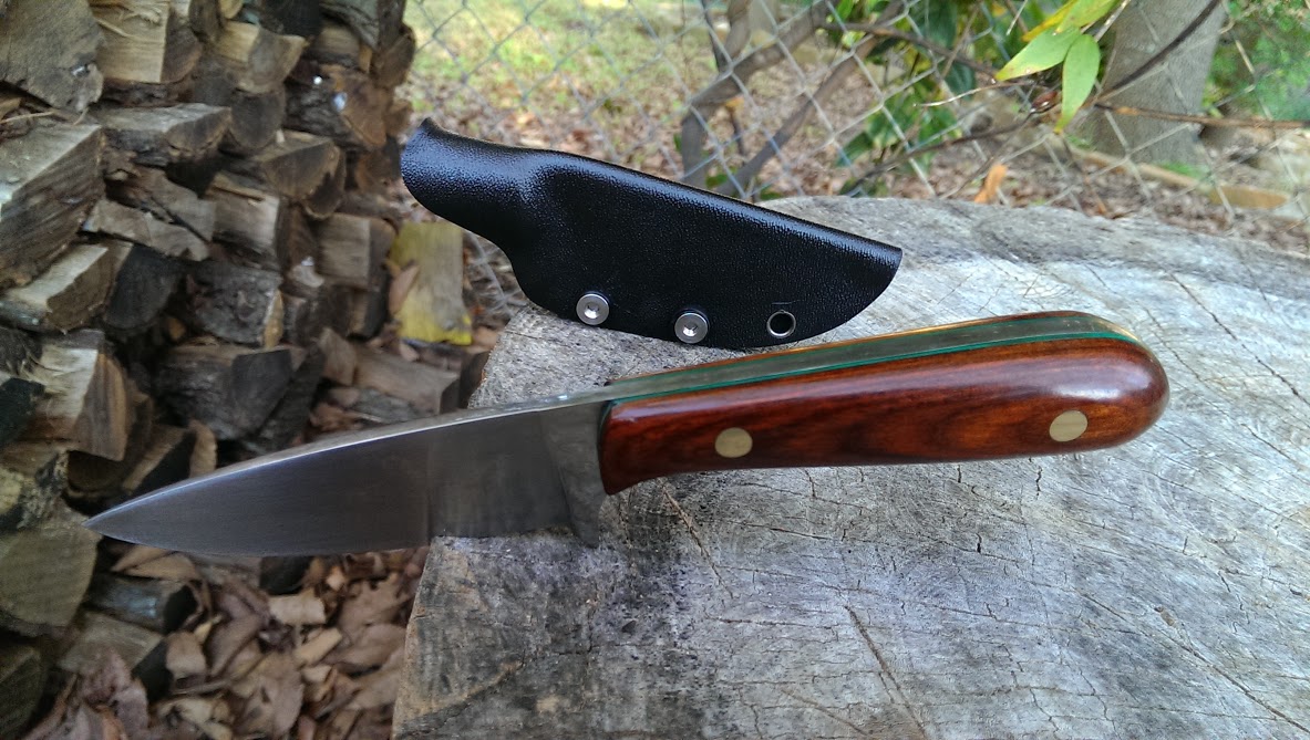

This last one is done with Resin Wood Cocobolo scales. This was my favorite and went fast to a friend as a gift to his dad. His dad is actually the Dr. that delivered both of my daughters- the last one being born just a couple weeks ago on 12/17.

I am neurotically perfectionistic so I am all about the small details. All the kydex sheaths I've made scratch the blades and that drives me crazy. I put at least 3 layers of blue masking tape on each blade hoping to make enough space but it doesn't seem to make that much of a difference. I'm all about hard using my blades but there's nothing like spending hours sanding and polishing a knife and then slipping it into the sheath and pulling it out with scratches up and down the blade. :barf: For this reason, I am going to a local saddlery this weekend to get some leather scraps and starting my adventure into leather work. I wanted Kydex to work as I love the utility and tight hold. I've read extensively here on BF on this issue but any and all advice is welcome.

You can linenkydex with microsuede. Its easy to do and cheap. Look at a good kydex holster, its lined. Safariland is a good example.
I like the blades man, especially that third one.. that's sexy.

Making Kydex sheaths have a few tricks not necessarily easily found.
3 layers of tape is fine...but then you squeeze it even tighter when you install the eyelets and get scratches. So while the knife has the tape on and is in the sheath take out your heat gun and run it over the sheath to get it to expand just a bit and give you the clearance you need.
Be sure to rinse it will under the tap to remove debris and then let it dry out.

Thanks so much the feedback! Notice the blade is sanded pretty heavily lengthwise to try to disguise the scratches.
A couple of questions:
Could I affix the microsuede to the kydex with spray glue like what's used on upholstery? Of course that would have to be done before heating and press-shaping the kydex to the blade- does the microsuede and glue hold up to that just fine? I forsee complications there.

Thanks so much for the advice! I don't have a heat gun but I guess I should look into one. When I do, are you suggesting I do the heating before placing the eyelets? If you don't mind give some more details on this process. Do I just wave the gun back and forth a few times on each side until I see it loosening a bit or what?

BTW, very nice work. I'm really digging the last one.
Turbo dog is off to a great start! I don't want to give him the " big head" but how many of us can say our first three knives looked this good.
