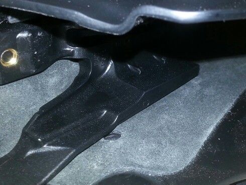

For the m microsuede, I have only done it on a two piece, gluing up the microsuede with contact cement before final assembly with eyelets. Use a piece of kydex welting to account for the thickness change. I haven't heated kydex with it on... yet... I am working on a project and will be doing a kydex fold-over wrapped by leather. I will be lining it. I think I am going to form it up, then just heat the spine to open it up and glue in the microsuede. It doesn't stretch much and I doubt the cement would stand the heat, so this is the best bet I reckon.
Here is a safariland holster innards with the microsuede.
