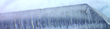

The edge shows signs of having been honed on a fine finishing stone of an appropriate grit for razors. It's clearly not a diamond or CBN stone, which would leave different-looking scratches.
There is obvious edge damage (this is probably the worst section of the middle in that respect), plausibly caused by shaving. There are signs that the original grinding marks were not eliminated at the edge by the honing, even more apparent in this picture:
This is a sign that not enough time was spent with stones finer than a final finisher, resulting in small jaggedness in the edge when one of those lines reaches it. You can also see minor signs of pitting near the edge, likely a sign that the razor had some tiny water droplets on it for an extended period of time.
This level of disturbance in an edge (in this section of the edge, not the one above) should not make for a bad shave.

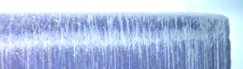

I'm quite pleased with how well this steel has responded to the 800 grit diamond stone.
The edge shows only the minimal jitters expected for this grit. The grinding lines are no longer passing through to the edge. And the heel and toe are now participating.

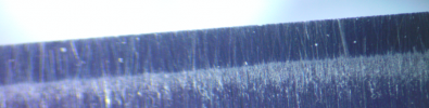

So what do we have there? Well, this is the toe on one side of the razor. It has some nice fine scratches from the Naniwa 3000 diamond stone. But it took hundreds of strokes to get it like that, and it still does not look like the rest of the edge, which is starting to look downright polished (as polished tends to look under a microscope).
So what's the difference? Well, for one thing, I suspect that smile. It seems possible that whoever made it actually lifted off the honing guide a bit. Can't say for sure. But another point is a thing that I see all the time, armed with the microscope, that I don't think I've ever seen discussed.
You can hone on a stone, and see perfect lines all the way along, and think you've got everything nailed. Then you drop down to a finer stone, and what you see is some places getting scratches, and other places not. The bevel was only flat relative to that prior grit, and there's some work to be done before it's flat to the new grit standard. The only solution to that is more strokes. I hope someday to find another, such as some way to spot what's going on before moving to the finer grit.
Anyway, my radar says that these scratches are sufficient to move on with, so I will proceed to 6000 grit Naniwa diamond next. After that, I may mix things up a bit, as I had to do on that 70HRC razor, or I may not. My guess is not. That razor was tearing up pretty badly on the edge, presumably due to brittleness. This one is not. Although it is interesting to note that the edge has not gotten less ragged, not that it was that ragged in the first place. But when honing on JNats, there is generally a steady reduction in raggedness as you move down the grits. It's also possible that resin-bonded diamond produces edges that are more ragged than vitrified diamond stones do. I don't want that to be true, because it's an expensive idea, but it could be true.
That's all defeatist talk, though. The edge looks good, for this stage of things, to my eye and my thumb, so it's time for the next step.

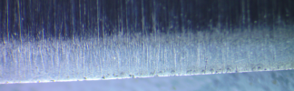

OK, the JNat finishers have worked their magic, and it worked as it generally does.
I don't know why it works, but it does. Just look at that straight edge. I love these stones. The toe (on the worst side) has fared less well, but has also benefited, because I violated all my principles and lifted the razor off the stone to make this happen. If this were my razor, I'd live with this for a few shaves, and then go straight to the 400 grit diamonds to get rid of this bad smile. Bad because the toe is not even with the rest of the bevel. I mean, I have a bias against smiles, but even if I did not, this one is just not right. A proper smile should engage with the stone without lifting off, as long as you move the blade ends to accommodate it.

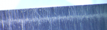

So I'm doing something else instead. I spent some time with a very firm grip on the razor, holding a known-flat stone up to my Optivisor-enhanced eye, and trying to see what sort of adjustment of the razor's position on it reaches that lowered bevel. In figuring that out, I also think I've reverse-engineered how the smile came to be. I think that the honer who created it was doing the sort of boat hull curve on the stone that one does to create or hone a smile, starting with the heel. But on one side, he lifted his elbow up a bit each time he reached the toe, like you would when sharpening to the point of a knife, bringing the bevel there down below the rest of the bevel, and therefore depriving it of contact with the stone when honed more conventionally.
That in turn suggests an approach: I'm going back to my final finisher JNat, maybe even the last two in the sequence, and try some of the same sort of strokes, on the bad side only, and see whether I can reach that part of the bevel and at least make things somewhat better.
OK, that worked. The result is not beautiful, in any objective way, but it is beautiful to me, because I can see the JNat finisher lines at the very edge of the toe.
Now I can move on. Next up is the 1 micron diamond stone (again), using only trailing-edge strokes, with that same elbow rising maneuver on the bad side. Sometimes I think that that the reason I fix these sort of issues on my own razors is that I have an aversion to keeping track of what sort of odd contortions each razor needs. It's simplest if they are all the same, dead flat.
