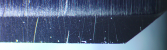

So I've moved on through the 0.5 micron diamond-pasted balsa strop, and the 0.25. Only the 0.1 remains. What things look like now is this:
The problematic toe, on the logo side of the razor.
No longer so problematic. I know there's still a band of shinier metal at the edge, and darker metal above that (speaking of the mircoscope picture; the darkness is just an artifact), but I know from observing the steps that the shiny part is 15000 grit CBN scratches, and the dark sliver is actually polish from the 0.25 micron pasted balsa strop. The edge feels, for the first time in the whole process, uniformly sharp along its whole length.

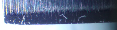

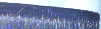

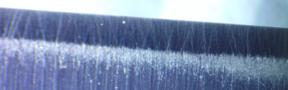

Other areas are more straightforwardly in good shape.
The toe on the other side.
A heel.
A middle area.
