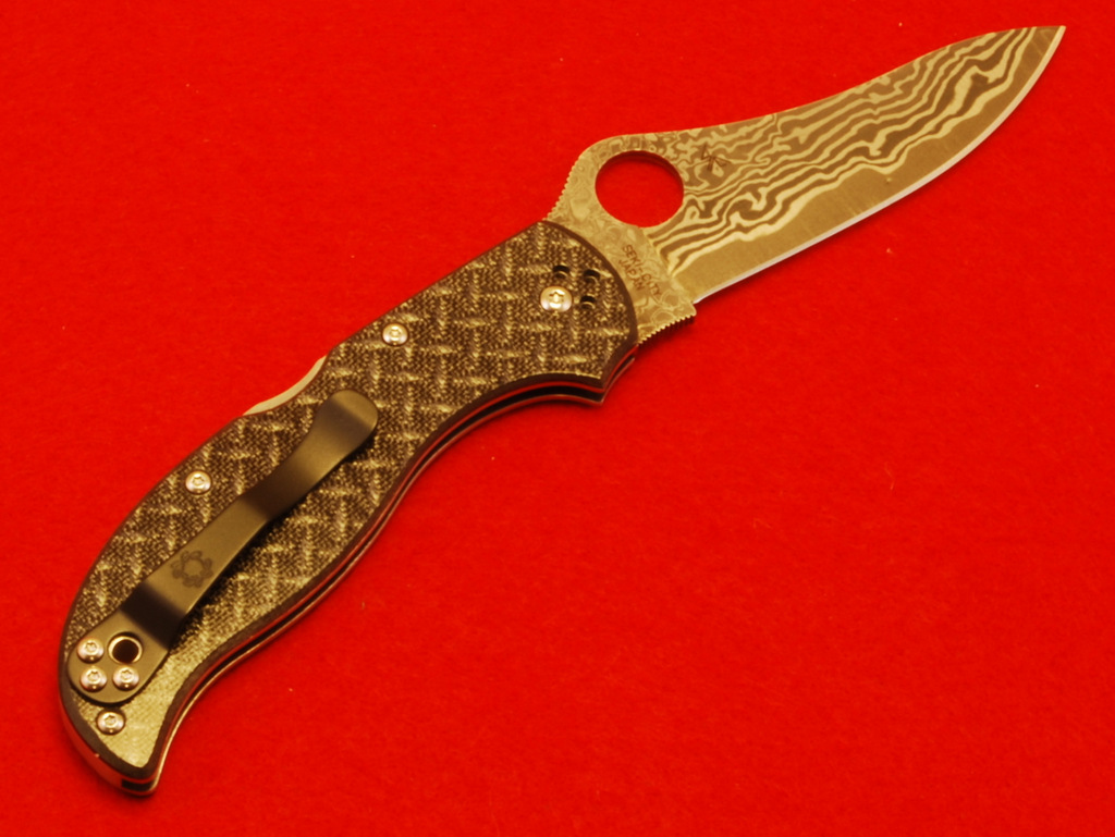

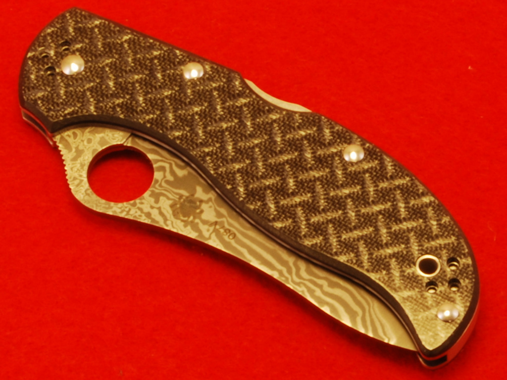

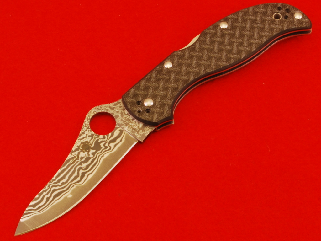

Don't have the blue one yet, but here's a couple shots of the black...Can post some photos? can't wait to see the non stock photos![]()
