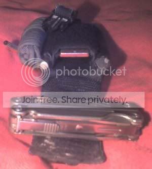

I have given thought to inserting into the hone pouch a 3" length of hacksaw or sawzall blade. That is an idea that I'm seriously thinking about. It's very flat and it will fit nicely behind the 3" diamond hone.
I also keep a firetool in my multitool pouch, and my multitool is almost always on me or I'm carrying a SAK (usually a Swiss Champ) on a lanyard while I'm kayaking or similar activities. With the SAK, I have a small magnesium firetool on the lanyard also (also a whistle, small compass, and a DMT mini-hone). When I strike a ferro rod with the multitool or the SAK, the best surface to use is the back, unsharpened spine of the wood saw blade.
