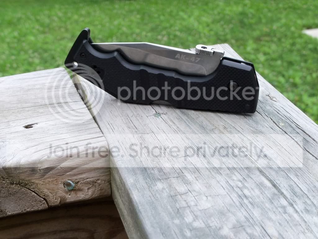

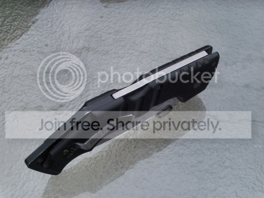

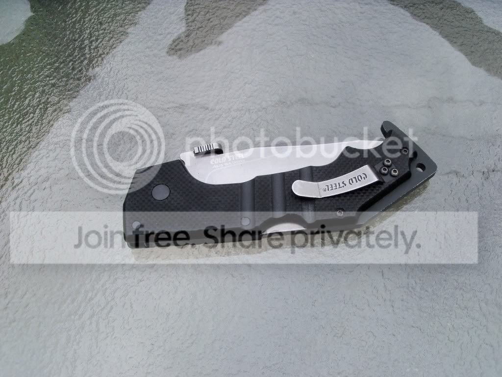

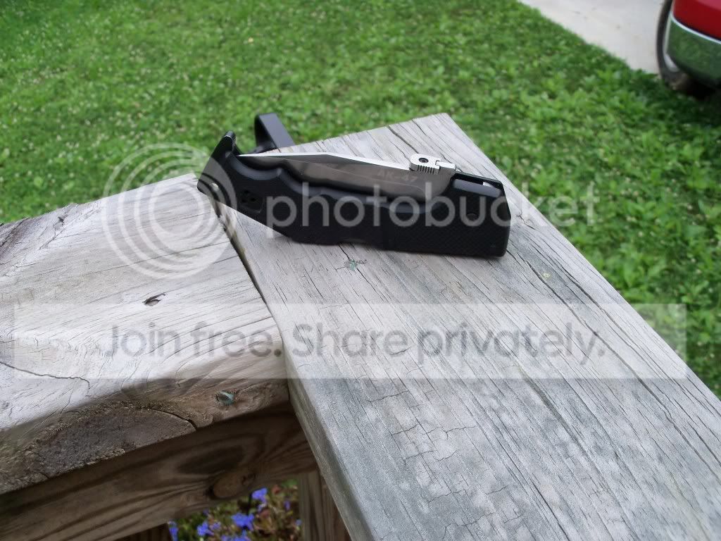

Have wanted to do this for a long time, glad I did cause I love the almost stone washed finish the blade has :thumbup: Will take some more pics later after my camera recharges.

I took a dull knife and gently scraped away the coating, it didn't harm or alter the underlying finish at all.

I used a $10 butterfly knife that I bought last week while on vacation in Myrtle Beach SC lol. I was bored one day so I bought it to flip and ended up scraping all the coating off my AK with it that night while watching tv, it only took me about an hour to do it:) The knife was pretty dull but it had a nice point that I used to work around the thumb plate and the handle. Honestly the coating comes off so easy you could use a nickle to scratch it away...just be careful:cool: My AK still has a decent working edge on it but if yours is new out of the box I would take extra care when working around the edge.

Thanks, no blade play so far though, I think it may be due to the fact that there is still coating on the blade underneath the scales where I didn't take the knife apart.
