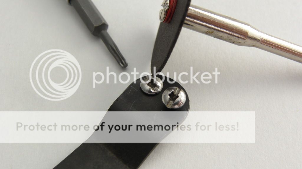

Hello, most of you will think..gosh what an idiot but in my defense it was a cheap metal so it stripped easily. On my Kershaw Chill the pocket clip screw stripped on me when I was changing the position of the clip. Anyone have any suggestions on what to do to fix this?

The screw that is stripped is a torx head screw size 6 like on most pocket clips. Also I mean fixing it by being able to unscrew it so that if I got replacement screws I could actually use the replacements.
Can you post a picture of it?
I've been able to get stripped screws out with vise grips, but the screws on the Chill have rounded heads, so there isn't much to grab. You're probably going to need a screw extractor.

Grab it with some needle nose pliers and just screw it out. Then contact Kershaw and get them to send you some new pocket clip screws.

That or put a drop of loctite in the screw, stick the torx in and wait for it to take a set, then you can unscrew it

^ Yup. It may scratch the clip a bit but the screw will come out if you do it right. (watch out that you don't pinch your palm with the pliers)

If you have access to a dremel here is the quick & easy way to get the screw moving
