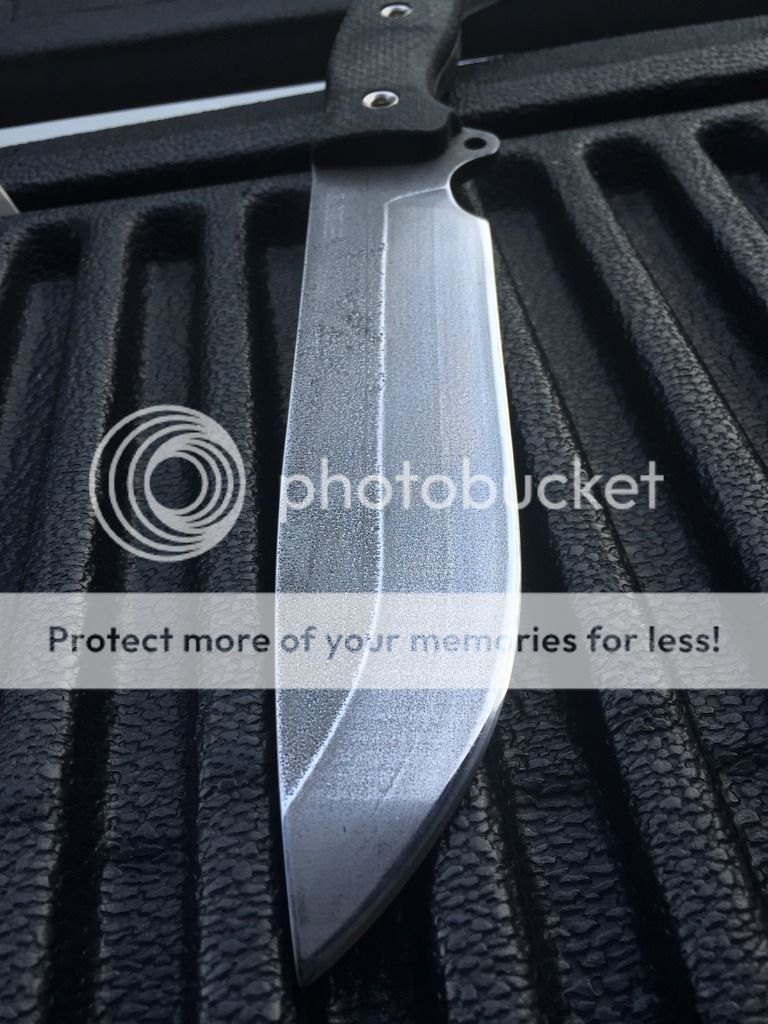

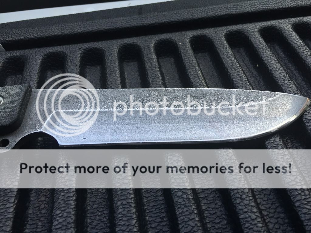

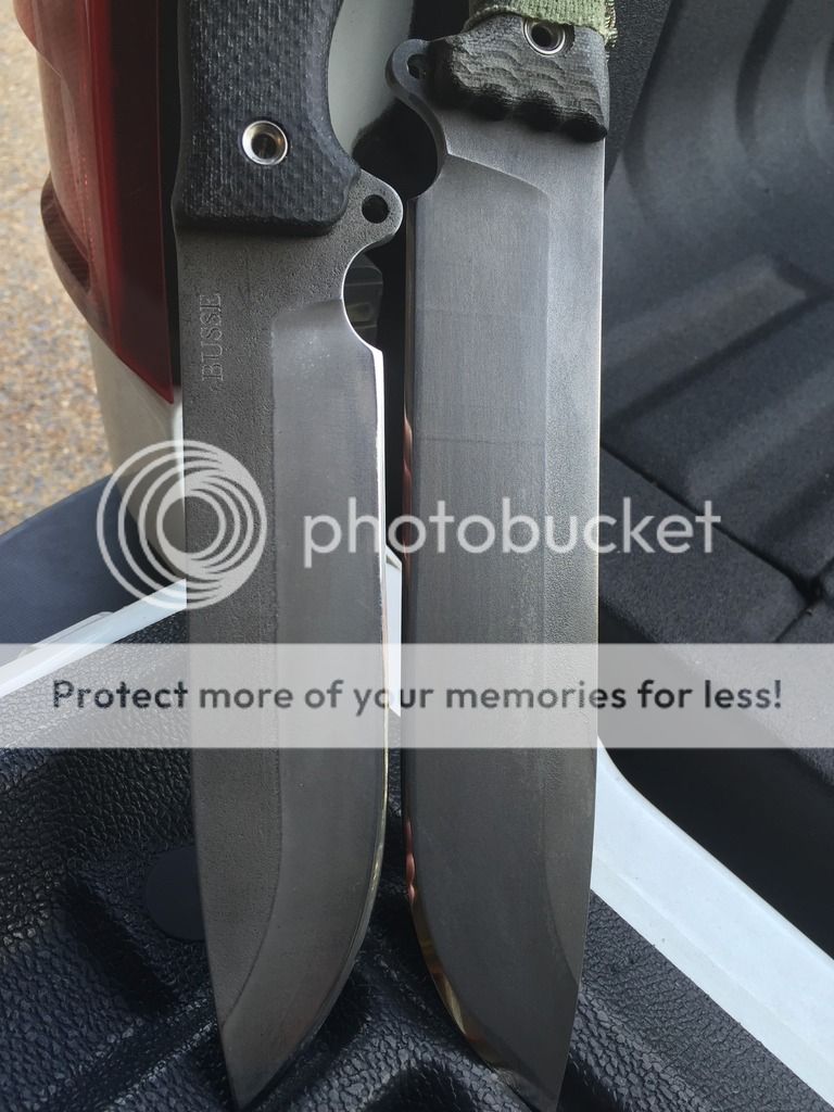

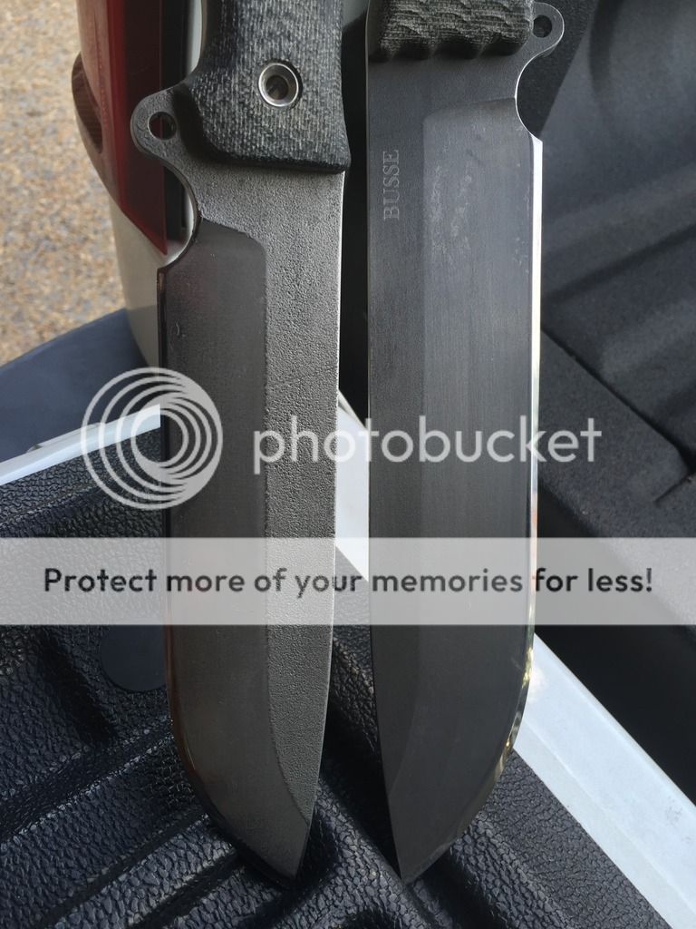

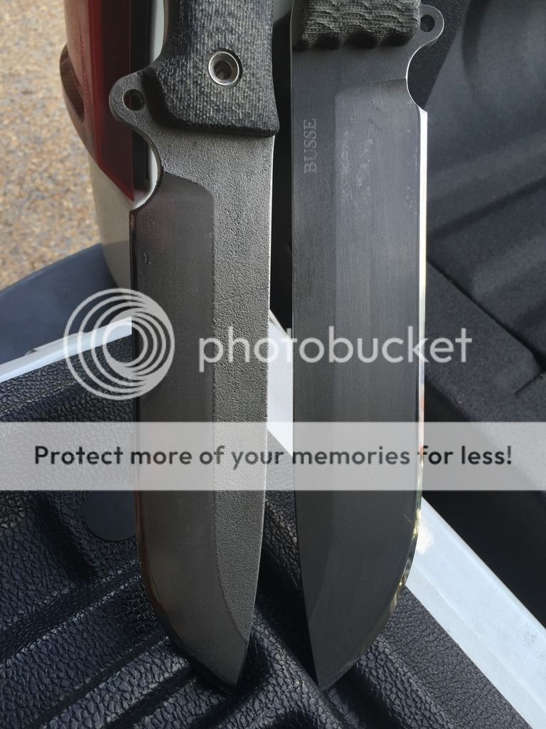

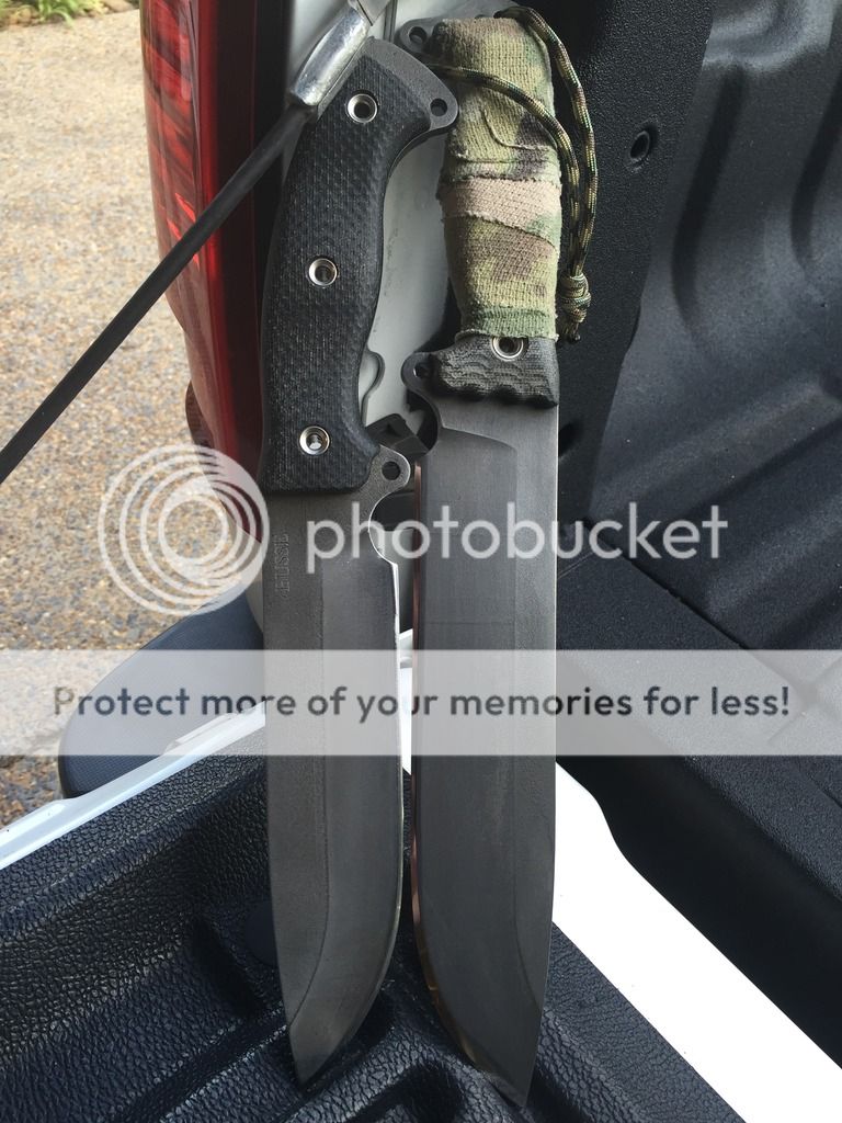

Here are pics of JFLemm's stripped SHe and ASH2.
Edges look great. The finish on the SHe is very noticeably rougher than the ASH2s.

I think it looks pretty normal for what I have seen on stripped INFI.
Not like the INFI under the coating of my TG-M.
Like the looks in this thread, not sure how that would stand against corrosion.
So INFI is some kind of cast or powdered metal, eh????

It doesn't look finished on the non-presentation side. And the half moon shaped ding near the choil on the same side must be a beauty mark. :rolleyes:
I know INFI is good, has proven itself time and again, and that's mostly what you're paying for, but releasing that as a finished knife is ridiculous.
Great pics! This one in particular really makes me want to get my hands on the new BME.
I don't think the dimples would bother me at all up to a point, especially since the blades are sold coated. I actually like the rugged look, but I imagine there's a size where I would start to question it. Probably about the point where they start showing up through the coating.
