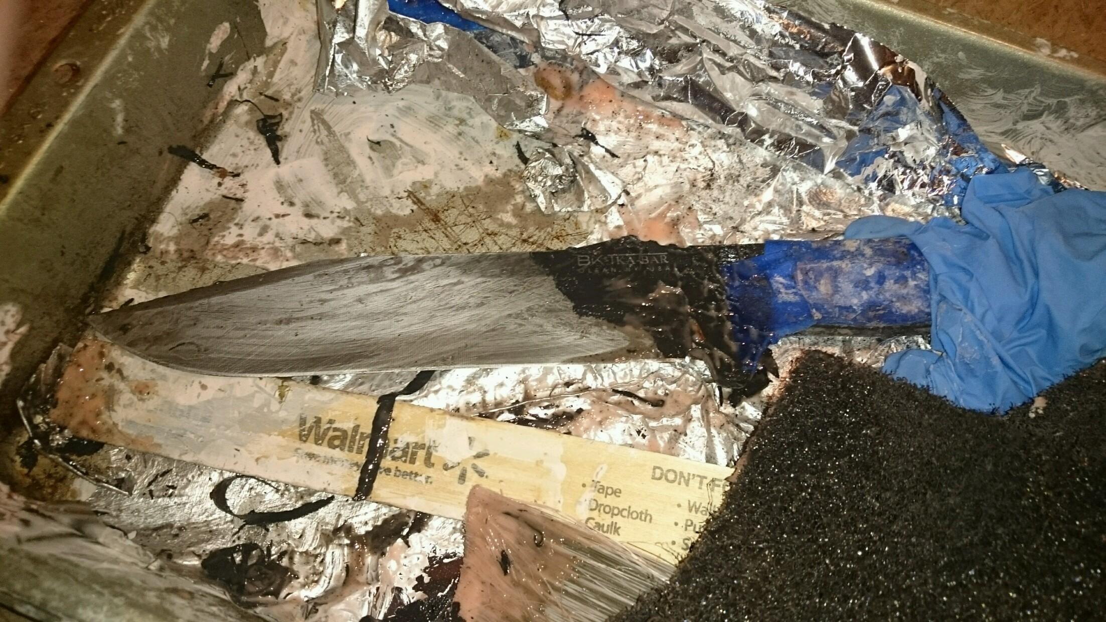

Scroll up and click on that link I posted before. All the answers are there. The wirey pad is your problem. The coating doesn't dissolve into paste. It loosens up. A plastic putty knife will tear that coating off no problem without you having to worry about scratching the blade.

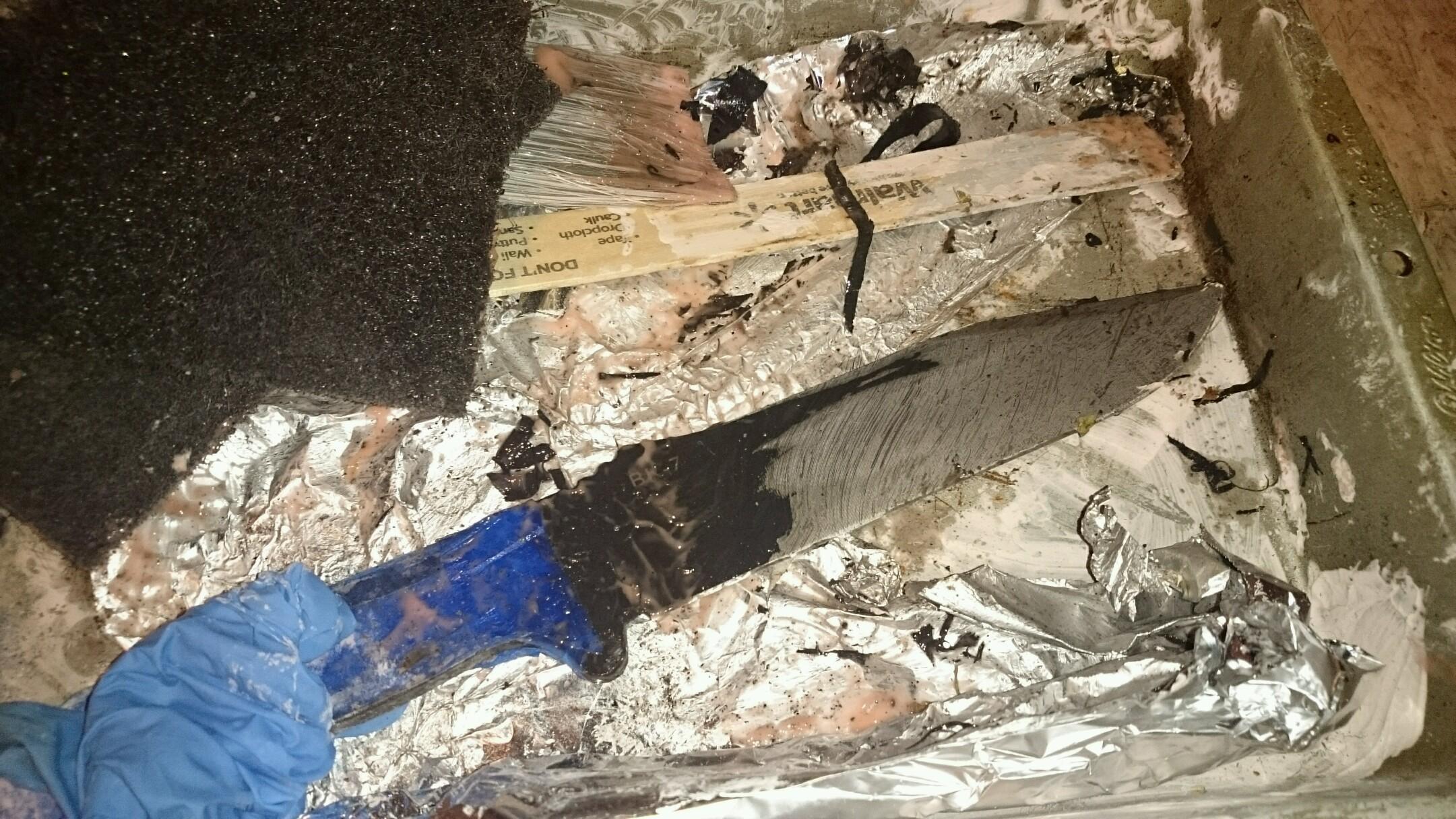

11 P.M. checked the 7. top side had little change, but underside with a little scrubbing seems to be coming off in sheets. Opposite of what I expected. With some elbow grease the top layer is stripping as well. Going to re apply one last time and check again in the am.

I thought the CitriStrip did nothing as well after sitting for 6 hours. Wouldn't scratch off so I figured it had no effect. Then tried a razor blade and it came off with ease.

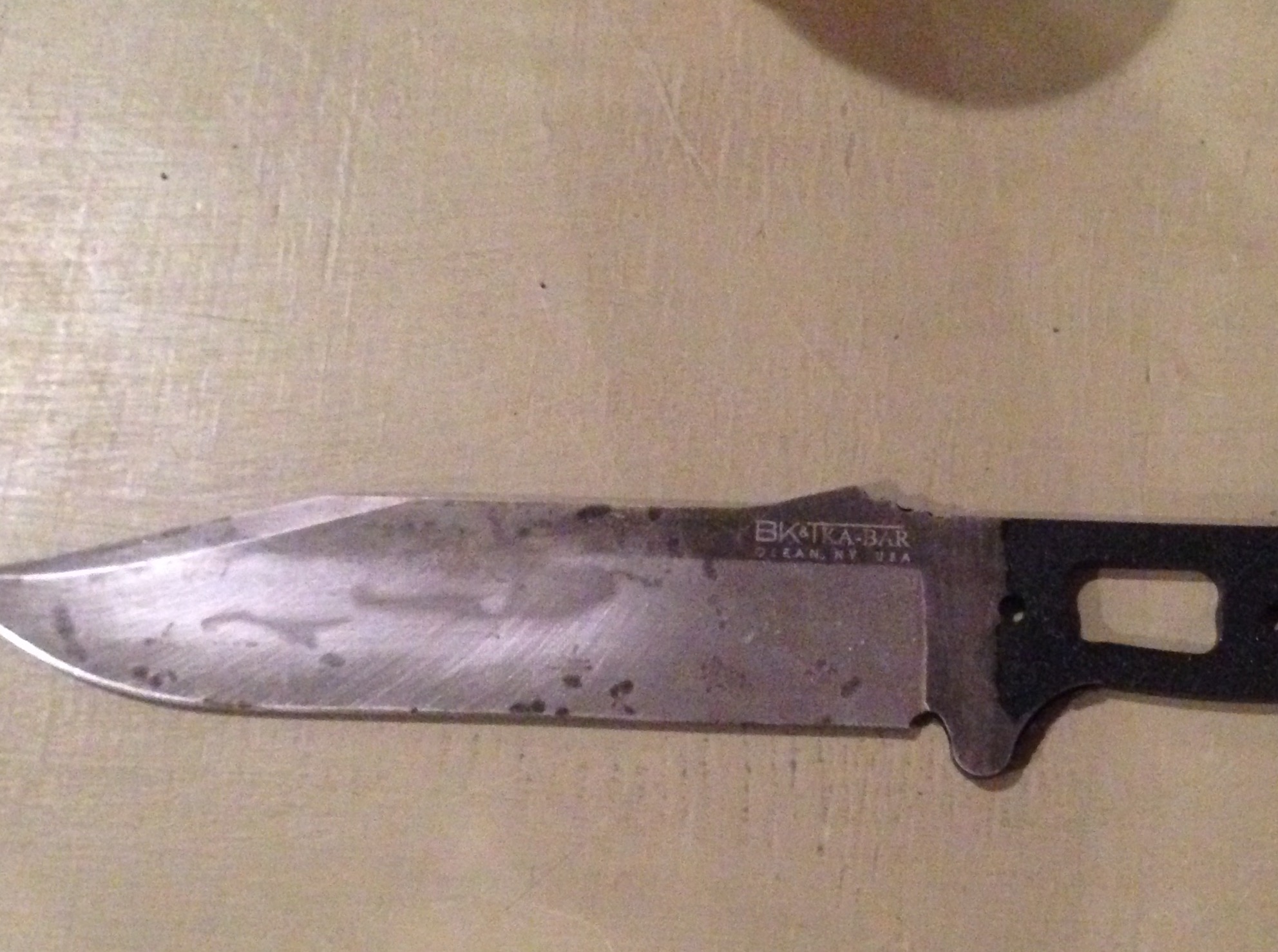

So yesterday I finished removing the epoxy. The plastic putty scraper helped a lot and in combination with the pad I had I got most of the coating removed. I still have a few tough spots that I couldn't get off...I have heard a razor blade works for that?

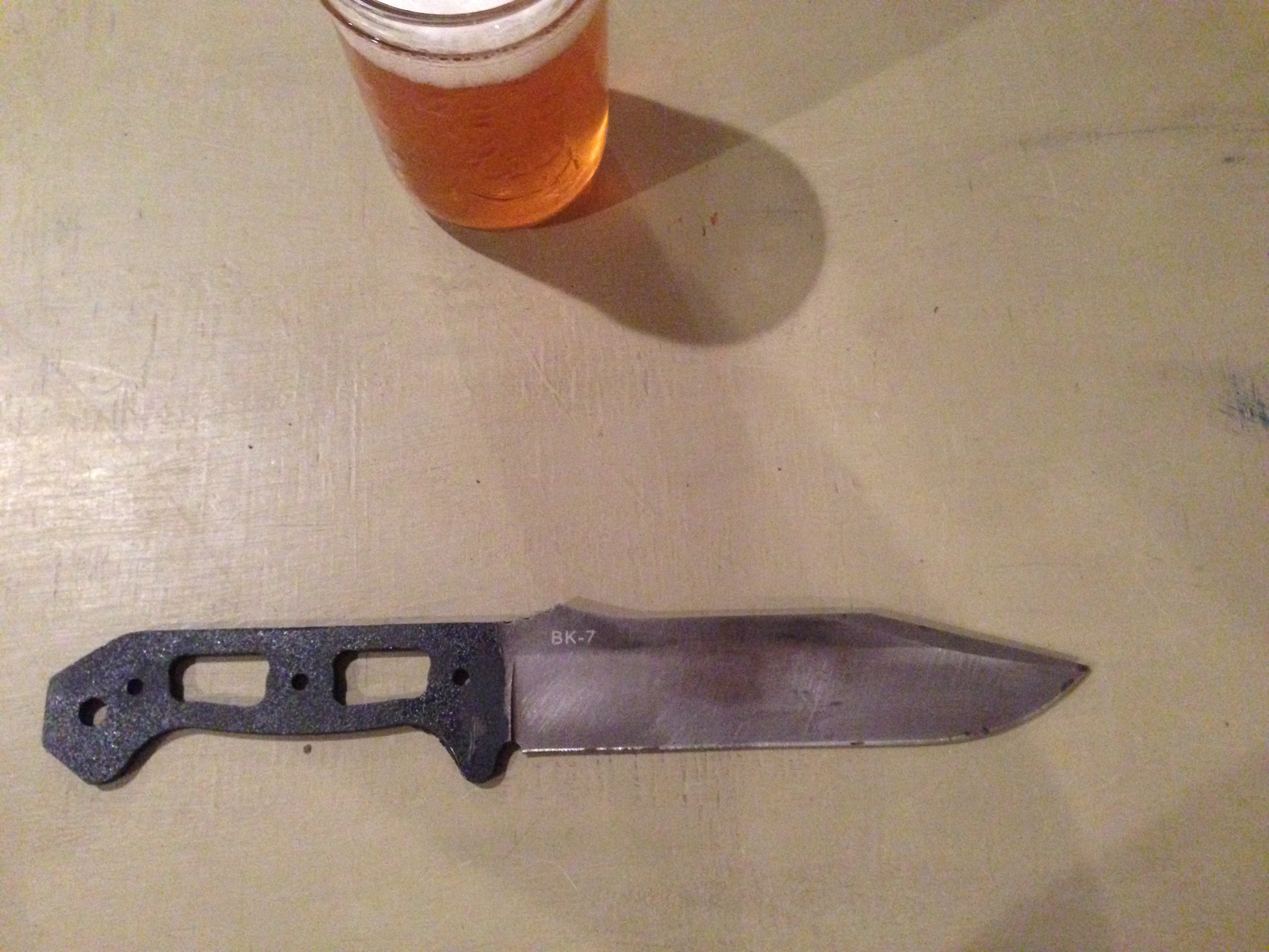

Now my main concern is the steel seems to be "stained" In certain areas from the citristrip. Can that be sanded away? If so do I use wet/dry sandpaper or just normal paper and what grit?
It is stained but that's called a patina and something that happens when the steel is exposed to acids from stuff like apples, strawberries, oranges, or in this case, CitriStrip.
You can remove the patina with sandpaper (use finer grit, like wet/dry 400-600) to even out the finish. You can keep working up in the grit fineness to the point of using polishing compounds like Flitz and make a mirror finish.

Did you etch the laser engraved logo? If you haven't already done that then unless it's a roll stamped BK7, it's going to be very faded or gone completely.

Had a busy day, just getting around to sanding but here are some pictures of what it looked like before, during, and after I used the stripper. Will post pics of finished product when I am done.
