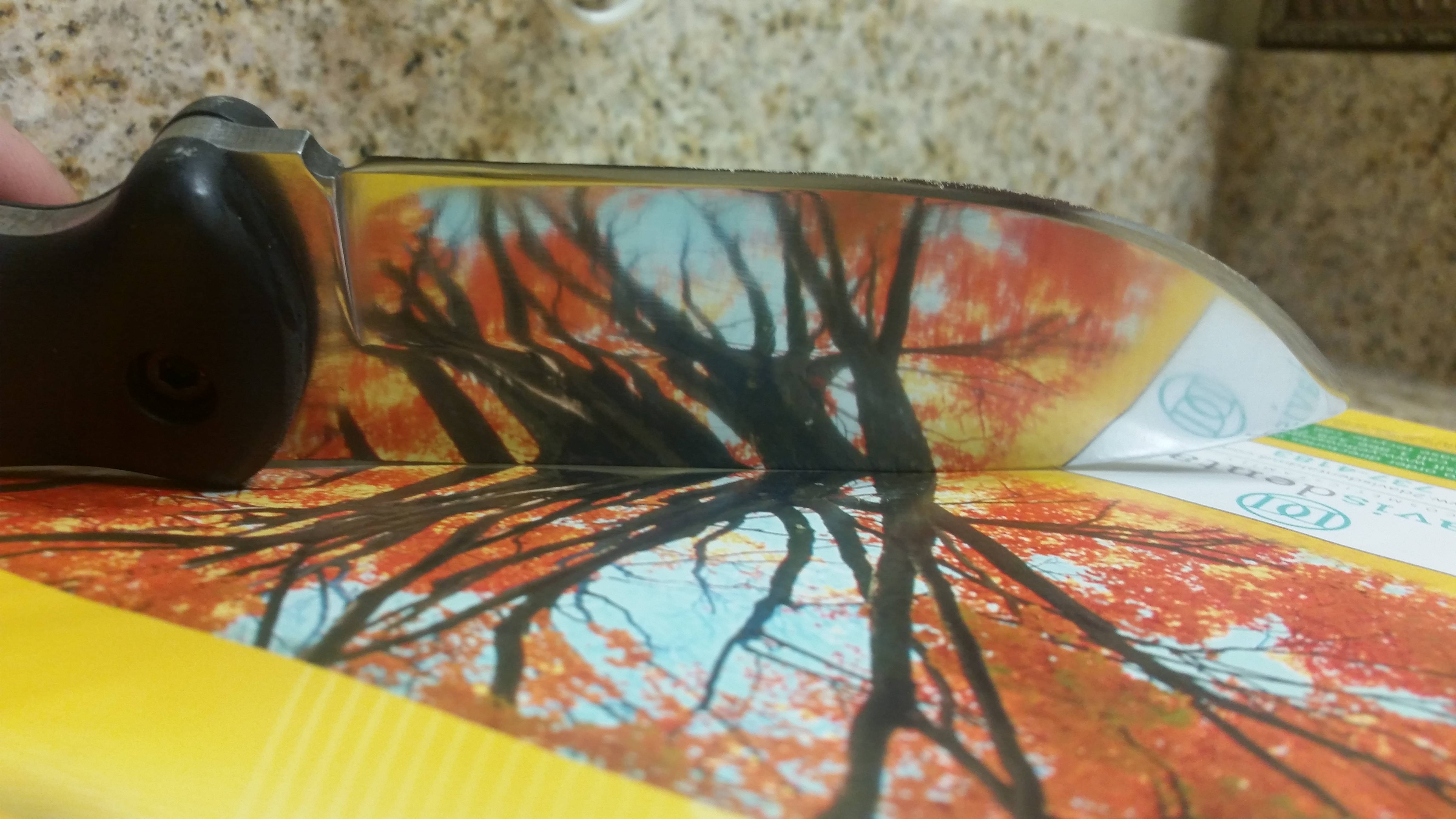

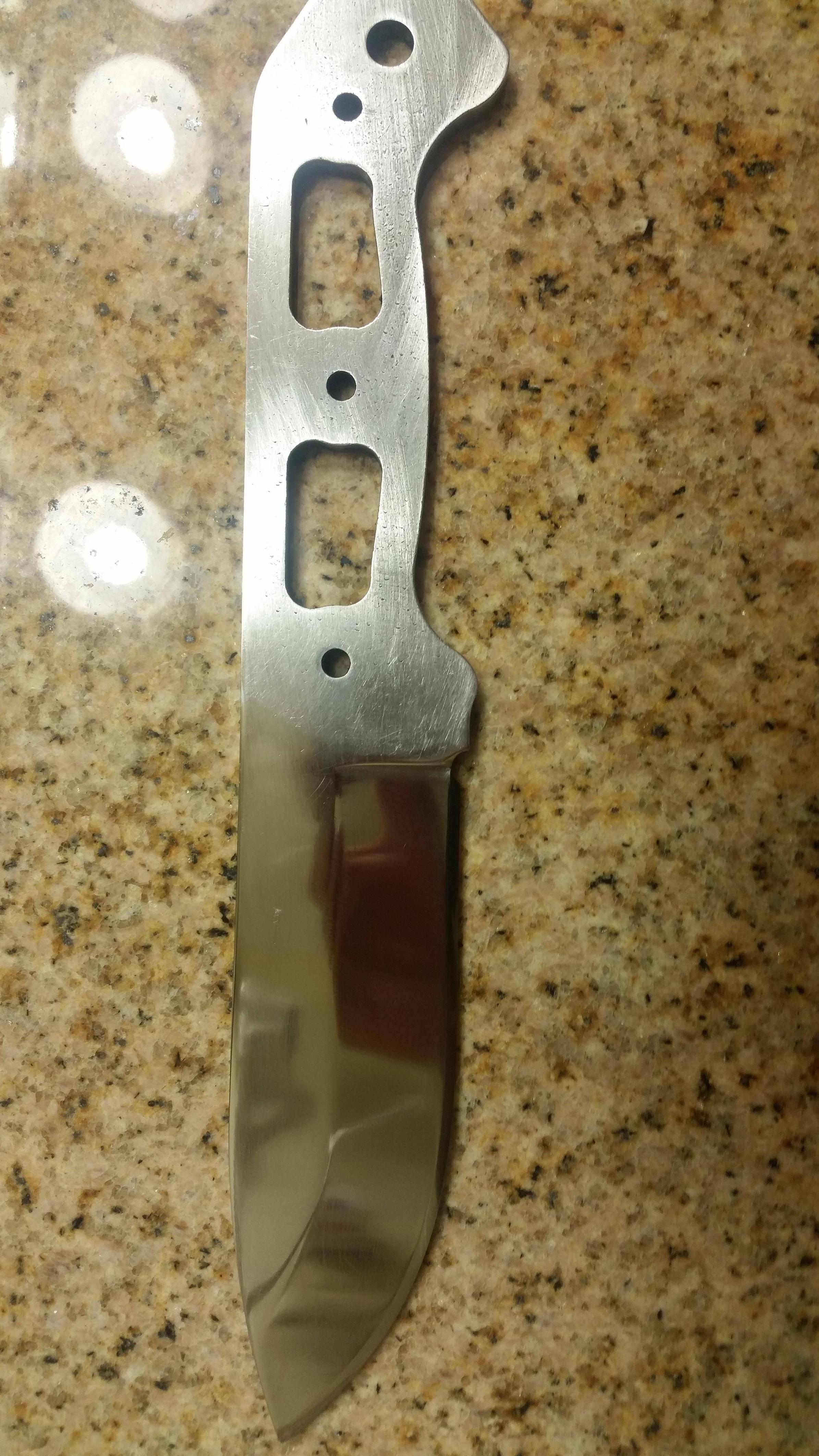

You, sir, inspired me. I would never do that if not for pictures of yours. I didn't think it was possible to do it in reasonable amount of time. You managed to do high polish in mere 10 hours, so I though if I do only half of that I'd be good to go. And it took 4 hours. Still some grind marks in some places, but good enough for me.
I didn't use sand paper at all. I have an old Lansky sharpening system which I don't use. Used those stones. Seems to be quicker that way.
Well I'm glad my random and sudden act of boredom inspired you lol. It was a fun protect thou just for the experience, however I think if I were to decide to tackle another Becker high polish I'm opting for reinforcements of the powered kind.

That looks awesome, could you go into detail regarding how exactly your sanding progressed? Grit, motion, time, equipment? also do i have to worry about messing up the grind at all while sanding?
I didn't use sand paper but Lansky sharpening stones, 70, 120, 280 and 600 grit and WD40.
No other tools. Held it in hand. Squirt of WD40 on the blade before sanding. Most was done with 70 lengthwise because I wanted to get rid of grind waviness. About 1 hour per side. Then about 5 minutes with 70 but perpendicular to the edge. About 5 minutes for 120, 280 and 600 each, also perpendicular.
In total about 2 1/2 hours for both sides of primary grind. About 45 minutes per side for swedge.
I don't think you can mess up the grind with sand paper. But you may the swedge. If you use sand paper for the swedge, use as hard of a sanding block as you can get. Otherwise the line between primary grind and swedge grind will be rounded. You want as fine line as possible.
So, about 4 hours in total, Lansky stones and WD40.

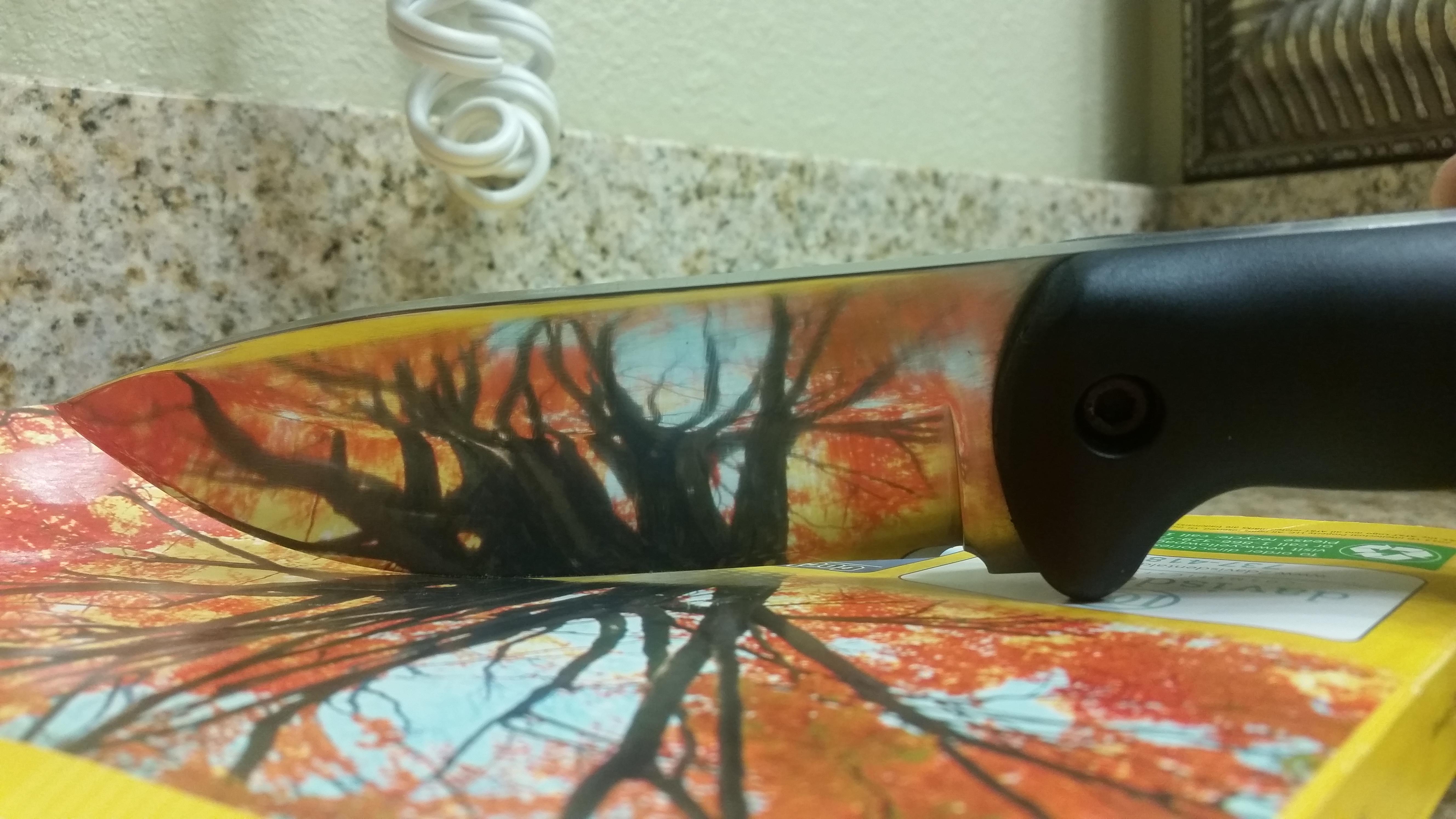

This is what I started with. If your knife has even deeper grind marks, it will take longer. If you want high quality results like those of Bobby3326 or TravisH, double the time (if not triple).
Good luck!
I didn't care about the transition between the 2 as I plan on going full height convex .. However I have found that by smoothing that transition out since it greatly improved it's slicing capabilities. Material doesn't get hung up on it anymore.
You can see the difference between stock and modified in this pic
