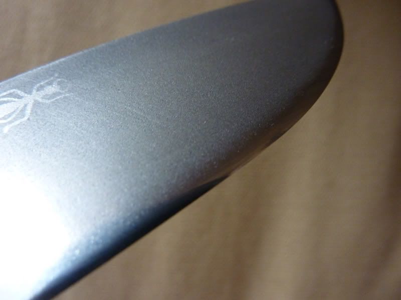

Is the patina that is left after removing the paint actually some kind of primer, and not the bare steel?
The reason I ask is I had some ... well, serious problems stripping the paint off my ESEE-4. I ended up having to use some sandpaper. When I did that, it uncovered some rather serious grind marks that didn't appear through the gray that I could see before I removed the rest of the paint with sandpaper. And I'm SURE I have bare steel now, because when I cut a steak with it, I got a NICE bluish patina where the raw deer blood touched it.

I understand what a real patina is. I've put them on various carbon knives of my own from O1 to M2 to 1095, using everything from mustard to potatoes to cold-blue. But the ... surface treatment? ... that I'm seeing on most here that are just chemically stripped doesn't look like any patina I've seen. Too regular. It DOES look like the undercoating of the paint on my ESEE-4, which certainly did not seem to be a patina. More like a primer coat. Because when I had to sand to get rid of the last part of the paint, whatever that gray underneath was disappeared, and now ... like I said... MAJOR grinding marks across the surface of the blade appeared. And NOT in the direction that I was sanding, since I was doing a uniform tang-to-tip sanding to get a uniform satin finish. These grind marks transect(?) the blade, and are curved and somewhat regular, like they are the left-over marks from the surface shaping grinder that was used for the flat-ground cross-section. They also are deeper than the trademark etching, because the etchings are GONE, and the grind marks are clearly still there.
So the reason I bring it up is I'm wondering if the grind marks I found are atypical, or are they usually there and are never seen because the "patina" under the paint is actually a primer undercoat.
Either way, I like my ESEE-4 better the way it is, even with the grind marks. BUT, before I try to strip any more, I want to know what is going on underneath the paint, if I can find out without infringing into anyone's proprietary processes or anything.

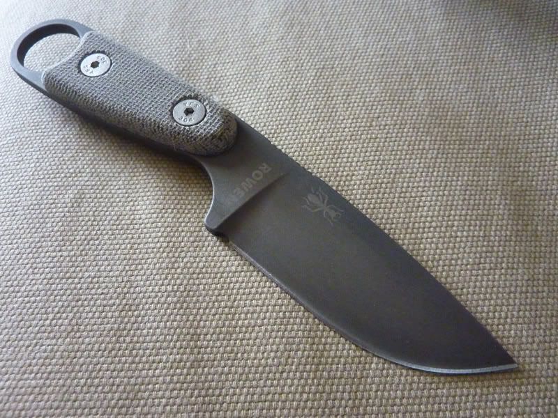

The final result:

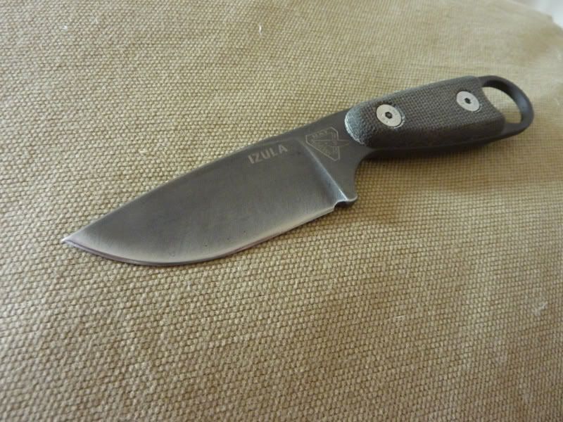

I stripped mine as well. Then I used some emory compound on the buffer to polish out the sand blased finish. That will just retain moisture. I then blued the knife with cold blue (as opposed to doing something like a vinegar patina).
Did the same thing on my RC-4. Used some emory paper on the blade to clean that up; the blade finish was a bit rough. Personally I don't like the epoxy "painted" finish.
I'm loving the new look, even more than my coated izula. Sometime when I can afford it, maybe I'll do the same. :thumbup:

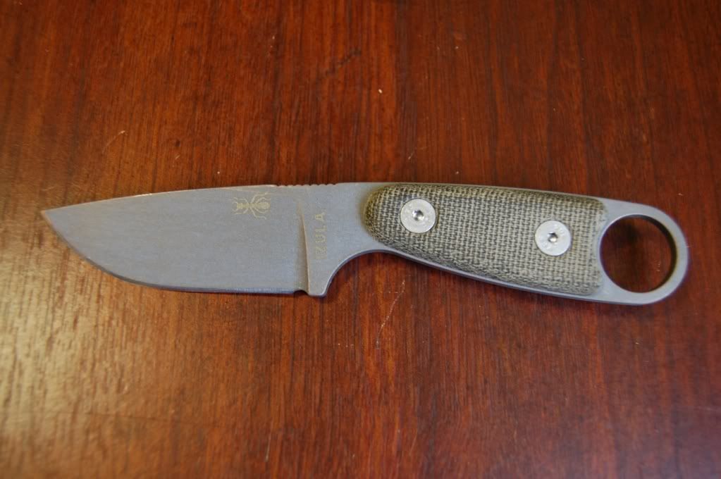

Just did this to mine:
rockspyder,
if I look very closely I can see the grind lines you refer to, so I'm thinking it is not atypical, but typical.
FYI I have noticed that with the powder coat removed, the knife rattles a little bit in the sheath. Not a big deal, just figured I'd throw it out there for anyone considering taking the plunge..
rockspyder,
Thanks eloreno.
BTW... NIIIIICE lookin' blade. :D :thumbup:

The gray "patina" is nothing more than a bead blasted finish. Bead blasting will hide grind marks that will be uncovered by any sanding.
