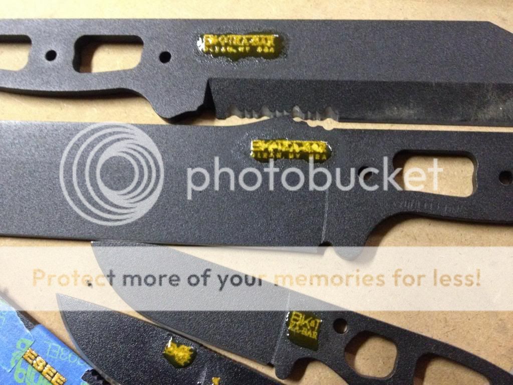

As you can see, the logos on all of these knives are not very deep, just breaks thru the coating and in some cases, maybe a little into the metal.
I am using some of the same PCB Etchant that I have used for the last couple of times. It seems to still have some kick to it. I do however add a little household Hydrogen Peroxide to it to get it activated. (I read somewhere to do this.) As you can see it bubbles up and slowly settles back down. Not sure if this is a necessary step or not but I do think it makes it work a little faster from my experiences.
One important step is to clean the area being etched with some type of soap or degreaser. I used household dishwashing soap and an old toothbrush. I have in the past used stronger stuff. It really just depends on how dirty or oily it is. If it is a brand new knife, you shouldn't have to do much. But if you have been using it then dirt and oils and blood and other stuff can get in there and stop the PCB from working properly. Also, If you oil your knives after use, then all that will need to be removed.
After I washed all the blades, I dried them and also now is the time to mask of any areas you do not want to be etched. I usually use fingernail polish for this but tried some tape this time. If the tape doesn't work, I will go back to the fingernail polish.
NOTE: You can take a stripped blade and use a paint or fingernail polish, or even a nice sticker or vinyl stencil cutout and make your own mask for your own logos or designs.
I didn't want full logos on some of the knives, that's why I taped them off. Hopefully when it's all said and done, I can light sand the blade and be left with only the part I etched. We will see in a few days.
Here they are with the Etchant applied. I did do the back sides as well as the top. NOTE: If you flip the blade over while etchant is on one side, make sure to flip sharp edge up so if any etchant drips down while rotating, it won't get on the exposed edge. It will eat the edge. If you are new to this, you may want to do one side at a time and also might want to coat the exposed blade with fingernail polish, tape, or even a heavy coating of vasaline should work. I have done that in the past but personally don't feel the need at this point. Just be warned, PCB is nasty stuff.
I used a q-tip to apply it. Make sure to rub it in the logo real good. I like to put a pile of it on top so as it eats thru, more fills in. If you don't put it evenly, some letters or markings will not be even. You can always fill those in later.
