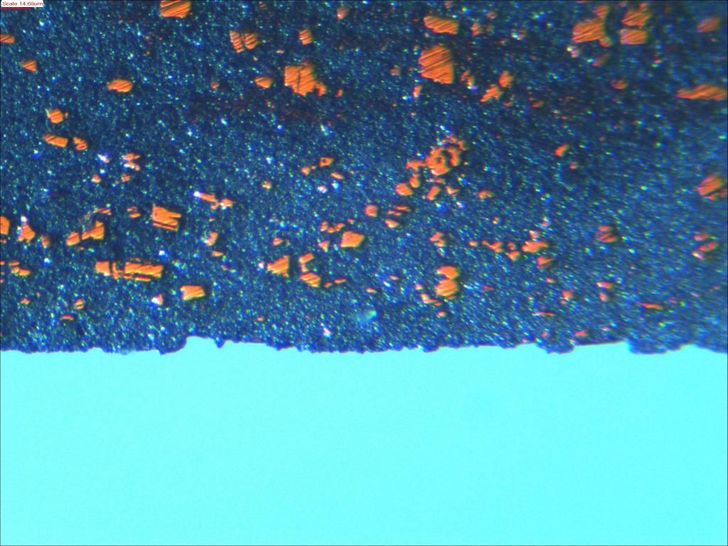

HSS with exposed carbides, abrasive used was a Suehiro 20k water stone (Aluminum Oxide abrasive).
And here is the same edge finished with DMT 8k then stropped on leather loaded with 0.25u CBN, 0.1u CBN and then .05u diamond.

Great pics!
In my experience if you had taken the edge right off the 20k waterstone and stropped that, the carbides would still be very visible after - some standing proud and some displaced. The work off the DMT EEF was the big fixer, and over time using the strops for maintenance I would expect to see the similar effect reappear.
The effect is most notable/visible (in my experience) on steels with large Chromium carbides. With the PM steels or steels with carbide sizes in the low single digit to submicron is not as apparent, though same factors in play. If some are falling out, they must have been exposed at some point prior to their anchor failing.
Will still perform well, but in my hands I find best longevity on these steels by not stropping at all or by keeping it to a minimum. What steel is that in your pics?
I observed the abrasive from an 8k Norton waterstone and 4k King both cut tracks across D2 carbides - carbide presence was not apparent off the stone, but also not a 20k stone... The same abrasives also cut across Va carbides, visible after etching but the cut was far more shallow (no pics) than what is visible on the D2 sample.

That could well be, and another reason maybe I just never see it is that I too always do a bare minimum of stropping, and don't really use it for maintenance on steels that form a lot of carbides.
The steel in the images is M2 HSS, I also have one I made from T8 HSS.
I will test the theory about going from the 20k to loaded strops if you guys would like to see it. Give me a few days.

I'd love to see it, I can only base what I'm seeing on my own experience and that's an aspect I certainly haven't investigated inside out. Any more you can add would be great.
This is an earlier thread that Josh posted up some pics illustrating what I'd been seeing - but have never really sidelit and micrographed. His pics also useful as he was stropping only with superabrasives. Am not sure what steel it was...

I've seen it with 440c, D2, 154cm. Not so much s30v and up, but I also feel I get a better edge not stropping those steels and assumed this effect had something to do with it. I also was able to reduce/eliminate this effect by using 3mil polyester and AlumOx grit (off the 8k Norton) over a Washboard surface, but it also left more pronounced scratch pattern than the stone itself.

Interesting. I've seen the same effect as I've shown on the Suehiro 20k when using brand new AlOx lapping films from 9u up to 1u in progression (9u to 5u to 3u to 1u). I will try to get that 20K to strop test done in the next day or two.
