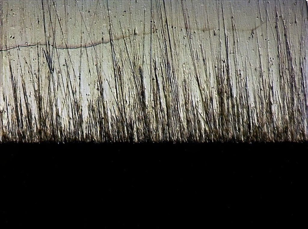

Interesting. I've seen the same effect as I've shown on the Suehiro 20k when using brand new AlOx lapping films from 9u up to 1u in progression (9u to 5u to 3u to 1u). I will try to get that 20K to strop test done in the next day or two.
Hmm, I might have to dust off the old microscope too...Can you recall a point where the Suehiro stones by grit value, can be seen leaving carbides proud of the stone and prior to that they are either cut clean/excavated or lost in the overall noise of the scratch pattern?
Speaking just of the larger carbides (D2 excavation can be seen with a 10-12x loupe and almost the naked eye), I cannot recall seeing this effect off a waterstone or other hard stone, but again at 8k and down. Makes sense that at very small abrasive sizes it would become more prevalent and something you've already proven possible.

Okay, got this mostly done, I want to do a little more with the loaded strop, may add more later on. This is M2 HSS, and on each subsequent stone I changed from a straight stroke to an angled stroke so as to be able to see any scratches from the previous stone.
What I see is that after 8k the carbides are not being cut and remain seated in the steel matrix, but prominently exposed. Prior to that, I am not convinced they're being cut much either - I think they're being torn out.
The water stones don't do much of any cutting at all if the dull particles don't tear loose - which is why the Shapton 1k doesn't look like it did a whole lot. The problem I see is that once the dull particles tear loose, they create a slurry, which I'm pretty sure is just tearing those carbides right out. For all of these I used a very light touch so as not to influence tear-out of the carbides by being too aggressive with pressure.
The diamond on leather seems to have rounded the carbides, and I'm thinking more work on the strop might be able to bring them closer to the steel matrix. I'll update with another shot after some more work on the strop.

Thanks! I am pretty sure SiC would do better, as it is harder than AlOx, but how much better is anyone's guess. I can test that too though - I've got a very fine Carborundum SiC barber hone that should test it nicely.
First I'm going to go back to the strop with a bit coarser diamond compound - I've got some 5 micron also, I'll try hitting the present edge on that for a bit then going back to 1 micron and see what we've got. After that I'll take it to the SiC stone and see what that accomplishes.
OK, pretty much satisfied now that the carbides are being cut by the diamond loaded leather strop at about the same rate as the surrounding steel, but it seems that since this occurs in such a fashion there's no way that a soft substrate will bring the carbides back flush with the steel matrix if they are sticking out when stropping commences. I think that if the stropping follows a diamond stone that there needn't be any worries about the carbides being dug out during loaded stropping unless a very aggressive abrasive particle size is used.
