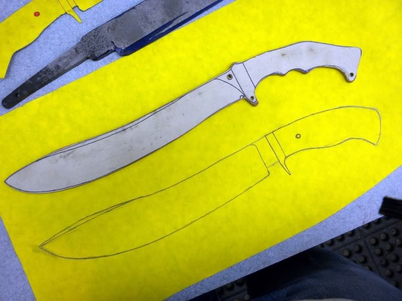

He had sent me a pattern he liked, I drew a sketch of it looking more like my work, and he volleyed some changes he liked. This has all been a healthy exchange.
Now I replied to his thoughts of changes and know how I FEEL about what I said, but am curious how some of you would feel about it if you got something like this from a maker who's list you are on, or even if this just came up in conversation at a show, or whatever :)

I'm open to changes/alterations on the design... the hang-up being that it's gotta look like a Wheeler knife.

I actually prefer a dropped edge from a functional and aesthetic standpoint (not to mention it's a natural occurrence from forging close to shape as I do). I like how it places the edge, the geometry it creates with the handle width, I think it's easier to sharpen, and looks cool.
Am I not even willing to think about doing it without a dropped edge? No... lol
The handle changes are just fine, I actually got the pinky/ring finger recess a bit fat on the drawing anyway, so the deeper contour is more better anyway. I'm not real experienced in the raised area on top of the handle, but am pretty sure I can deal with it (I almost said "I can handle it" but realized that would be the most ridiculous pun of the week! ;) ).
So after all that blabbering, my point is I'm thinking about what you changed and thinking about how I can make it what you and I both want.

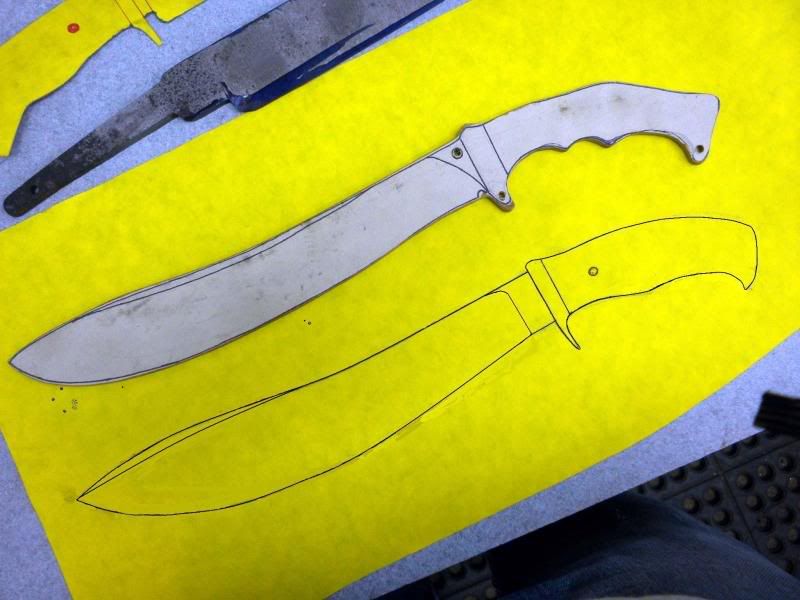

here they are;
The first is Nick's original design, interpreted from my plywood design;
And here are the changes I made to it;

I agree with Don. I also think Nicks handle is more well rounded and if you get sick of your odd shape sometime or change your mind, Nicks is more universal.

Lorien, thanks for posting those pics, but where did you get them??? ;)

the following is a bit off topic, but as we have pictures now...
lorien, i know that you have a thick skin and like your designs being discussed. so here i go...
my advice is to follow nicks first sketch. that design works. there's a set of tasks i think this design is perfect for. and it's got flow.
maybe you have good reasons to suggest some major changes, but (i am talking about your second design): handle butt is limp, not enough flare. the "beck" may help to have a secure grip, but it looks, well, limp.
the bump on the upper side of the guard interrupts the line from the handle to the spine. this seems to be some kind of a camp knife, not a fighting knife, so there's no need for this reduced double guard.
like don said: handle drop kills the flow
why no choil? you won't need this knife for cleaning deer. without choil the blade is too narrow at the ricasso. but as you like the blade as wide near the tip as nick suggests, you need a more pronounced curve of the edge from ricasso to tip. that produces a second flow killer in the middle of the blade. looks a bit like a reversed kukri.
to avoid unnecessary e-mail traffic, misunderstandings and trouble i like to keep it simple, about this: "hi nick, blah blah etc., a camp knife used for chopping and different chores around the camp site, blade 10" with a raised swedge, might look a bit fikesish, walnut or DI handle. i prefer simple carbon steels like 1095, w2 or O1, hardening line must not be visible."
i am pretty sure such a knife would look very similar to the one nick designed, and heck, i'd be SO happy with it!
i hope i wasn't too rude. by the way i like your enthusiastic posts very much!
best regards,
hans

Lorien's handle design is weird.... Lorien's handle design works. I have a golok he modified the handle to a similar shape. Looks weird, kinda feels weird until you start chopping.
