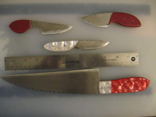

All of my first knives were profiled with a Dremel tool- about 20 blanks. Most were contoured and buffed with the dremel as well. It can be done, it teaches a lot about patience, and is acceptable if you already have a Dremel. It is by far not ideal, and a drill press is needed, but if all you are looking for is some way to constructively kill some time go ahead. I spent 6 hours total drilling out the profile of an integral hatchet out of 1/4" O1, a big waste of time but it can be done and at least now I have the blank ready. A few essentials in my mind: Drill Press, Vice, High tension hacksaw, Dremel, files. Stocking up the Dremel can be pricy- watch for sales! I've found that for my uses the cheapest cutoff disks were the best value. Face shield and goggles, dust mask and I don't worry about the discs shattering- they will, might sting a bit, then you replace it and move on. Many of the designs I tried first would not fit well into a 2" piece of steel so I bought 6X36" slabs. Due to this I wanted to save as much material as I could so the Dremel was able to get into tight curves so I could put as many designs in there as I could. Much less metal waste than I have had with the drill and hacksaw method, and gives a much nicer finish to the cut ends.
These were all primarily done with a Dremel tool and 4X36" Sander to bevel/blade finish other than hand tools. They won't compete for ABS awards, but they were fun to finish while recovering from broken legs, and they started the fire for the future- if I was willing to put in the time with crappy tools and still have fun I am willing to do so my whole life if need be. Plus they all cut!
