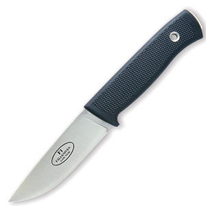

The Fallkniven F1 fits all of your criteria, except that it has stainless steel instead of tool steel (their laminated VG-10 blades are still probably tougher than Bark River's A2 blades, though), and it has a modern polymer handle instead of a classic material.
If you want a more classic-looking version of the F1, though, Fallkniven also makes the NL5, which is essentially an F1 with a stacked leather handle.
Fallkniven F1:
