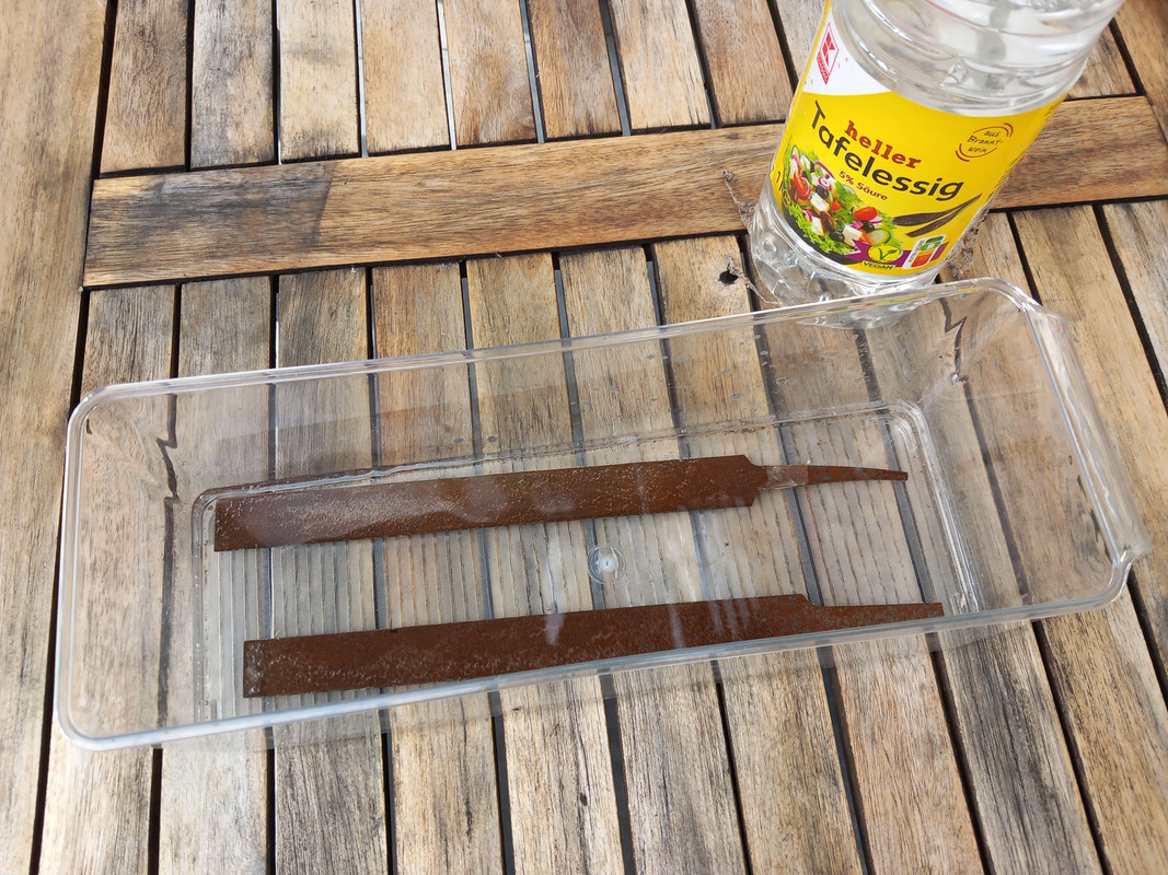

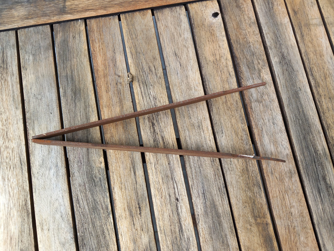

I'm not promising anything but I did have some nice thin old files laying around that I got from a thrift store, years ago.
They are just a bit under 1/8" thick and just a bit over 3/4" wide.
I'm letting them soak in vinegar over night to clean the rust off.
I'm not set up to do HT so I'll see how the anneal at 200C and work hardened goes.
A friction folder? A small scandi? Let's see what the vinegar does first.
Those would make nice paring/bird and trout type knives or a Puukko!
