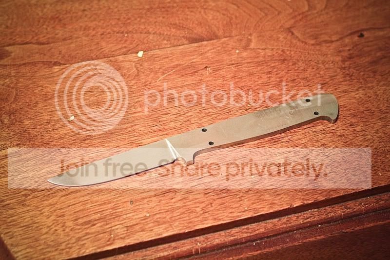

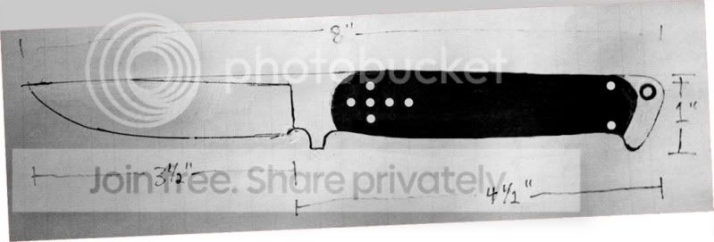

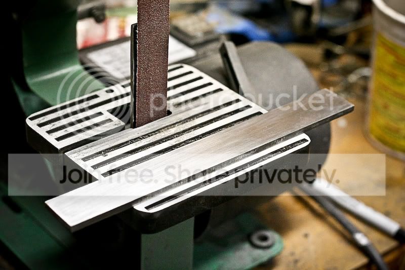

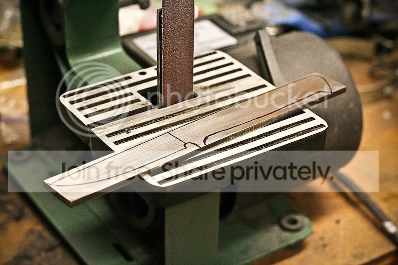

Well after figuring out a few thing I think I am ready to start my first "finished" knife. Up to this point I have made 5 different knives, each with the purpose of learning something new and adding it. This will (hopefully) be the culmination of what I've learned so far. Hopefully Dad will like his fathers day gift.
I want to get to heat treating today so keep an eye out and I'll add pictures throughout the day as I progress.
1080, SS pins, Black/Orange Micarta

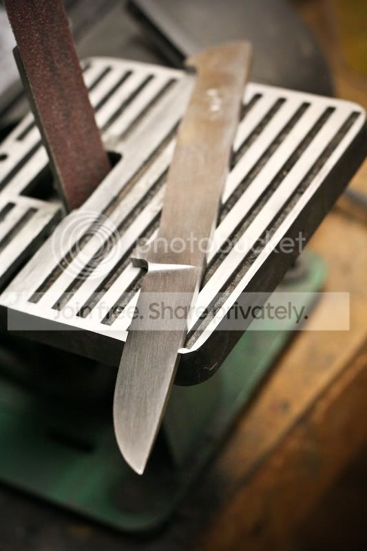

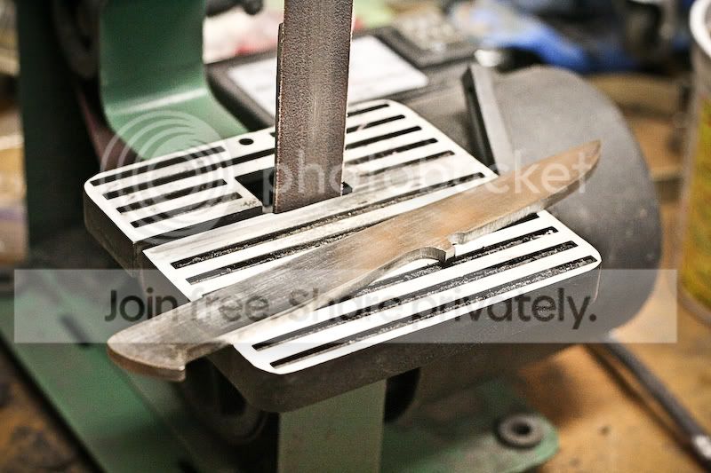

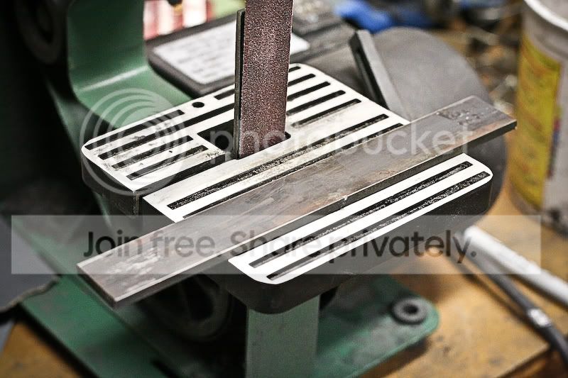

Finished the plunges. I decided to go all the way to the top. I have to break out the sandpaper now and clean things up a bit, then drill my holes in the tang, then I should be ready for HT
SYVMN ---- If you put a decent sized bolster on that knife, I'll engrave it free as it's gift for your father. If interested, call me at 910-221-5288. ken
Hey Ken. Honestly I'm not really sure what you mean by bolster. I think that means pieces of additional metal in front and back of the scales. If that is what you mean then I don't think I have the skill and know how to put them on, nor the material. I was planning on just using micarta for a handle and leave it at that with the rear portion of the knife just the tang. I wish I had someway to take you up on your offer.

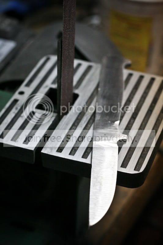

I went at the blade and just a bit of the tang that will be exposed with 150 grit sandpaper. Do you think this is enough before heat treatment or should i polish it up a bit more?

Looking good. I'm sure your father will be very pleased. As for your last question, I'd take it up to at least 220 grit before HT. If you plan on going for a higher finish, it's A LOT easier to get the scratches out before it is hardened so keep that in mind.
I sanded the blade up to 350 grit and the front part of the handle up to 150 grit. I figure I will mess with the back part of the handle once heat treatment is done. This part shouldn't harden so I can do it after. Went to Menard's to get some good 1/8" drill bits and forgot to get a bigger one for the whole at the end of the tang. I'll do that tomorrow maybe. Once I heat treat I think I will call it a night. Hopefully I will finish it up tomorrow.

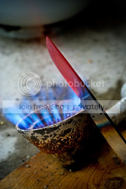

The plan is heat to non-magnetic and then quench in 150F canola oil. Then give it 2 hours at 400F in the toaster oven. Sadly I can only do one cycle, maybe I'll do another one tomorrow.

Sadly HT isn't going to work tonight. I ended up running out of propane. So, I guess I'll have to get some propane on my way home from work tomorrow and do the heat treat then.

Its in the oven tempering now.
It's going to be a great knife for sure, nice work for now... Only one suggestion: I would do it spine down / edge-up, as far as I can see the portion of the edge near the plunge is over heating..
