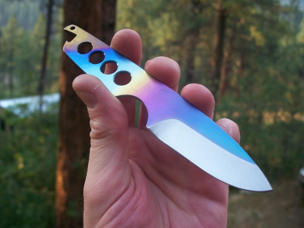

Quick Pic! Carbidized Anodized Titanium! I finished 3 of these today.
Lol, I shoulda waited about 10 secs. more before posting :) That sir is absolutely bee-you-tee-ful! Bet that thing slices like a boss.
We posted at the same time, perfect timing! :D
Thanks, it is a great slicer! I love this hollow grind, it is deep near the ricasso for great slicing and transitions to a shallower near flat grind towards the tip for strength. :D It's a secret how I did it!
Secret my a$$ :p I bet you just moved the knife up the wheel towards the slack as you ground towards the tip. Amiright?
Something like that. :p :D

They are about 6" long with roughly 2.5" of blade and a bottle opener end, I'm guessing 3/4 Ounce for weight. You can carry one without worrying about weight or rust!
