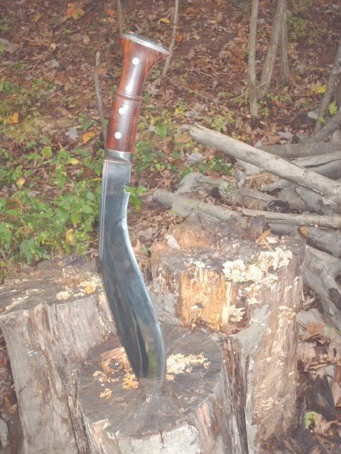

I had been lusting over this incredible khukuri for a long time and recently the possessor of this fine piece of Nepalese steel offered it to me for a trade.
Super CAK (the prototype for the H.I. Bonecutters) by Sgt Khadka.
Overall length - 20.25" (51.5cm)
Blade length - 14.25" (a hair over 36cm)
Weight - 34.45 oz
First off all I can say is wow. Wow. This thing is awesome.
I slowly convexed the edge to a scary level. I was able to cut through a maple branch the diameter of my wrist in one effortless strike. My other AK can do this too, but with nowhere near the ease the Super CAK was able to do it. I don't think I have anything in my collection that cuts like this. It's kinda freaky in a way.
I was told it feels more like a sword than a wood chopper. I must concur. It's a weapon. It cuts like an Ang Khola but it feels more like a Sirupati. One of the weird things about it is how when I pick it up, it seems to feel like it's actually 23" long but oddly lightweight at the same time. It has a very aggressive attitude to it.
This is my first Sgt Khadka blade and I'm very impressed. The man is a rare talent. The edge bevels are flawlessly even and symmetrical and the handle is very comfortable. The ring on the handle doesn't feel at all sharp. The pommel and bolster are STEEL and very well done. It's more of a traditional bolster! than the standard H.I. habakified ones and I really like that.
The only thing I could find if I nitpick is two of the aluminum pins are a tiny bit loose. Regardless of this, the handle is tight and solid. I'd also have to say I wouldn't really consider it an Ang Khola variant as it's more of a Dui Chirra Bhojpur kinda thing. Sort of. How do I find terminology and comparisons to something which is truly one of a kind?
Look at those beautiful fullers!
I think I may have found the ultimate khukuri. In all seriousness. This is my top pick for the collapse of civilization, zombie apocalypse, or fighting off and surviving, well, just about anything. It's big but it's fast, it's a power chopper but it's agile, it has plenty of reach but it's amazingly lightweight for its size.
It's perfection, IMO.
I've said it before and I'll say it again: I'd love to see this model become a standard khukuri in H.I.'s inventory. Maybe we could re-name it the WW3 model?
:thumbup::thumbup::thumbup::thumbup:
(Special thanks!!! to the forumite who offered this amazing khukuri to me!)

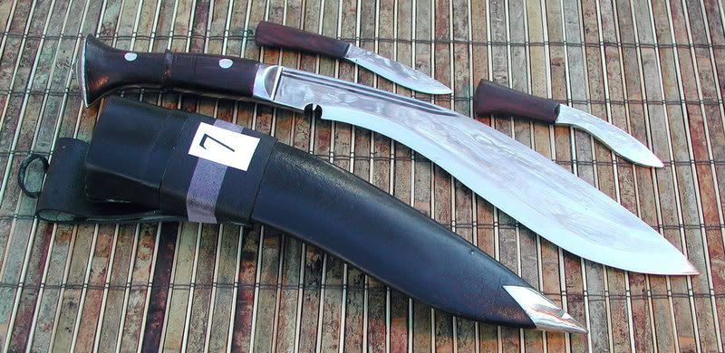

By the way, this is my favourite Khuk, also by Sgt Khadka, it is 18.25inches oal and weights 31ounces and the grip fits is as if it was made especially for me.
I know what you mean when trying to explain what model/style it is ...I call it a Chiruwa Dui Chira. :o

I went out in the woods a bit today with Mr Smiley
I did some more test cutting with the Super CAK today, putting it up exclusively with my 20" Ang Khola by kami Kumar.
There's really no comparison. The Super CAK wins.
My standard AK is a bit different from my other khukuris as Kumar made the edge bevels very thin, almost like the edge on a razor. They are almost perfectly flat; not convex at all, and maybe even very slightly concave. Regardless of this, the edge has proven to be remarkably strong for years now. It bites deep. Really deep. This was the khukuri I was using last year to de-limb fallen trees after a windstorm and I was leaving my father and his chainsaw in the dust behind me.
The Super CAK on the other hand has those Bonecutter edge bevels. They're very convex but not too obtuse; the profile is very similar to what you'd find on a japanese "appleseed" blade profile. Just right. That being said, it cuts differently from any other khukuri I have. It cuts like a broadsword. A very sharp broadsword. It combines a razor sharp shearing cut with brute force percussion. The result is ferocious. It also has deep double fullers (which is why I consider it more of a dui chirra variant than an ang khola) to make it both remarkably light and well balanced yet very strong. The Super CAK recovers quickly and is instantly ready to strike again. The standard AK handles more like, well, a short broadaxe, which is fine because that's how I use it.
I have a scale I use to evaluate a khukuri on it's role as weapon vs tool. 1 being purely weapon and 5 being purely tool.
I consider khukuris like the chitlangi and the M43 to be dead center at 3 (M43 IMO is more accurately a 3.5) as they are compromises between weapon and tool.
I have to consider the Super CAK a 1 and 5 at the same time without being a compromise regarding either role.
Now I think I'll have to rethink my scale, all because of one khukuri :confused:
