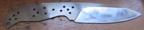

I did a quick polished & etched on the spine of a SQ knife shown in recent video. Here are some grain shots
Broken surface from the failed experimental harmon knife

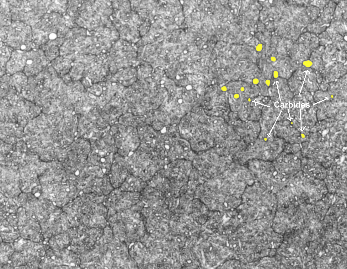

Edit: Jason, thanks for etched pics of Bravo knife. Those pattern look like D2 carbide orange-peel?? I could be mistaken but many grain pics show grain size mostly homogeneous and usually much smaller than 10um. If that blade with grain that big (20-100um), it probably will break like glass.

Here is a 1000x mag pic of A2 grain & carbide. Those CrC carbide size are around 25 to 200nm. Infer grain size around 2-5um.
Jason, your images show grain in the hundreds microns. Visible boundary lines look like, elements segregation bands - to me.

Grain of steel similar to 80CRV2 composition. Here is the martensite matrix pic. grain looks quite coarse in 10-15um.
What you are seeing in the BRKT blades is not the grains of the steel, unless the heat treatment was just eff'd. If those were the actual grains, they'd be somewhere between a grains size of 3 and -1, and you should send that knife back. You may be seeing the mechanical fibering of the steel from rolling, which is sometimes visible with a good polish and FeCl etch, and is often referred to as "grain". For reasons of clarity I prefer mechanical fibering to describe that. I've not seen any reference to FeCl as a grain boundary etchant, even with magnification. The usual etchant for things like bluntcut's picture above is nital. Estimating grain size from a picture with no scale on it is risky. Do you know the treatment for that piece of A2 BC?
Unless they're doing something unusual to their A2, it would be rare for any grains to be that small (2-5 um). A2's usual range is more around 15-25 um. They could well be doing something very unusual though, like salt austenizing, induction hardening, multiple quenches, etc. Hardenability might become an issue on an air hardening steel with grains that small, though for thicknesses like chisels it might not.
